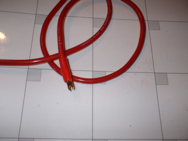

I use personally 8Ga 665 strand on my base drivers and 12Ga on all others for interior wiring....its overkill but I dont like the connectors for the smaller guage wires
