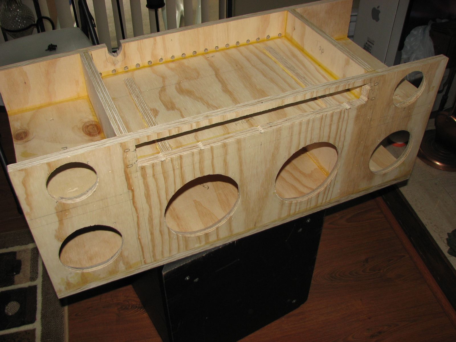

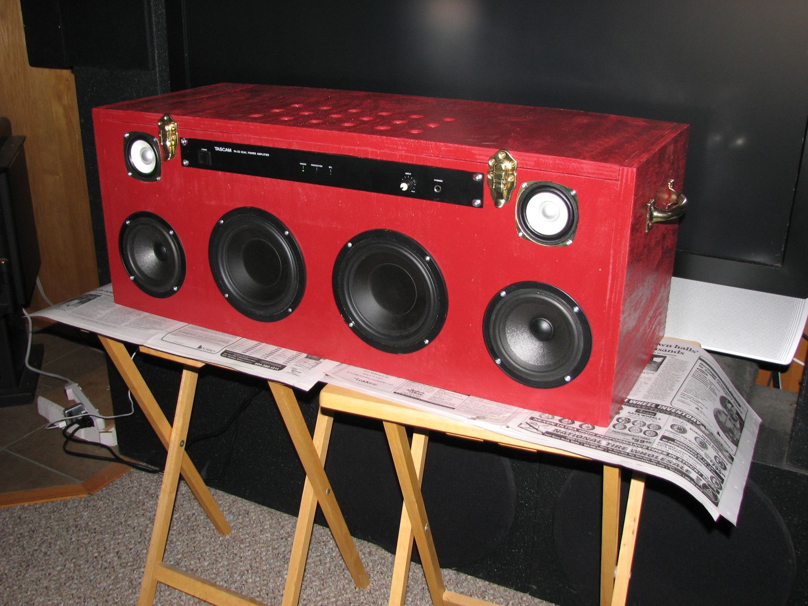

I already built a tool box "Boom Box" with the drivers but I plan to change the shape and be more scientific about it. I have almost .2 ft. of volume in half of the tool box divided in two separate chambers (half of the bottom of the tool box) ported with a 2" length of 1" I.D. PVC. (Driver/Port in each side) I overlooked the volume of the driver and the port and I don't have any room to expand, hence, the PVC challenge..

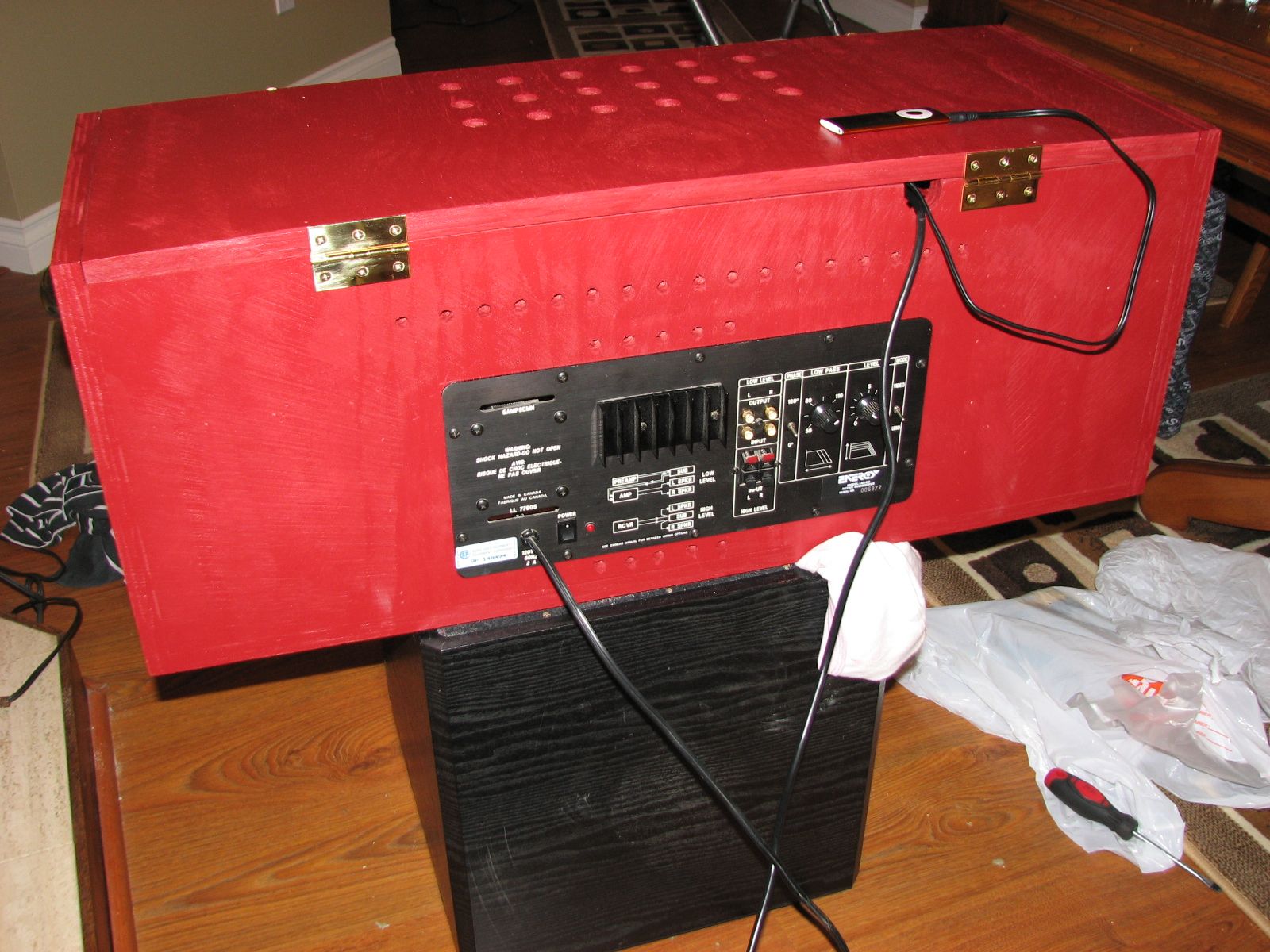

Here ya go, Cal. It's not pretty but it works. Not quite finished with it yet but it's sweet..
I built it for a test fixture. I purchased a couple of sets of speakers (unheard) and got stung! I now have a way to test, even if the seller doesn't have a way to hook them up..
The switch in the center transfers the output of the amp to the speaker connections and disconnects the internal speakers. I can tell if a speaker is junk or not with a few watts.. 😉
To Add..
The box is separated in the center with a piece of 3/4" plywood.. (8x8x6 Approx.)
