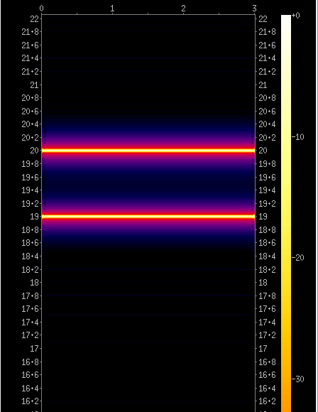

You can check spectrum of the resultant file by running
Code:
sox intermodul.wav -n remix 1 spectrogram -y 4
Cropped resultant picture spectrogram.png:
