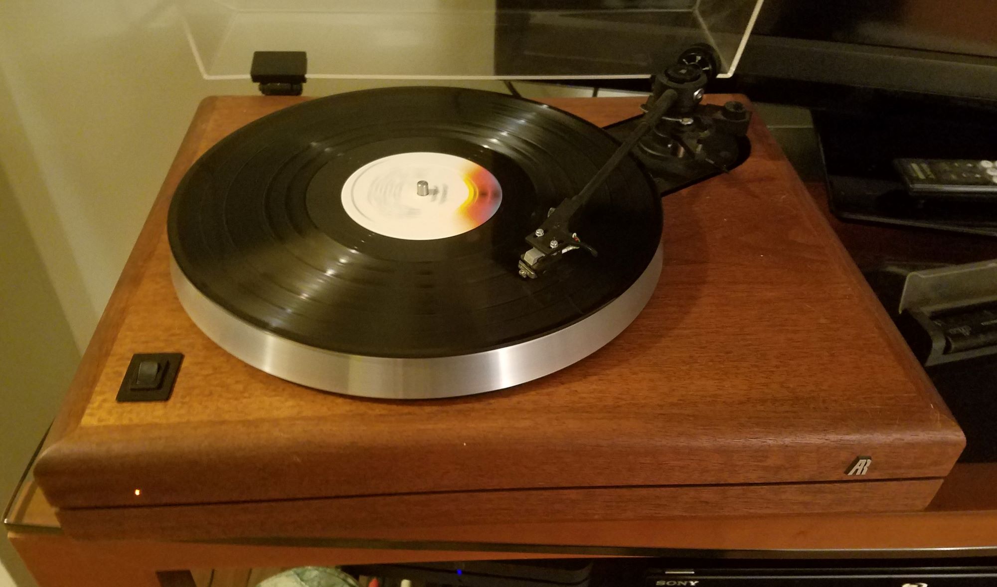

Connected Turntable (Teledyne/AR “The Turntable”, Straight Gelco Tonearm, & Shure V15-VMR. Played a side of “Mask” by Kansas & “Eye in the Sky” by Alan Parsons Project. Wifey thought that I had hauled out some Old CDs... Sounded TERRIFIC. I was hearing stuff/ instruments / sounds that I do not recall hearing on these before (in a GOOD way).
This thing certainly has THE BEST phono section that I’ve ever had connected to MY System.

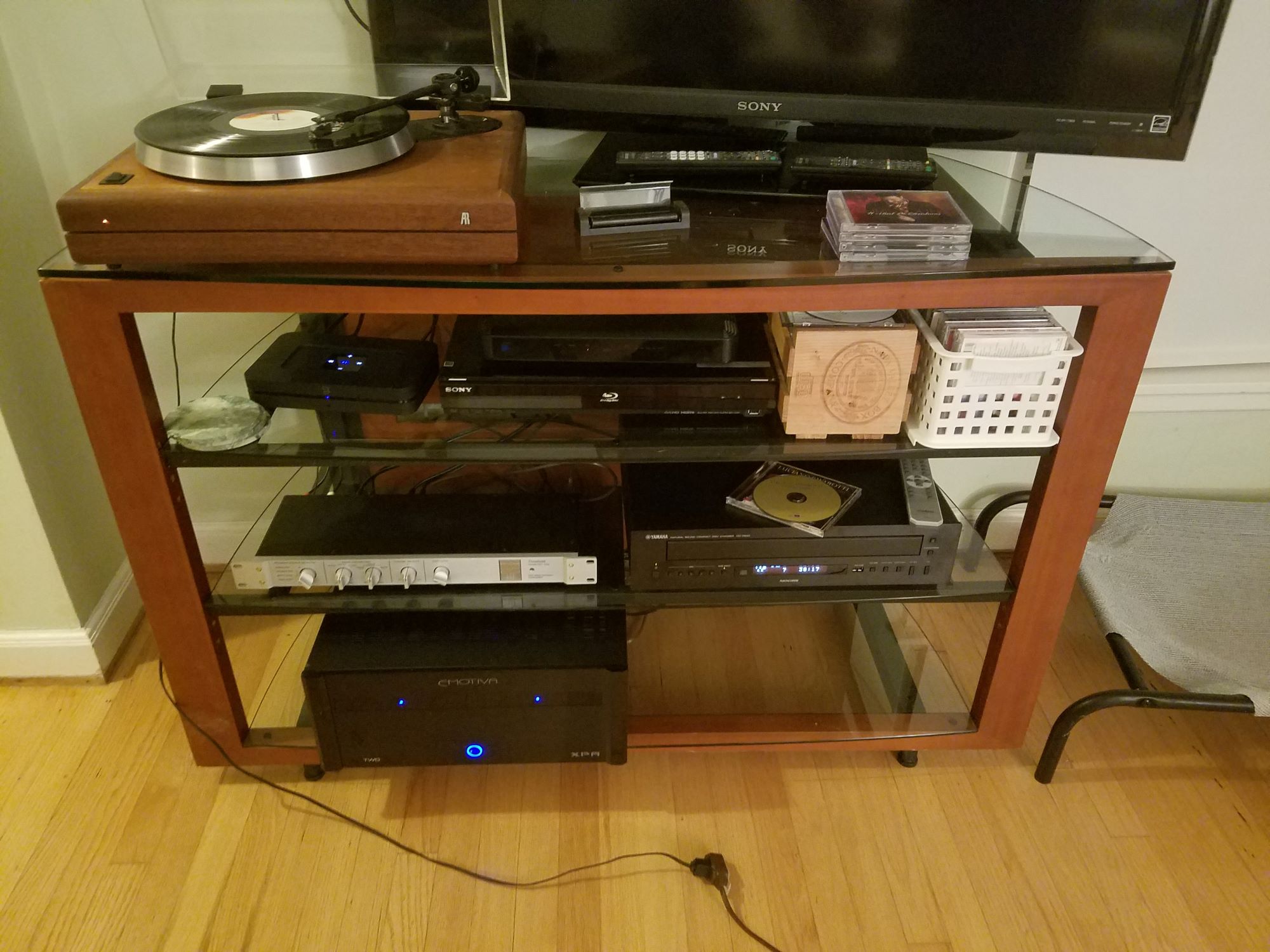

Some "Action-Pics":
