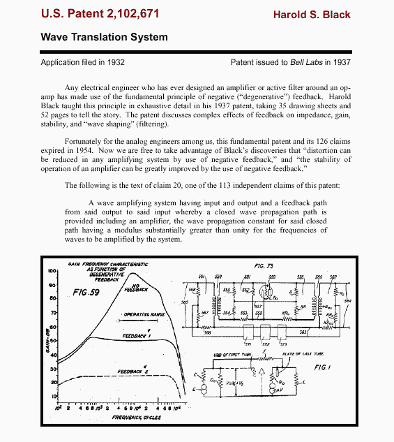

Here is the Patent, where NEGATIVE FEEDBACK
was first introduced.
Some say as A BLESSING
Others say as AN EVIL
In those days were only Tubes.
Yet the Tube people are the most negative to
this way to correct the output signal.
😎 halojoy likes feedback - but not a massive amount of global 😎
