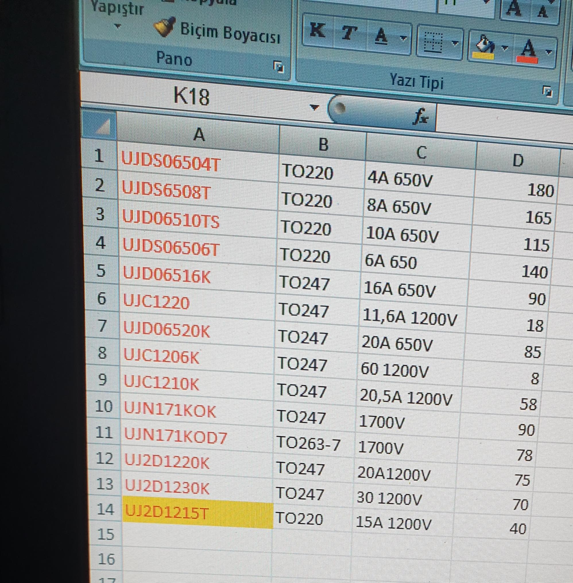

Because of they are expensive parts i only want to buy which can be uses and sold easily. I will use some of them for myself and friend and sell other pcs.

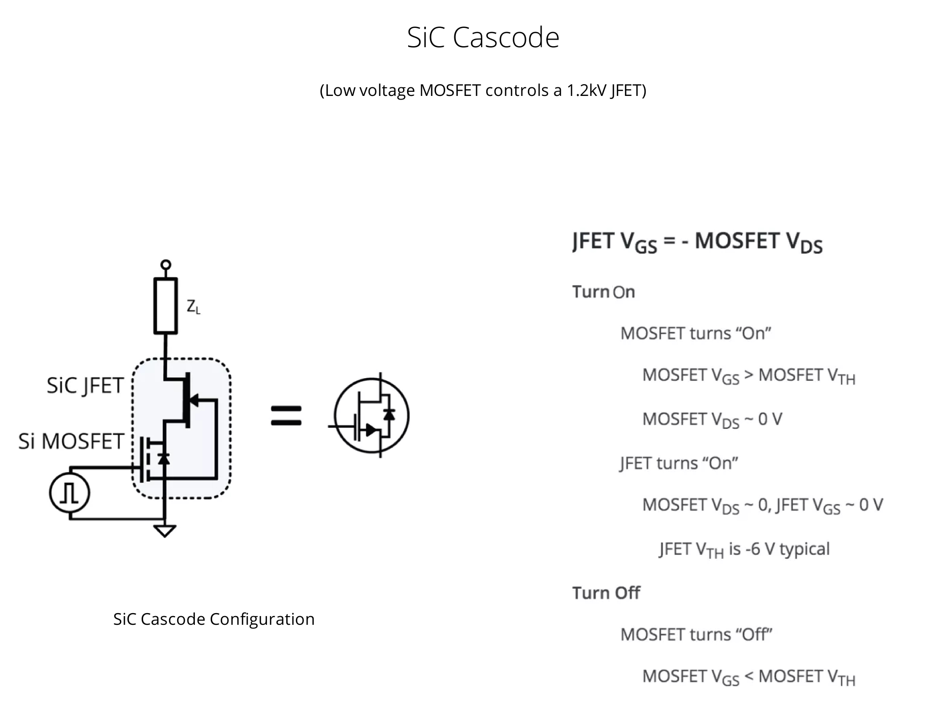

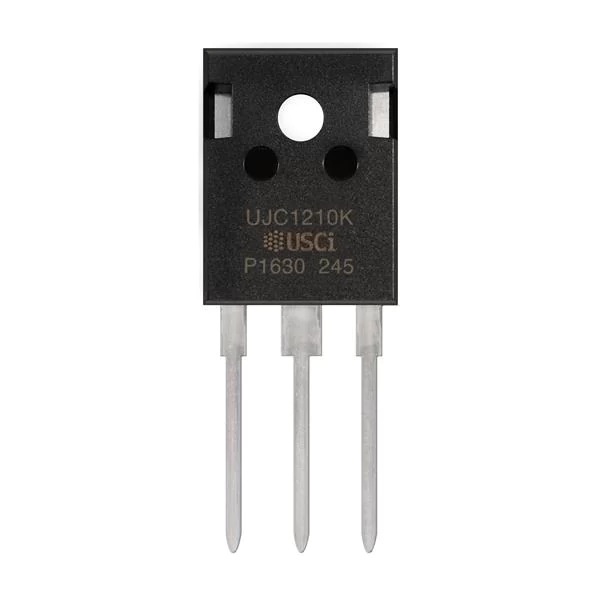

The ones I have are United Silicon Carbide UJ3N065080K3S
I should be more precise.
AFAIK the UJN parts are reliable, but the linear performance of the ones
I tested was not particularly good.
The Cascode parts from Transphorm failed at 24V/2A, and looking at the
data sheet I did not see a DC SOA figure, only switching.
A similar issues have come up with some high power "hockey puck" power
transistors, referred to as "electrothermal instability".
So for starters I recommend being careful of parts that don't have a DC
figure on their SOA curves. The rest is just about whether they show
decently low distortion in audio use.
