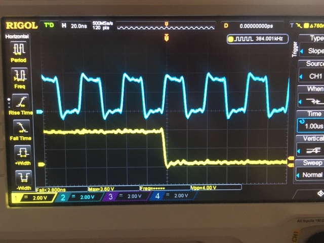

Once I got the src board I connected it as Markw4 said. When getting the divided clock for amanero and ak4137 I didn`t add the buffer but instead I added another 33ohm resistor on the clock divider output(photo 1). One resistor(original one) transports the clock to amanero and the added resistor transports the clock to the ak4137 board(photo 2 and 3).
Initially this didn`t work because I had inverted some connections(photo 4).
The ldo for the clocks on the src board was removed and also the resistors on the outputs of the oscillators were removed(photo 5)
Seeing that it`s not working I decided to connect first the src to amanero directly to see how it works.

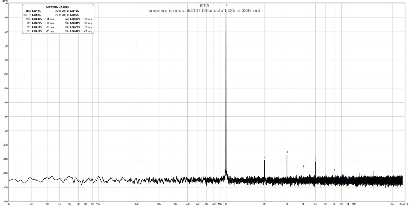

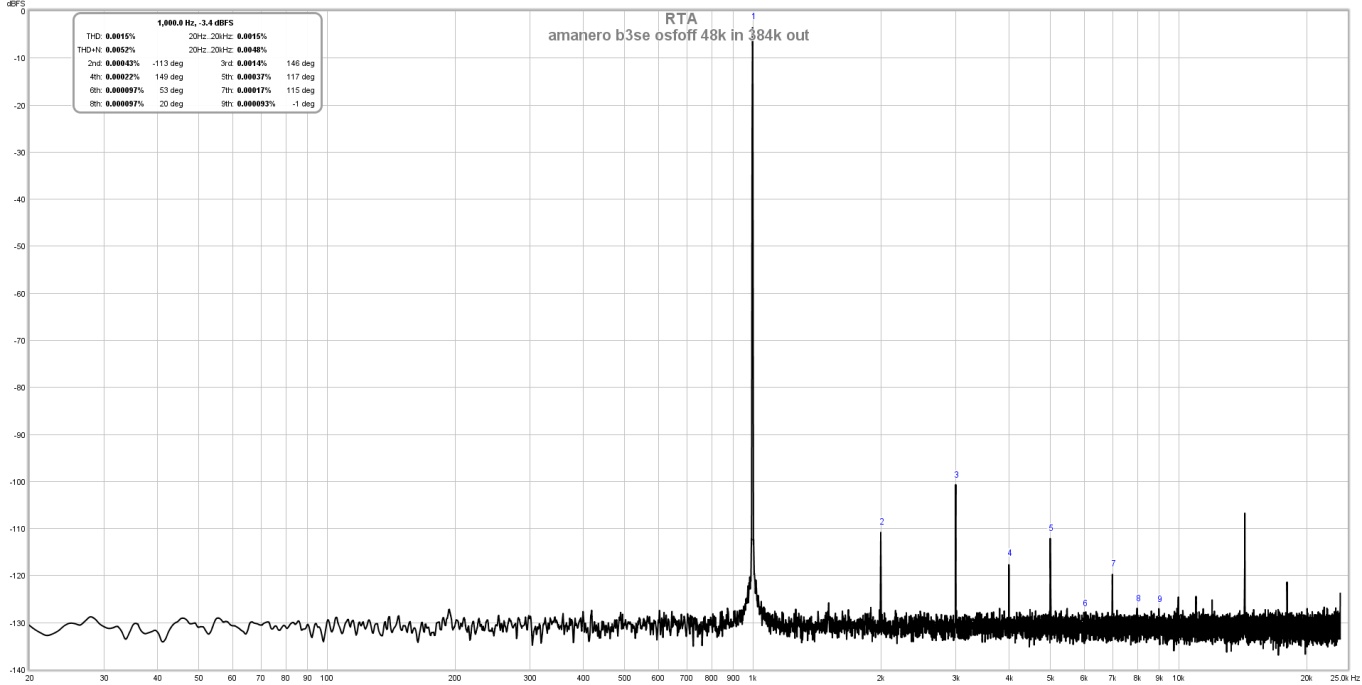

Connected to amanero directly I managed to play pcm and dsd files and also to take some measurements with rew and a scarlett 2i2 soundcard. Please notice that there is a measurement artifact ~14khz. When I use the isolator after amanero this artifact disappears.
My test samples are 48k wav files which are played from foobar with asio.
In all the cases input sampling frequency in the src board was 48k.
Photo 8 shows src output pcm at 384khz and 1khz signal on output
Photo 9 shows src output pcm at 384khz and 13 & 14khz signal on output
Photo 10 shows src output pcm at 384khz and 19 & 20khz signal on output

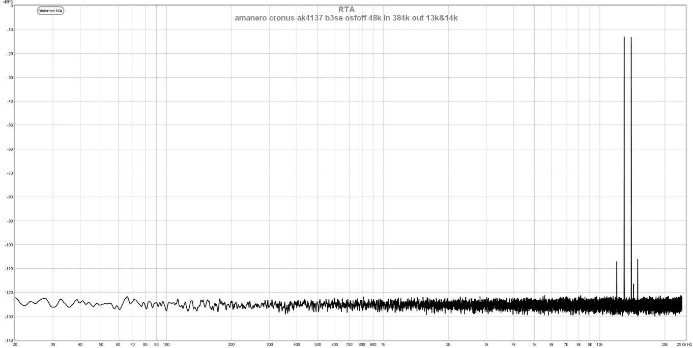

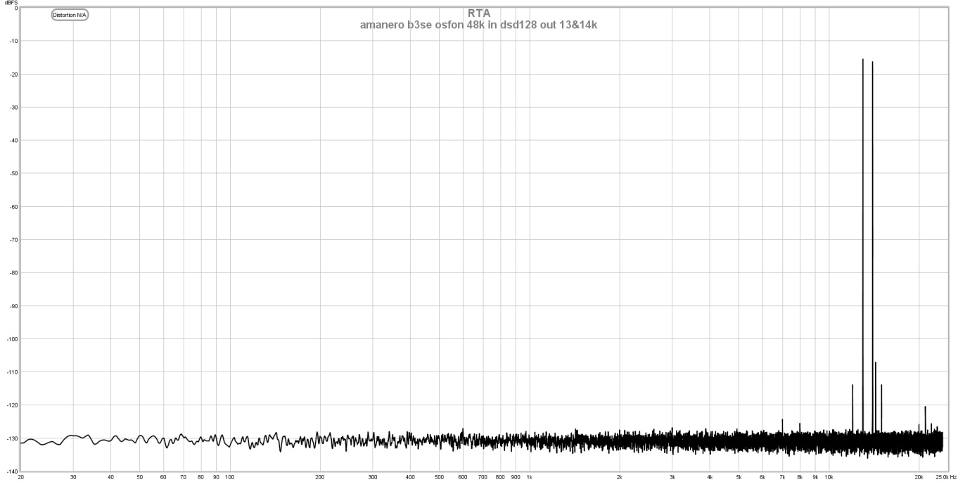

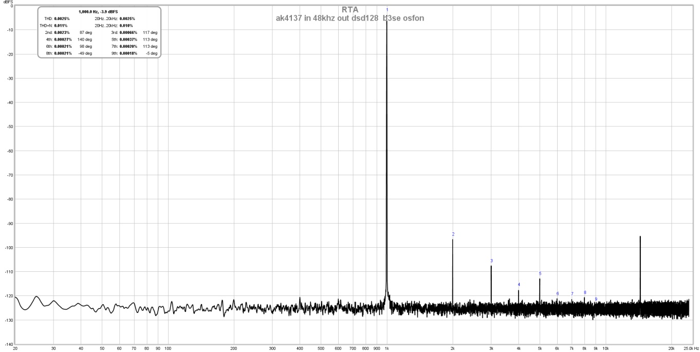

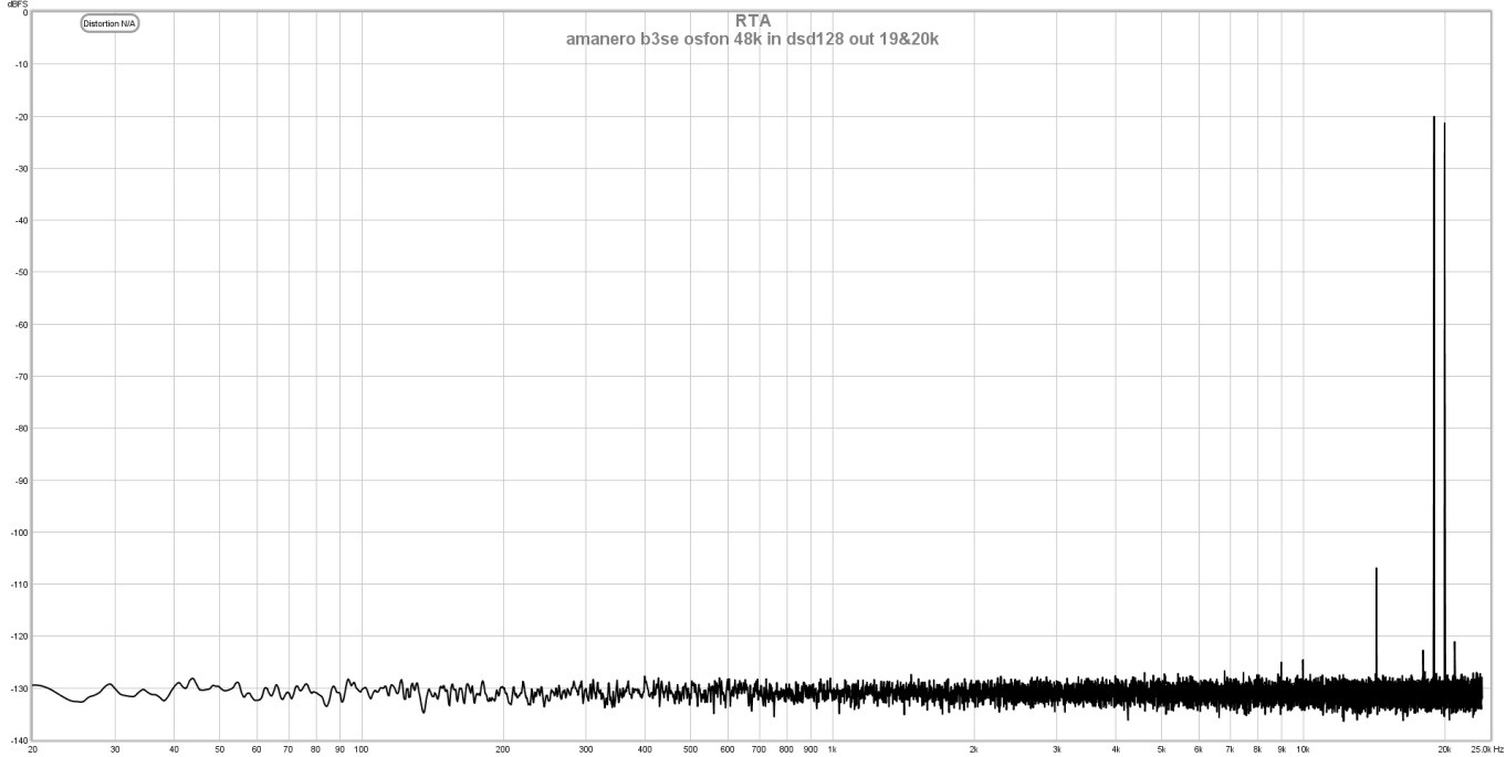

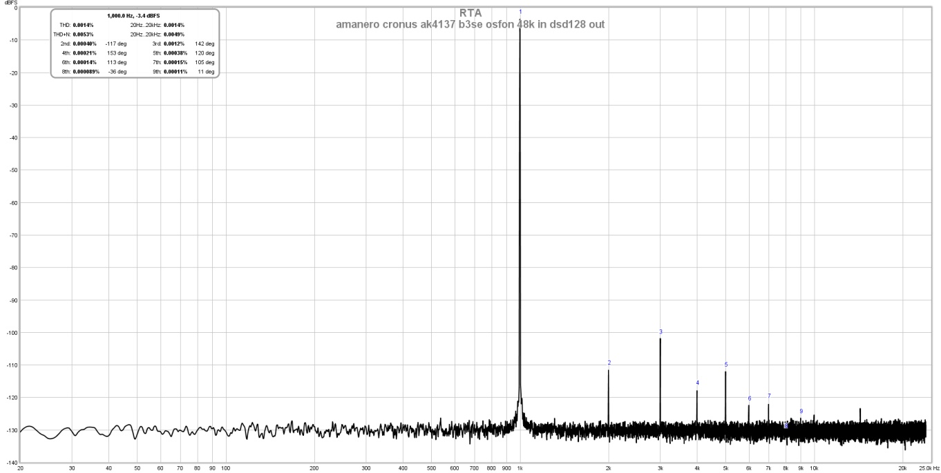

Same input sample rate to the src but this time the output was dsd128
Photo 1 shows 1khz signal, photo 2 13 & 14khz signals, photo 3 19 & 20khz signals.

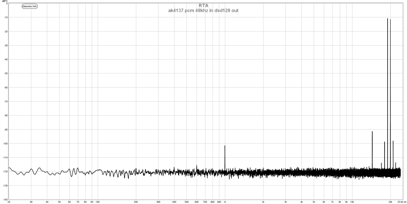

If you take a closer look when there are two differences when upsampling to pcm or to dsd. First is at low frequencies(1k) where with dsd you get higher thd levels and at higher frequencies(13 and 14, 19 and 20 ) you get also higher imd.

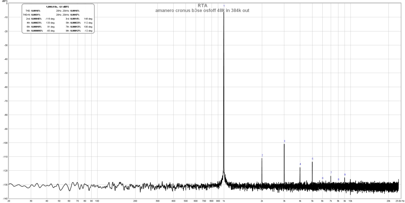

After doing the above measurements I decided to connect amanero directly to b3se and take the same measurements.
Photo 4 shows foobar upsampling to 384k and 1k
Photo 5 shows foobar upsampling to 384k and 13 & 14k
Photo 6 shows foobar upsampling to 384k and 19 & 20k

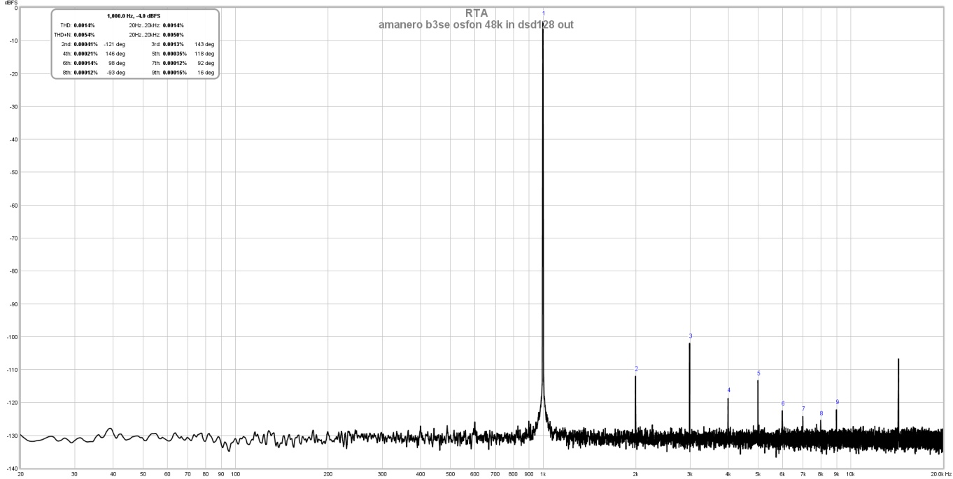

Photo 7 shows foobar upsampling to dsd128 and 1k
Photo 8 shows foobar upsampling to dsd128 and 13 & 14k
Photo 9 shows foobar upsampling to dsd128 and 19 & 20k

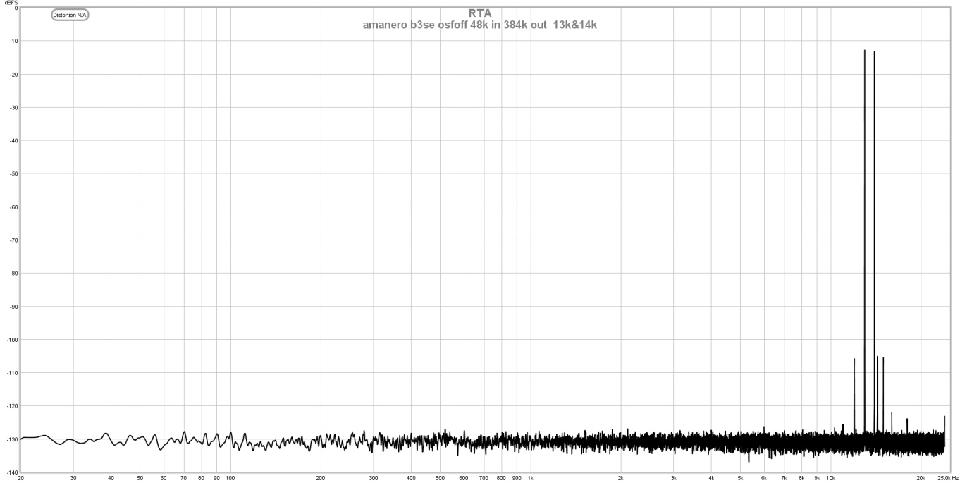

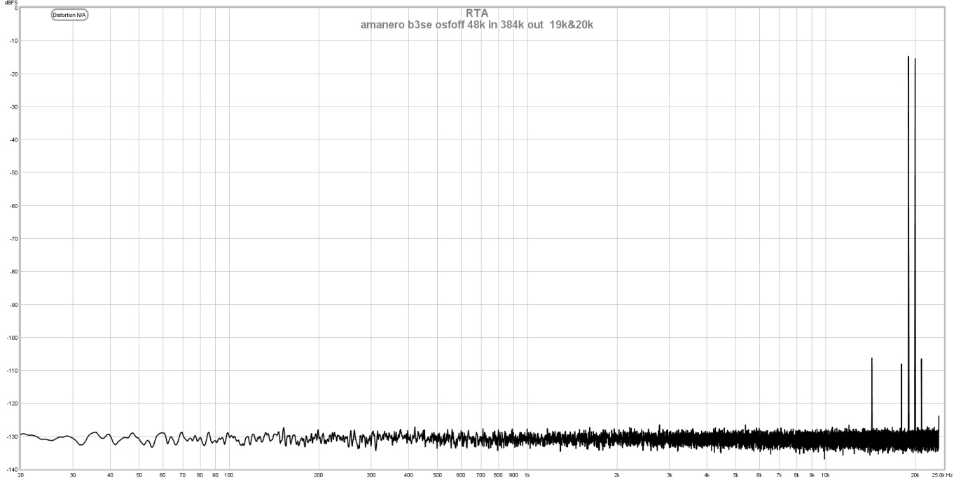

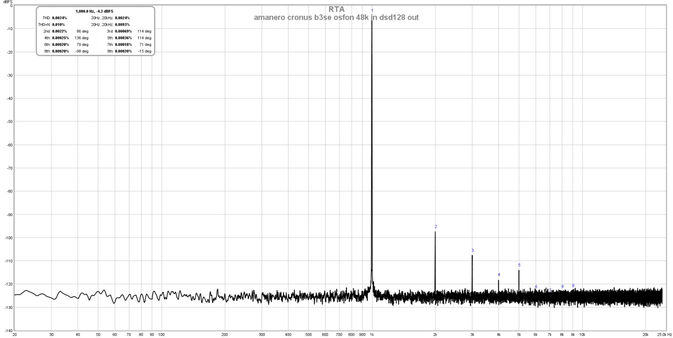

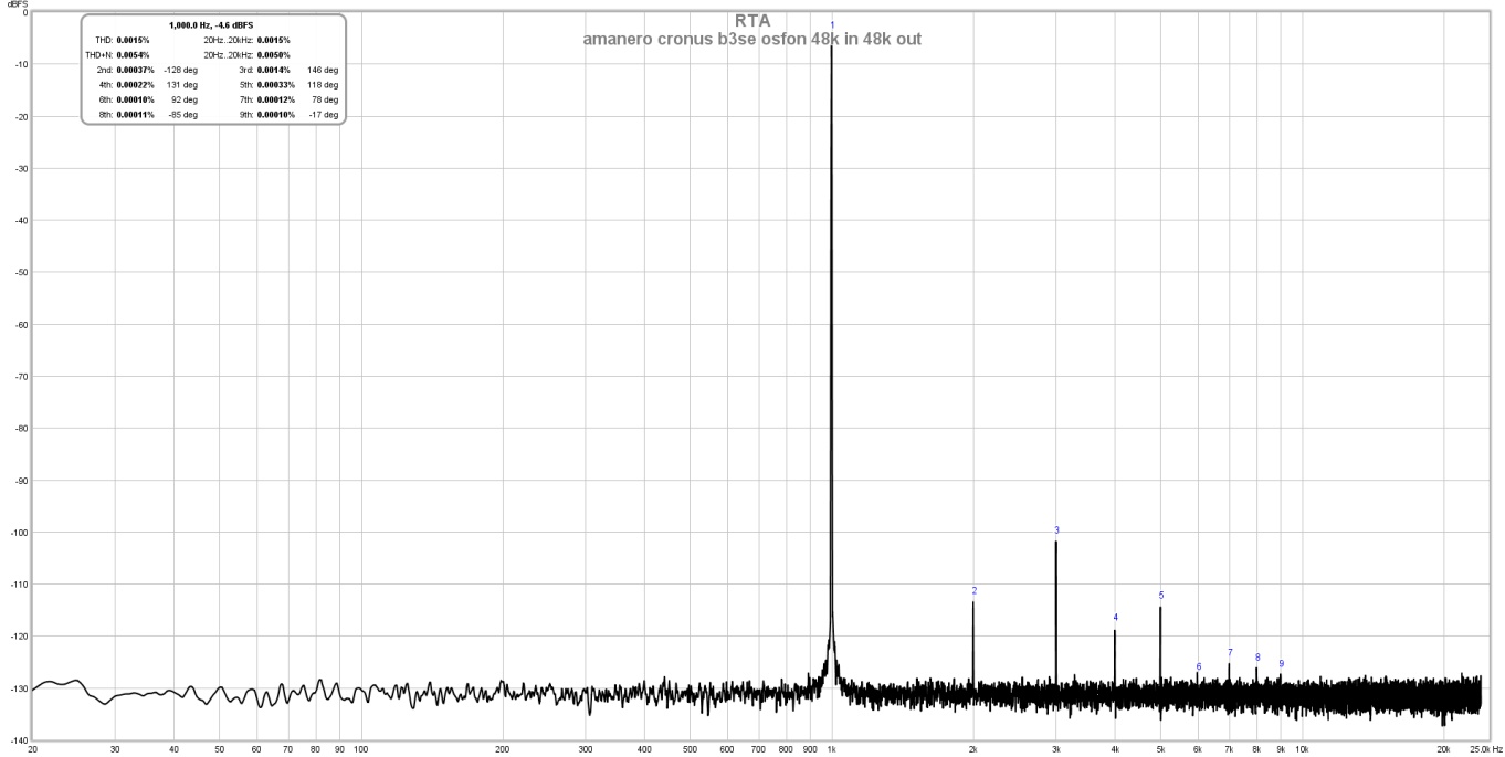

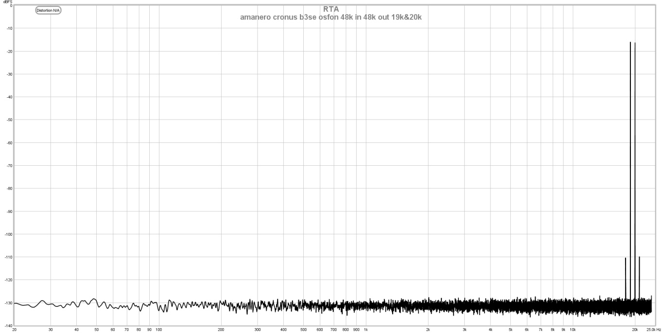

Here you can see some measurements of amanero cronus and b3se
Photo 1 shows foobar upsampling to 384k and 1k
Photo 2 shows foobar sampling to 48k and 1k
Photo 3 shows foobar sampling to 48k and 13 & 14k
Photo 4 shows foobar sampling to 48k and 19 & 20k
Photo 5 shows foobar upsampling to dsd128 and 1k
Here you can already notice that the 14khz artefact disappeared because of the isolator being used between amanero and cronus

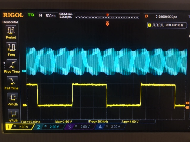

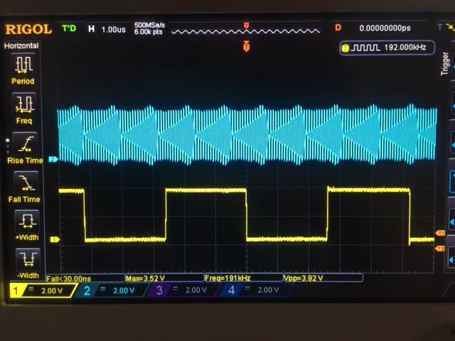

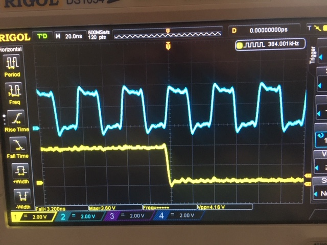

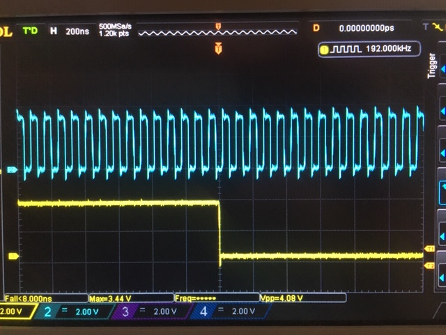

And now finally after being sure that the src board works as expected I decided to give it one more try and connect it again after cronus.
If I try to use the the divided clock from cronus for the src, same clock that goes also to amanero, I get wrong sample rate reading on the display of my dac. The dac has its own 100mhz clock.
For example I opted to upsample in foobar 44.1khz and multiples to 352.8khz and 48khz and multiples to 384khz.
If I choose that the src upsamples to 384khz and I play a 44.1khz file, foobar ouputs 352k and the src should output 384k but the controller of the dac shows 352khz.
Same happens if I play a 48k file, foobar upsamples it to 384 but if I choose that the src downsamples to 352k i will get 384khz on the display of my dac.
Please note that the sound is ok or at least seems ok.
I have to play more with this to get a better idea of what is happening.
Seeing that the issue from above happens I decided to solder back the ldo and the resistors on the src board and this way it will use its own clocks.
Well like this I could get correct readings from my dac for the pcm input sample rates.
There is also one small issue. If I play a 48k file, upsample it with foobar to 384k then send it to the src and choose to output 384k everything sounds fine.
Instead if I play a 384k file with foobar with no upsampling and send it to the src board that outputs it at 384k, I will get a distorted sound. I get same distorted sound even I convert to dsd in this case.
Else it`s working fine with files until 192k.
I didn`t manage to stream dsd files from foobar bacause I didn`t connect the dsdon pin from amanero so the src mcu doesn`t switch for dsd.

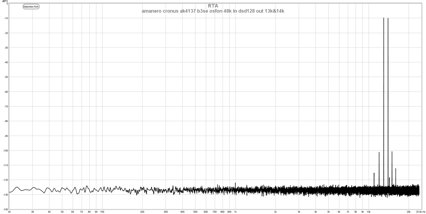

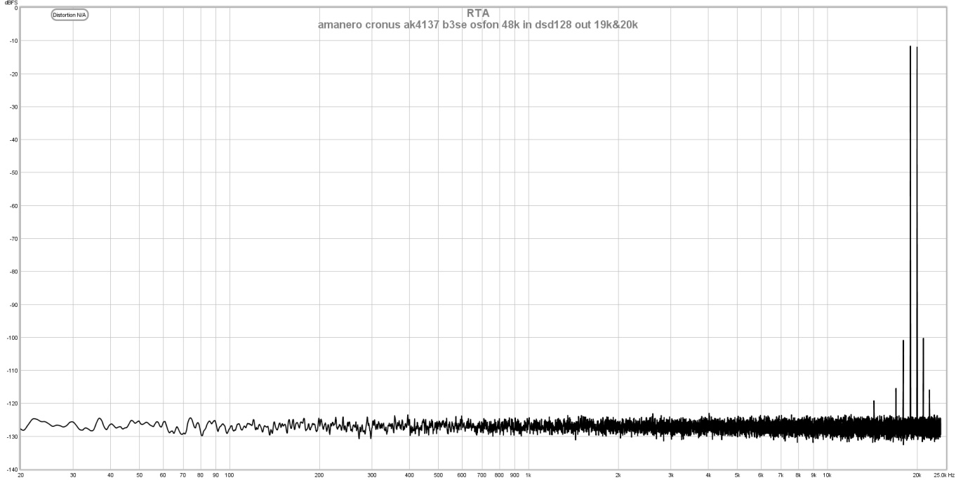

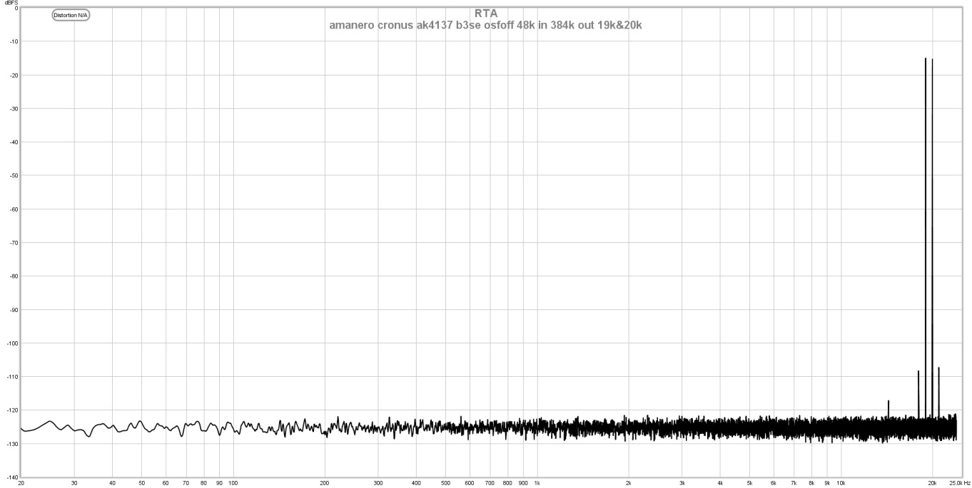

Like in the other configurations I have done some measurements also for this configuration.
Photo 1 shows foobar sampling to 48k and ak4137 upsampling to 384k 1k
Photo 2 shows foobar sampling to 48k and ak4137 upsampling to 384k 13 & 14k
Photo 3 shows foobar sampling to 48k and ak4137 upsampling to 384k 19 & 20k
Photo 4 shows foobar sampling to 48k and ak4137 upsampling to dsd128 1k
Photo 5 shows foobar sampling to 48k and ak4137 upsampling to dsd128 13 & 14k
Photo 6 shows foobar sampling to 48k and ak4137 upsampling to dsd128 19 & 20k
amanero cronus ak4137 b3se osfoff 48k in 384k out 13k&14k.jpg134.1 KB · Views: 69
amanero cronus ak4137 b3se osfoff 48k in 384k out 19k&20k.jpg133.2 KB · Views: 60
amanero cronus ak4137 b3se osfon 48k in dsd128 out 19k&20k.jpg132.7 KB · Views: 70
amanero cronus ak4137 b3se osfon 48k in dsd128 out 13k&14k.jpg134.3 KB · Views: 57

Seen the above sittuation I decided to pull out the scope and check BCLK and LRCK signals.
Image 1 and 2 show a 192k file played from foobar at 192k. The measurements were taken at cronus output.
Image 3 and 4 show a 384k file played from foobar at 384k. The measurements were taken at cronus output.
Image 5 and 6 show a 48k file played from foobar and upsampled(in foobar) to 384k. The measurements were taken at cronus output.
Looks like too much aliasing on the blue BCLK signal in some of the images, not useful to see that.
Also, don't know what features your scope has but kind of looks like there is a separate frequency counter on channel 1 (yellow) that displays even if one cycle is not present on the scope display. In addition to that it looks like the scope typical measurement function that displays below the waveforms is set to display some parameters of channel 1 including frequency. That frequency display only works when at least one cycle of the waveform is present on the display.
Given the above described appearances, can you set the scope to trigger from channel 1 with high enough sweep speed to show a stable BCLK display showing at least one cycle, and set the measurement function to display channel 2 frequency? If so, maybe we can read out both clock frequencies at the same time while looking at unaliased stable waveforms. Something like that, your choice
In addition, not sure what bandwidth your scope has but BCLK rise times look slow, and there is a lot of ringing on top of the waveform. Clock wires too long, lack of buffering, and lack of a series resistor at the buffer output all contribute to degraded clock signal. Maybe interesting/useful to see what BCLK waveform looks like in single sweep mode and in averaged acquisition mode too.
While waveform is not good, it probably has nothing to do with distortion or not. Regarding distortion, does the problem only happen if AK4137 is in the signal path?
I have seen strong distortion from mismatched word-length and or LJ/I2S/RJ settings. I have seen a more subtle distortion if Sabre dac doesn't like the jitter profile of the AK4137 clock (assuming the distortion is related to AK4137 at all).
A smaller yet distortion can arise from intersample overs. If using Windows to drive Amanero, the usual precautions should be taken to make sure Windows Sound Engine is not messing with the output of Foobar with ASIO component (Foobar ASIO driver, Windows volume for Amanero full up, Amanero not set to Windows default comms device nor default sound device). In addition, probably wise to turn down Foobar digital output by 3dB or more to check for any level sensitivity of distortion.
EDIT: Estimating from scope display, at 384kHz sample rate BCLK ~25MHz which implies 32-bit word size. 384x10^3 x 2-channels x 32-bits = 24.576x10^6 Hz
Presumably, AK4137 is also set for 32-bit input and output word sizes. Please confirm.

Why do you have channel 2 (blue) up while aliased? Are you used to setting up the scope for different applications? What model scope is it?
DSD produces noise, could be insufficient filtering in your output stage. Something that should probably be tracked down to find the cause and correct it.
I moved on channel up and the other down for better visibility. I can change to have them both one over the other.
The last time I used the scope I monitored some uart data lines.
The scope is a Rigol DS1054Z.
As you can see I`m not an expert in using it but I try to do my best.
