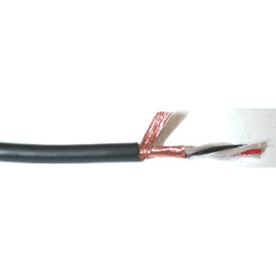

@rayma - would you consider Mogami W2552 mic cable a better option to wire transducer to the phantom power box?
That cable is ok as long as you leave the transducer's center terminal floating. The conductors are not twisted, though.
Then you can float the shield on the transducer end of the cable, and ground the shield on the Solo end of the cable.
That makes sense about connecting the shield only on one end. To be clear, this cable only goes to the battery (3" away), and a 1/4" TS patch cable connects the battery unit to Solo.
BTW, how did you figure out it's not twisted? I was hoping it is because it's made for mic but 🤷♂️
