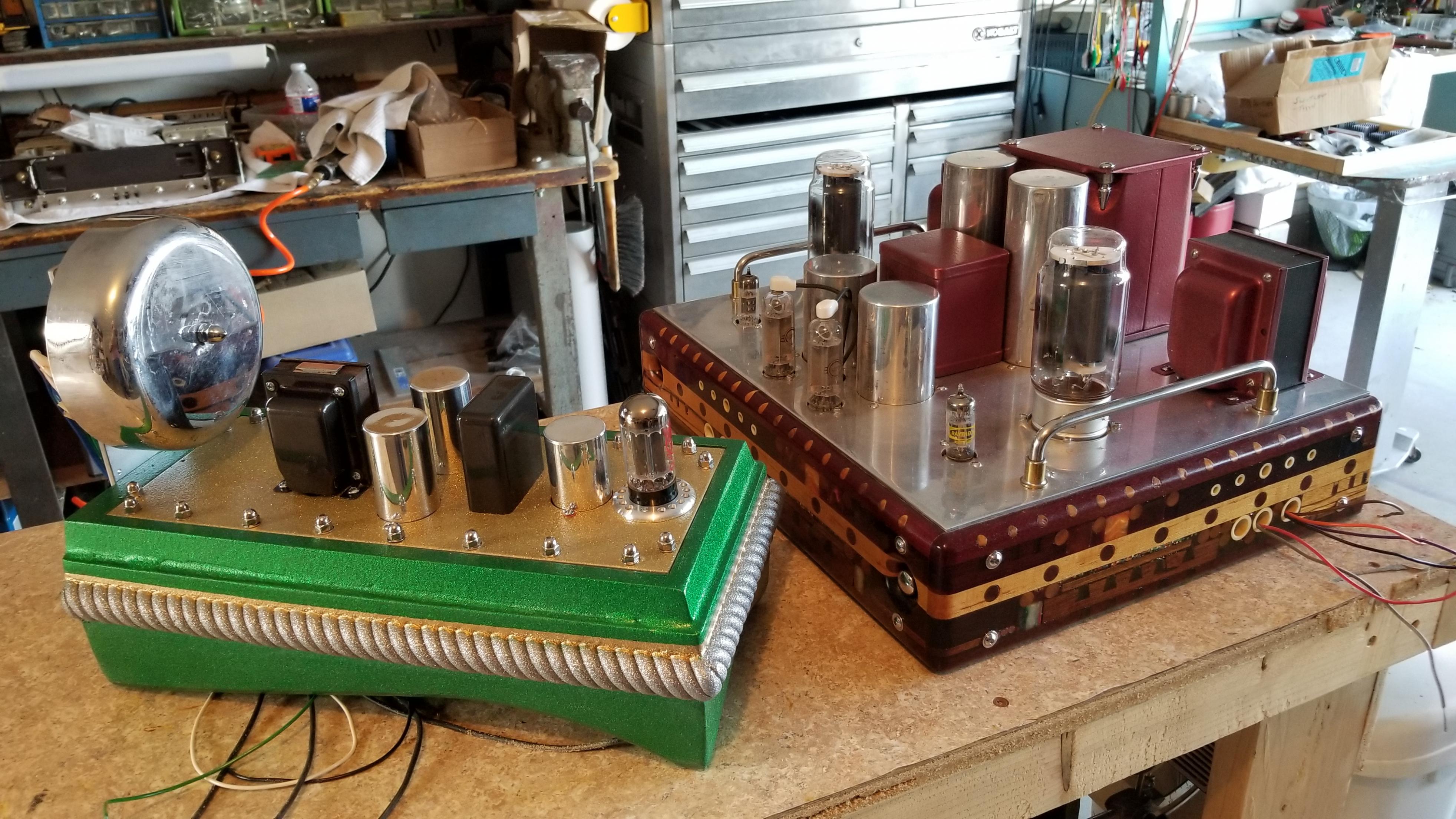

Here is my GM70 amp with the filiment power supply and driver tube B+ in the green chassis. I mounted the toroidal in back under a custom chopper air cleaner.

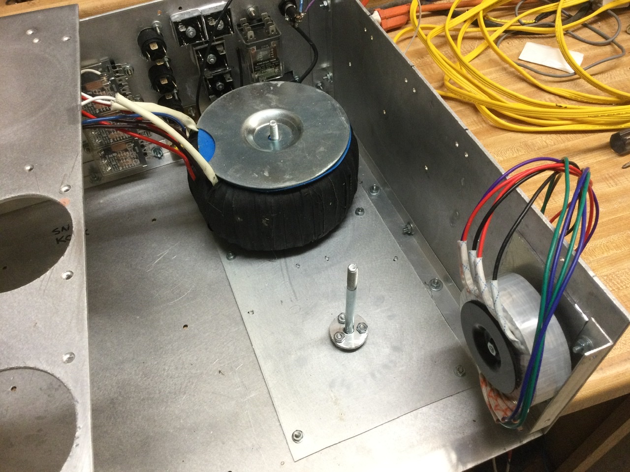

When using a bolt through the middle of a toroid you have to watch out that it doesn't make an additional single turn with the chassis and bracket.
The bolt, bracket and chassis becomes a shorted winding over the secondaries and will overload/overheat the primary,
until something melts or burns, hopefully the fuse.
Don't forget, no shorted turns allowed from the mounting hardware.
Hah! In the 80s I did some consulting for a company making a piece of broadcast TV gear. It was a one RU chassis and they made a C shaped bracket with the toroidal transformer inside and a bolt through the center clamping it all together.
The young engineer on staff was baffled why the line fuse kept blowing and was blaming the transformers.
Hey, nothing beats practical experience. College doesn't teach you everything you need to know.
They solved it with a nylon washer under the screw head. I didn't like that for long term reliability but that was not my area of work.

While this particular build isn’t a *tube* amplifier, it does show an interesting way to mount toroids. I will likely mount the power and output trafos this way when I get around to that kilowatt tube amp using a bunch of LW6’s driving an Antek 15T950. There is a 6U box waiting for that build.

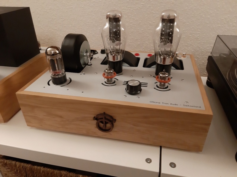

This is kind of what I'm going for. I stole the picture from a other thread. I noticed the rod end bolts are isolated from the chassis with rubber washers or grommets. I'll probably use a section of an inner tube to cover the windings so it looks better than the mylar wrap.
I may also cut out the chassis to recess the transformer just enough to hide the wiring.
I have one more small parts order and I can start building the 6L6 PP amplifier.
