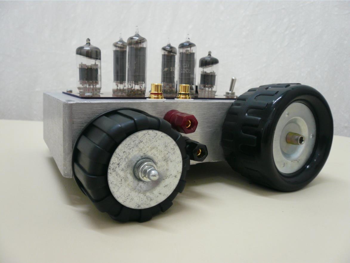

That's what I did with a little fun project!😀Well, they do look like wheels, and dual mono needs four of them.

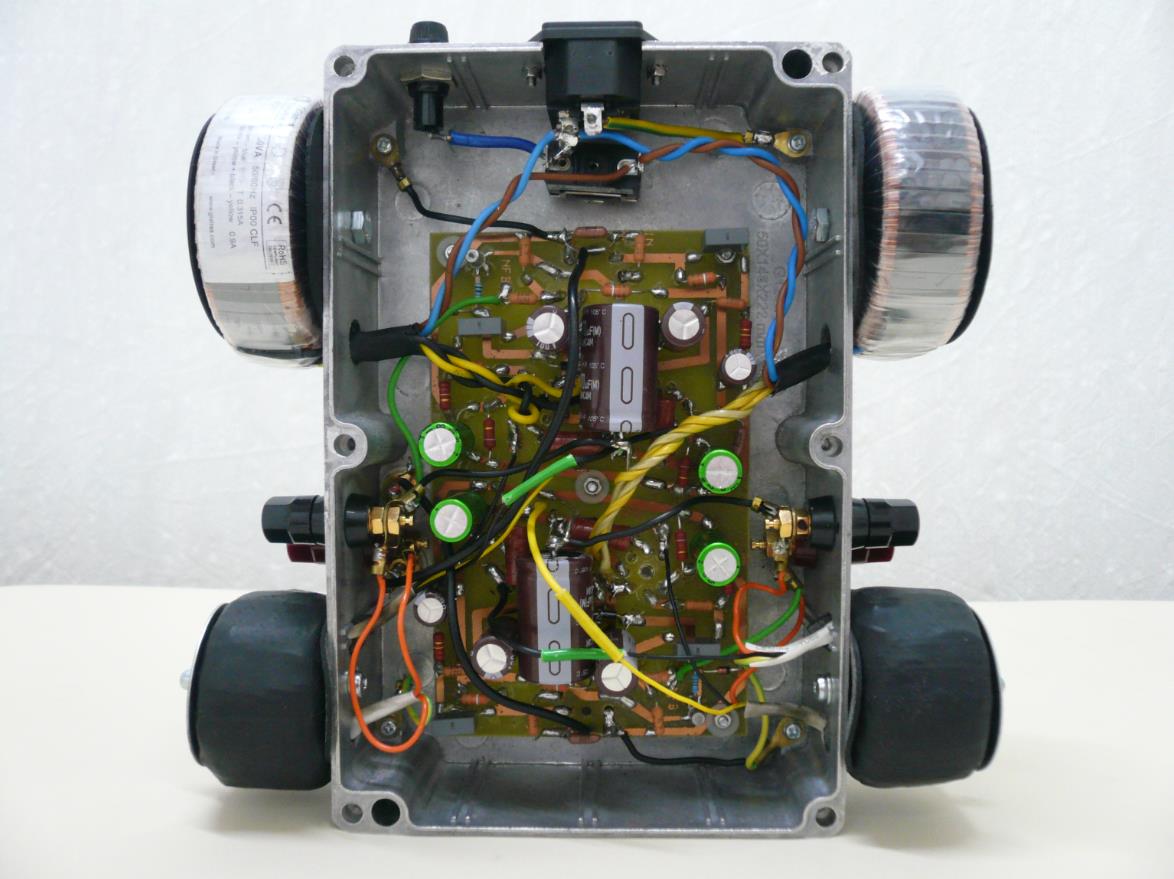

I acually thought about a rubber or plastic tire off of a kids toy.
I'll probably hit up the local hardware and Home Depot stores and see what I can find that will work for me. I am going to try the rod end bolts though. Someone posted a picture of a couple amplifiers here on DIY they build and sell that used the rod end bolts to mount the toroidal power and out the transformers vertically. I just couldn't make out what was used to cover the windings. It looked like black shrink tubing? I liked how it looked.
The front wheels are wearing proper air tubes - from bicycle. I used two sleeves to tight the OPTs windings....
