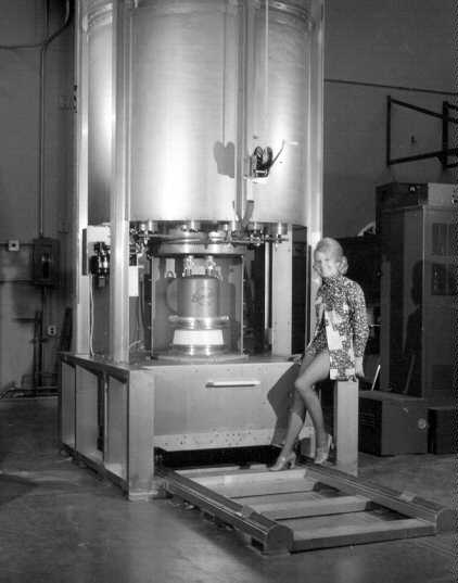

Why not just stick to a big tube like this Eimac rated at 17,000v
and 60A or 2,000,000 W wonder what a matched pair would cost.
And it provides a lot of hot water!
woody has attached this image:
Click the thumbnail to see the original image.
I didn't notice any Eimac tube in that photo.
That's the Eimac 8974. It's the cylindrical object with the white base underneath the large tank
An amp with a pair of those babies would truly be a killer of giants. I wonder if the OPTs would fit in my living room...
You must me talking about the thing on the other side of that pair of legs. I didn't see it at first.
John🙂
