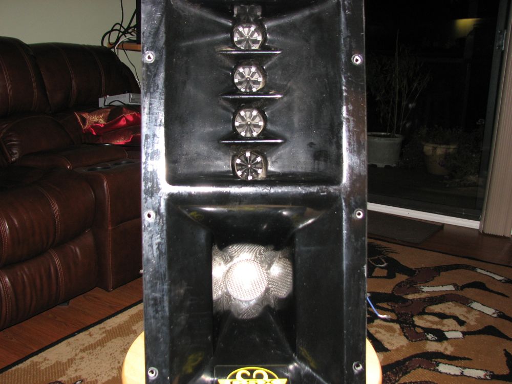

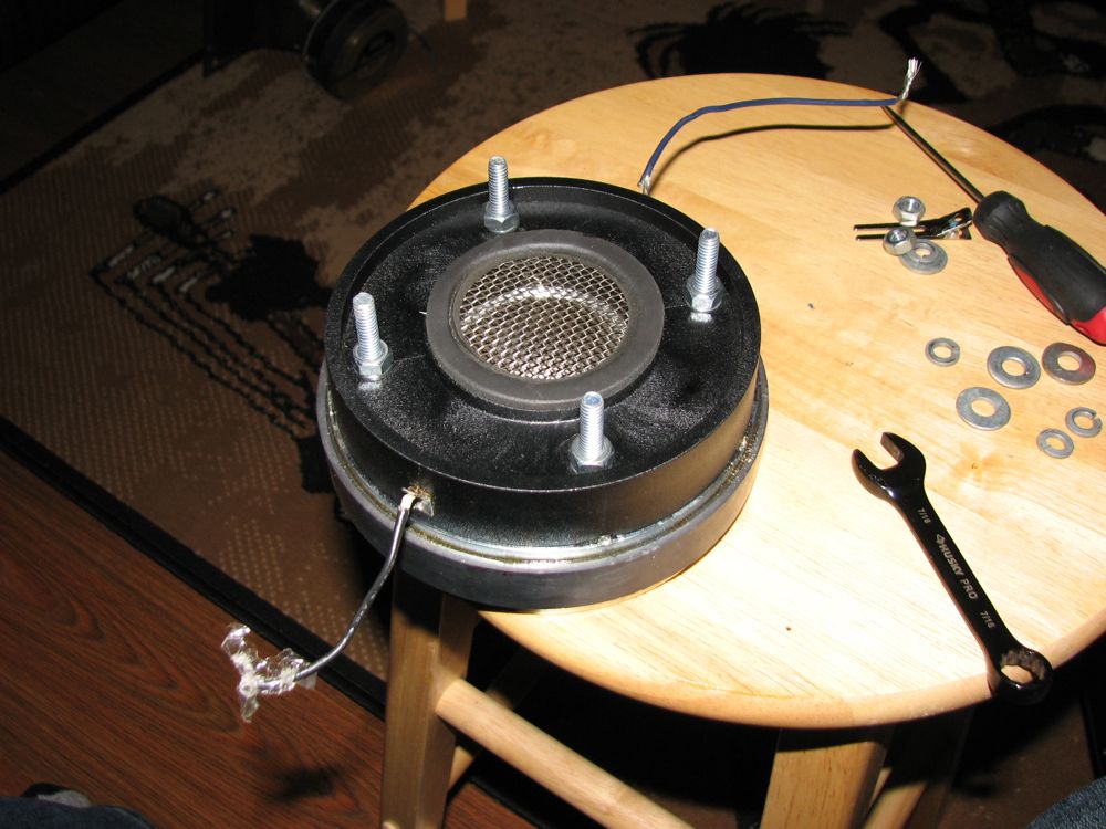

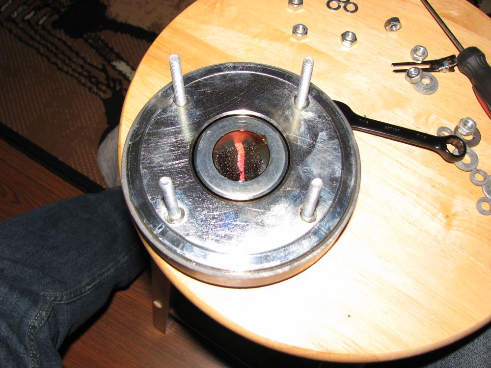

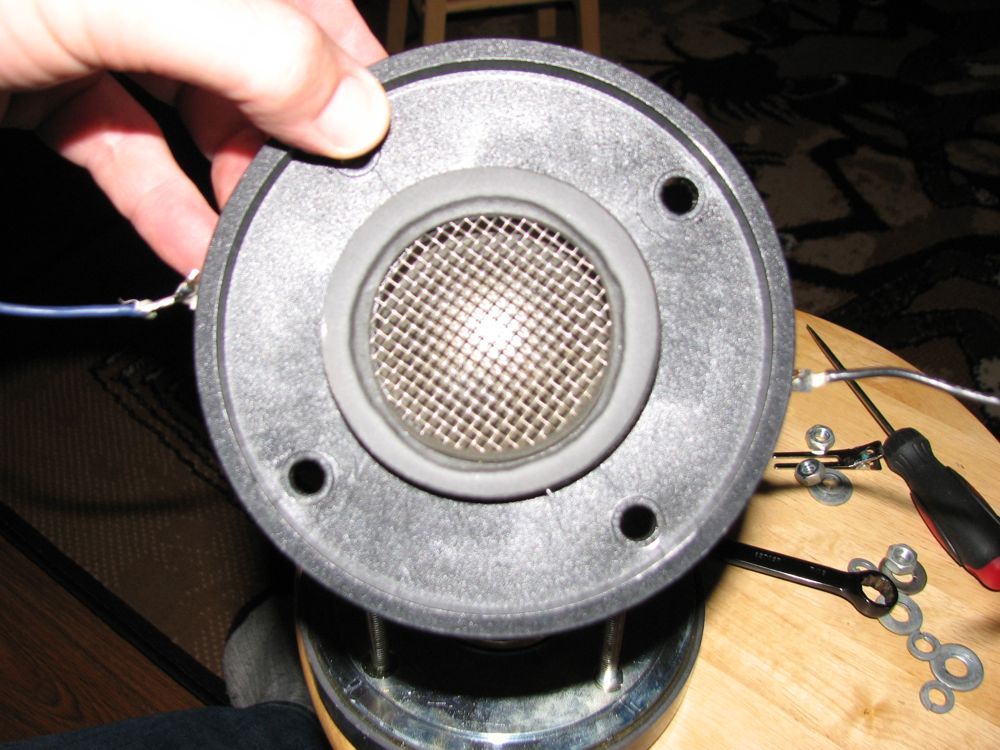

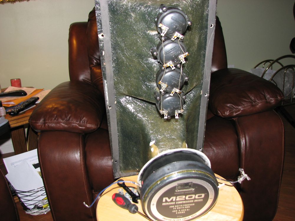

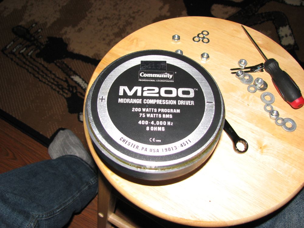

From a Community 4X12 3 way. I would like to concentrate on the mid as the 4X piezo, while interesting is not really my cup of tea even though it seems to be a really nice implementation.

I've only seen it on the datasheet (there's a cutaway view showing that), and found it very interesting too.
How does it sound? Is it still available?
Edit: The 'phase plug' still exist, just not cover the dome. It block the 'suround' - or should be seen as the outer area of the whole diaphragm.
From a CSXs2 cabinet right? Used the 57s2's for many years. Actually a very good sounding fuzzy box. Mostly eminence drivers inside so replacements were inexpensive. The automotive light bulbs were a trip. You knew you were out of gas when the ports lit up! The M200 diaphrams should still be stocked. I think they crossed the piezo's really high so they just added some sparkle.
m200 = awesome sounding midrange compression driver (m200a is a bit better). The low 4:1 compression ratio makes it smooth and easy to listen to compared to the typical 10:1 ratios. The m200 has a peak then shuts off. You can't eq the highs in.
There is a newer version, the m200a or also the same compression driver used in the avante-garde trio, but they use a different impedance for volume level matching.
Best to run m200 24db LR active crossed at 600hz and 4khz.

They actually say 1.84:1 so that seem even better? Certainly an interesting take on the word "compression". If the attachment shows up then you'll see why I think this is an interesting set up from a set of speakers that I basically "stole" from my local public house. It's nice when the owner drinks too.
No plans for it quite yet. Just robbed the woofers for a new "itch" I am hoping to scatch. The mids do sound good though, perhaps something in the next couple'o'years. There are many projects on the board whereby the product is getting a more than wee dusty. My urge to compile projects seems greater than my capacity these days.
The piezos, what can I say... I am considering using them instead of speaker spikes.

yup, those are them, and yea, the compression ratio is that low, I couldn't remember. The vhf100 has 4:1. You can see the spike at 6khz on the harmonic distortion charts, freq response, and impedance plot. That's caused by a resonance due to the parallel portion at the throat. The m200a does not have this and thusly does not have the resonance.
