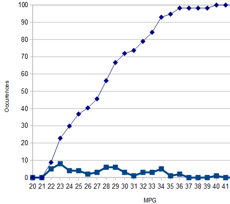

interesting data histogram - statistics experts?

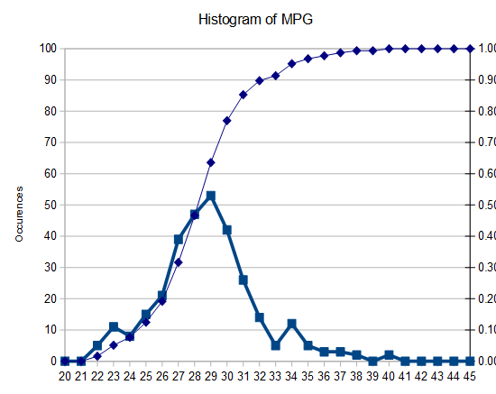

a graph of mpg vs number of occurrences for my auto. looks a bit like an fft with side "lobes". is there some kind of obscure relationship between fft and histogram?

I'm bad a stats, but trimodal distributions do occur quite often. Does look like a sinc pulse if you squint tho, so may be an anomaly from the analysis. You certainly wouldn't expect a skinny sigma graph for mpg given different driving styles and conditions across a continent.
I had a few hypotheses that I tested with graphs etc. Haven't quite narrowed it down. Thought earlier of quantization and dropping the bins down to every tenth of a mpg to see if the pattern remains. I have only 317 data points. Car is an '02 Saturn twin cam. Gets amazing mpg (~40) at 55mph.

Is this fuel economy data based on measured distance between fills and fuel added or is it derived from the vehicle fuel economy display? If it's the former there is an unusually wide skew between the mean/median and those two population bumps at 34 and 40 MPG unless those are very unusual trips between fills.
The lower side distribution is pretty understandable given your location as winter driving in MN especially if it involves relatively short trips would be a major hit to MPG.
It is data based on fill-ups over the past ~9 years.
Before posting, I had that thought about winter driving and checked the occurrences of 23MPG and they do not reliably fall during winter (or any) months. I thought it might be peaks showing when the car was filled on a level, vs inclined either way, but I don't think that is the case.
Thinking about this again, my trips were more sporadic and mileage more variable when I first owned the car (walked to work) vs. today.

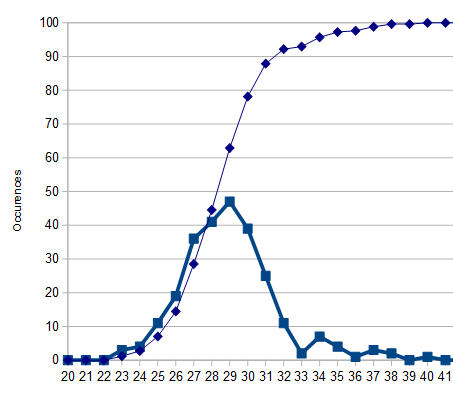

So I looked at histograms before and after moving. Before moving the histogram had three peaks of almost equal height at 23, 28-29 and 34.
After moving there was a more normal shape with peak around 29, but still "sinc" bumps above at 34, 37 and 40 for the occasional all-highway trips I do. only a very slight excess at 23 remains.

Just to underline what I wrote in post 9. Most of the variation was from before the move when I didn't have a commute. Here are shots of before and after. Before the move I have 3 peaks, which I will call: goofing off, running errands and trips. After, it is mainly commuting and trips.
The low side outlier before the move I am guessing is mainly goofing off: spirited driving, holding a lower gear etc... Not anything silly like racing (stoplight or otherwise) a 100 WHP commuter car 😉
There is a gradual downward trend lately. New plugs and wires fixed some misfire codes, but had no effect on mpg, thinking it could be O2 sensor or blowby. Seems to be burning less oil lately, though; perhaps odd for a Saturn 😉
