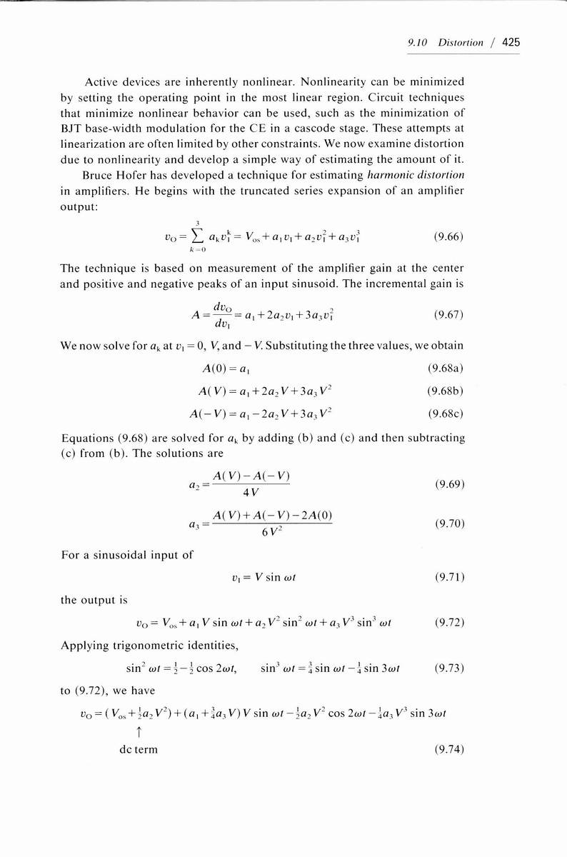

OK, here’s what I found. Source: Dennis L Feucht, Handbook of Analog Circuit Design, chapter 9, Precision Amplification.
I’ll describe the issue, and then add the three pages concerned in the following posts.
On page 425 a general expression for a series of harmonics is given (9.66) (from Bruce Hofer, one of the founders of Audio Precision. A man often underestimated). The equation simply says that there can be many component each with their own level (the a-term) which can be anything including zero. If zero, that component is not there. If only a1 is non-zero, it is a pure sine wave without distortion. (assuming v1 is a sine wave).
What then is done is measuring the amp gain at the zero crossing (A0), at max amplitude (A(V))and at min amplitude (A(-V)). In principle, this gives complete info on the THD. This is then fed back into the original equation and an expression is developed for the distortion using the measured values of the gain at zero-crossing, min and max signal. Looks very intimidating, but if you look at it hard you’ll see it is all only elementary algebra and trig.

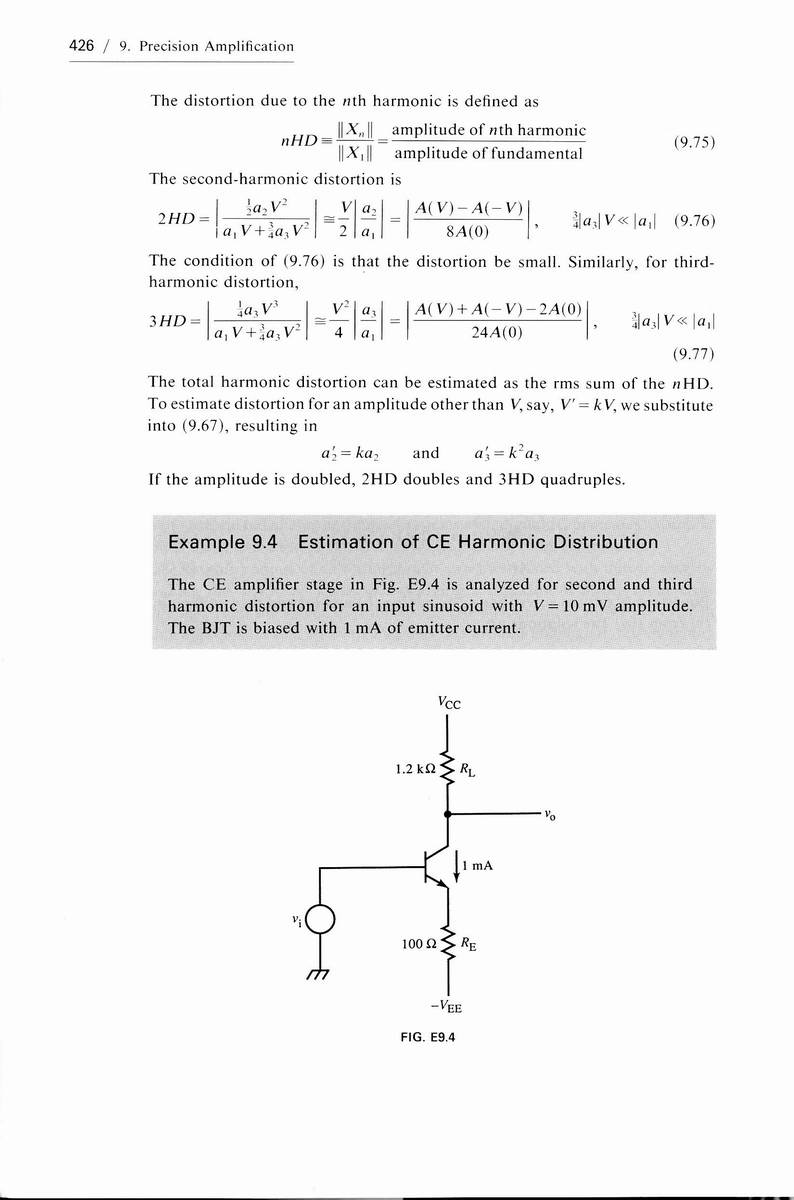

Now to page 426. There we find the found expressions for HD2 and HD3, in terms of the measured gain at the three points mentioned before. Of significance here is the fact that the 2nd HD changes linearly with signal (k.a2), but the 3rd HD changes with the square of the signal increase ratio (K^2. a3). That in fact is what John C alluded to.

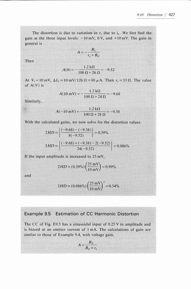

Further down that page an example is shown to put it in perspective, with a BJT CE amp stage. Go to page 427:
Page 427, the gain at zero-crossing is calculated: Ie = 1mA, and the gain is -9.52. Now we go to max signal by increasing Vi by 10mV, and min signal by decreasing Vi by 10mV. This changes Ie, and thus re (which, as can be seen in the gain equation at the top, is of course the cause of the distortion). The gain respectively becomes -9.68 and -9.38. Plugging the gain values into the previously found equations gives the % of 2nd and 3rd HD. Finally, the same calculation is done with a Vi change of +/- 25mV, and it can be seen that the 2nd HD changes linearly and 3rd HD changes by the square, as was found on page 426.
Well! That was fun, wasn’t it? What is the conclusion we can pull from this:
1 – You can indeed calculate distortion from inspection of zero-crossing, max and min amplitudes on a scope, although with very low THD I suspect it will get difficult and inaccurate;
2 – In a given amplifier with a given non-linearity, doubling the signal amplitude doubles the 2nd harmonic, but quadruples the 3rd harmonic! (You get even worse figures for higher order harmonics, I would suspect). That means that the THD spectrum of such a stage changes dynamically with the signal level. It’s like having a different amp at each signal level!
3 – John C related this to the amp gain, stating that at a gain of 28, the distortion of the input signal would be the square (784 times). It seems he makes the fundamental error of mixing up the incremental gain changes due to non-linearity, and which are responsible for the described effects, with the static mid-signal gain of 28. If that mid-band gain varied with max and min signal level between, say, 27.3 and 28.6 at a 1V input level, you can use these values to calculate 2nd (0.58%) and 3rd (0.015%) HD , and THEN say that if you increase Vi to say 2V, the 2nd will double to 1.12% and the 3rd will quadruple to 0.059%.
