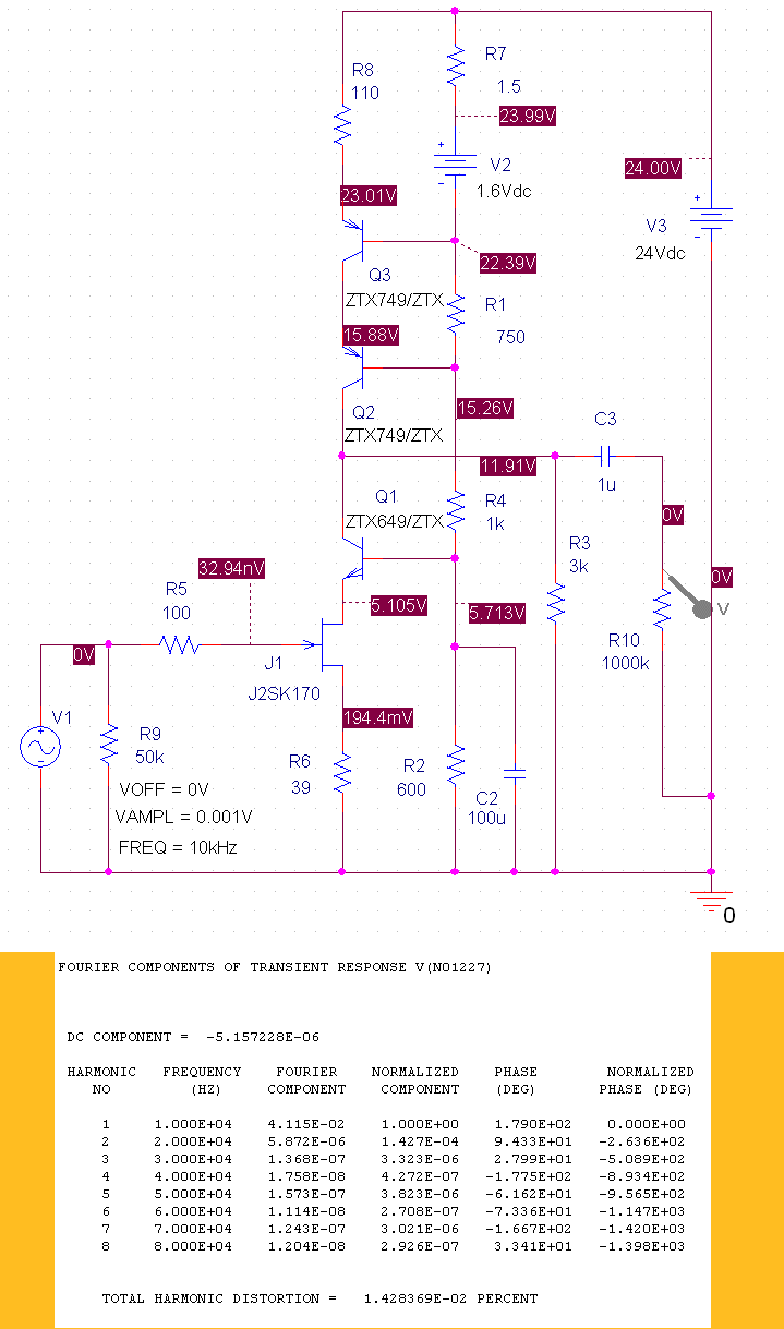

Having followed with interest Salas's "Simplistic" thread, I am interested in getting feedback on improvements I could make to my battery-powered, JFET-based 'Muse' phono stage.
This started off as the MM "Le Pacific" circuit published in a late-80s 'Silicon Chip'magazine ... but after several revamps has turned into quite a different circuit (also different to the Simplistic! 😀 ) with, for v4, 58dB of gain. Each version has sounded better than the previous versions (which I have sold off to friends) but I'm interested to see if it can be made to sound even better. 😉 (v4 was compared to a Brinkman 'Edison' and, sure, it wasn't as good ... but not by much! 😀 )
I have attempted to model it in LTSpice, to get an idea of the distortion profile - but haven't been able to get very far. :sad:
Anyway, attached is the circuit.

Normally, butting one current source (a jfet) against another is not a good idea. In this case, the gain resistor acts as a"pressure relief valve" and yields a practically realizable circuit. The concept is interesting. A few comments:
1) The combined impedance of the input jfets and bipolar current source will be considerably smaller than 50M, more in the region of a few 10s of k, and dominated by the bipolar current source. I took a peek at the data sheet for the 2SA1142, and there is no data for the hoe, but this should be pretty low anyway, as the transistor is supplying no less than 4 fets - the output impedance of a transistor generally goes down with increasing collector current. However, this is the sort of error that can be trimmed out by testing with an inverse RIAA network and adjusting the load resistor. The error can also be reduced by cascoding the input fets and current source.
2) The Pearl preamp used 4 paralleled jfets for lower noise, but it also cascoded those fets to avoid the cumulative effects of the Miller capacitance.The Grado cartridge you mention using, if it is like the other products in their line, is a moving iron design with relatively low inductance, and a tolerance of a wide range of capacitive loading. Other moving magnets cartridges are less tolerant, and the cumulative capacitance may make it impossible to properly tune a less tolerant cartridge. Cascoding at least removes the Miller capacitance from consideration. Depending on your operating drain voltage, cascoding the input jfets is also a good idea as you can keep the drain voltage below the point at which gate leakage takes off exponentially. At 8V VDS, the 2SK170 is already in this exponential gate leakage region (it shows up in the specs), probably due to the large area gate required for its high gain, low noise specs.
3) The Pearl and Pearl II circuits use individual source resistors for the paralleled fets - a good idea, as it evens out any residual mismatch between devices, even if it does add a little noise. I noticed that the paralleled fets don't have any gate stoppers, a situation that may invite oscillation - if you don't use gate stoppers, you should at least check for oscillation with a scope or by using an AM radio as a sniffer. The Pearl and Pearl II circuits appear to get away without using gate stoppers, but I'd still check.
4) Using all those fets for low noise and then using a relatively high impedance RIAA network ? You have the possibility of rearranging the circuit to place the RIAA network directly across the gain resistor, as it is being fed by two current sources anyway (R1 goes away). I've used this scheme with a folded cascode stage, and it works. Given the value of your load resistor, the capacitor values would be somewhat enormous, but this serves to help swamp out the effect of strays. It's something to think about, anyway.
Aah, I did not know that the CCS would reduce the Zin of the JFETs to a few 10s of Kohms - thanks. Is there any way to increase it back up to, say 1 or 2 Meg?
I'm thinking the outcome of the present circuit is as follows:
* on the 1st gain stage, this low Zin will be combining with the 47K "cart load" resistor to deliver something a lot lower than 47K to the cart? So I really should increase the 47K to, say, 100K?
* on the 2nd gain stage, the low Zin will reduce the 806K R0 to something much lower ... so the 2nd gain stage will not be loading the 1st gain stage optimally? So I should increase R0 ... which will of course change the RIAA values.
The current going through the 2SA1142 is about 28ma. The 1st gain stage deliberately has a fixed Gain resistor (as this sets Zout and so affects the RIAA calculation); what I do when setting up the values of the pots is:
* adjust the Source res so the current flowing through the JFETs is around 80% Idss (so 20.4ma for these 4 JFETs).
* then adjust the CCS res so the Drain voltage is half supply.
I'd be grateful if you would explain what "cascoding the input jfets and current source" involves. I have heard of the term "cascoding" but I don't know how to set this up. 😱
What are "gate stoppers"?
I did get oscillation in v2 of the circuit (I could see it on my 'scope) - which I was able to cure by putting the 100pF cap across the input.
The original Silicon Chip circuit is attached below. That was my v1 ... I simply kept making changes which various luminaries suggested, over 4 years - and listened to the result - to arrive at the current v4 circuit.
As you can see, it had a passive composite RIAA network between 2 gain stages ... so I simply kept with this concept (and it's one favoured by the "valve guys"! 😉 ).
I would be most interested in how to "place the RIAA network directly across the gain resistor (removing R1)".

Until I get back to this, I would suggest doing a little homework on cascode circuits. Start by searching inside the Simplistic thread started by Salas, and then by doing a search on the web in general. This should answer a few questions, and maybe generate a few more. Nelson Pass in particular had a nice little article on cascode circuits that appeared in Audio magazine in the late 70's. I found it quite illuminating back then. A search for "Nelson Pass cascode" might dig up that article.
Here is a simulation of this topology using a single jfet, with both the jfet and current source cascoded. I tweaked the gain to a value I'd use for a MM RIAA input stage, 40X. The THD is similar to that seen for a simple cascoded jfet common source amplifier, and is higher than that seen for the simulations I've done for a folded cascode RIAA input stage. The THD looks ok, but what I find a little disturbing is that the higher order odd harmonics (3rd, 5th, 7th) are pretty constant in amplitude, even though they are fairly decently suppressed as compared to the 2nd harmonic contribution. This might be remedied with more tweaking, but maybe not as well. When I have some more time, I'll look at the basic circuit without cascoding, though I expect that the THD will be similar to the cascoded version.

After quite some study of this in the past 10 weeks or so, I'm afraid I still cannot reconcile the circuit you simulated against my circuit? It seems to me to be completely different ... so what relevance does its distortion profile have to mine? 😕
Now, I can understand your point about cumulative Miller capacitance being a baad thing for mm carts. So if "Cascoding at least removes the Miller capacitance from consideration" ... then I would like to know how to cascode those 4 FETs in my 1st gain stage. (I've searched the Web for cascodes - including trying to find the Nelson Pass article you alluded to - but I can't find anything that I can understand. 😱 )
And you commented "I noticed that the paralleled fets don't have any gate stoppers, a situation that may invite oscillation". I certainly didn't notice any oscillation when I tested it before assembling it into the case - and subsequently listening to it - but, strangely enough, a subsequent audition at a friend of mine suggested that we heard oscillation (and when I took it home and put the 'scope on it, I could see multiple dancing sine waves - which tell me that it is unstable).
So I am about to take it apart to install 100 ohm Gate stoppers. 🙂
And WRT "You have the possibility of rearranging the circuit to place the RIAA network directly across the 1K54 gain resistor (R1 goes away)".
Do you mean leaving the 2 x RIAA "legs" as they are but simply removing R1 (47K)?
I thought an essential design criteria for this "passive RIAA sandwiched between 2 JFET gain stages" was that the Zout of the 1st gain stage (which is 1K54) needs to be 1/20th to 1/30th of the following impedance. With R1 there (47K), this requirement is satisfied ... without R1, surely it is not?
