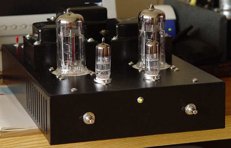

Friend of mine recently had constructed a 6C41C SE amp, and he wants to start a group buy of 6C41C kit locally. He said the result was excellent! The doubt of rough-sounding for 6C41C is totally eliminated, and the HF is delicated with transparency.
I think if there's any one interested in, contact me or leave a message in this thread.

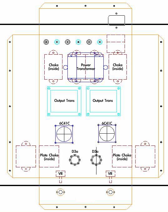

As far as I know, the amp is 2 stage.
First stage is Siemens D3a, triode connection, loaded with choke plate.
6C41c is biased by mixure of self-bias and fixed-bias.
Hardwiring. CLC filtering.
The opt are carefully made.
Output power: 6W@ 17Hz to 23KHz +-1dB.
1W@33KHz +-1dB
cheers
Lin:smash:

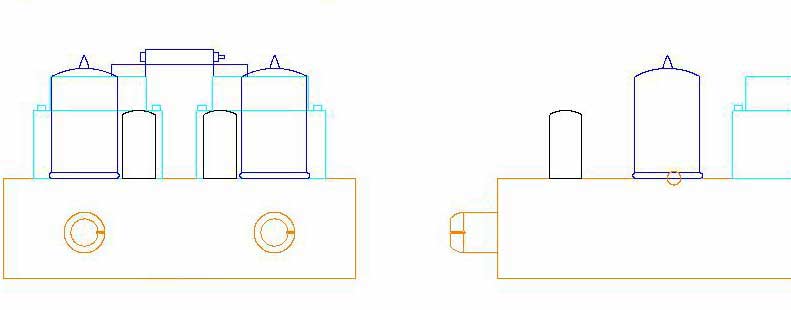

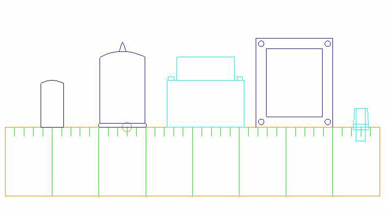

The case is designing......Not sure of the material.....
