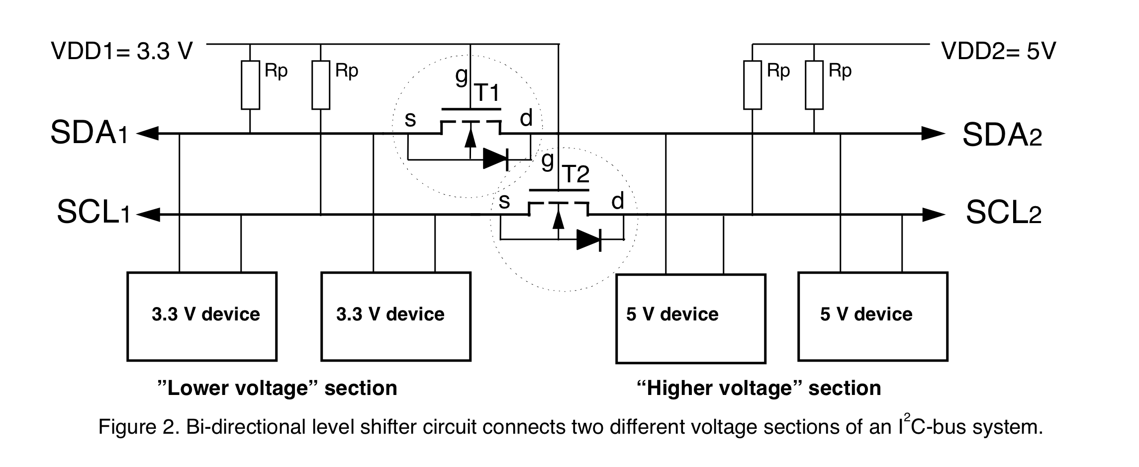

If nodemcu is 5V tolerant (it seems to be - there has been some discussion about it on hackaday), you can just pull up the SDA and SCL to 5V with resistors. Note that the pull-up resistors are not designed into the volume control board.
If nodemcu is not 5V tolerant, then the pull-up has to be to 3.3V, and it may or may not work with the 5V powered PCF8574. The datasheet says (page 16) that the minimum HIGH level input voltage on SDA and SCL is 0.7Vdd, which would be 3.5V for 5V Vdd. It might still work though.
In case it doesn't work, you can always make a level converter with two N-channel MOSFETs and four resistors as in the attached schematic, borrowed from Philips Application Note 97055, "Bi-directional level shifter for I2C-bus and other systems". You can also use one readily available from the usual sources, such as SparkFun, Adafruit, eBay, or Velleman.
Or you could power the PCF8574 and from 3.3 volts and use 3.3V relays, but that may exceed PCF8574's current limit when all relays are engaged, as 3.3V relays generally need more current than 5V relays.
