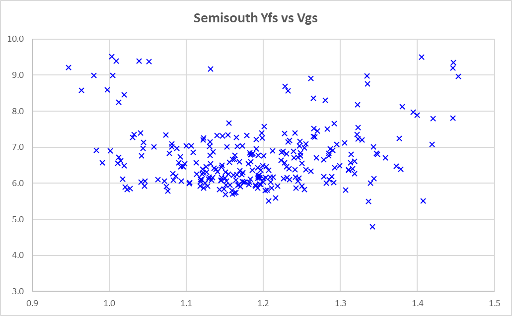

Matching Data
Here is the matching results of about 2/3 of our stock.
So still 1/3 to go, probably till early September.
The plot shows transconductance (Yfs) vs Vgs at 1.25A and 55°C case temperature. Vds 24V.
As you can see, the production consistency is poor and the data spread is all over the place.
If we have the same number of Toshiba FETs, we would have had quite well-matched quads for both Vgs and Yfs.
But not Semisouth's.
We shall have no choice but to give priority to Vgs match (probably ~10mV), with say 10% Yfs match.
And there will be very few quads and probably mostly 2 pairs (mainly due to Yfs mismatch).
And reject rates will be much higher than we expected.
Patrick
Patrick
I bet the property of this sans with Pass' implementation, even without superduper matching, will be something special.
So sticking to 10mV Vgs and 10% Yfs as matching criteria (in most cases well below), we have a yield of :
49% for quads
31% for pairs
20% for singles
Using the same percentage to apply to the entire batch, we shall probably get :
50 quads
33 2-pairs
We should be able to supply everyone, worst case with 2 pairs.
And those first on the list are given priorities for quads.
Patrick
