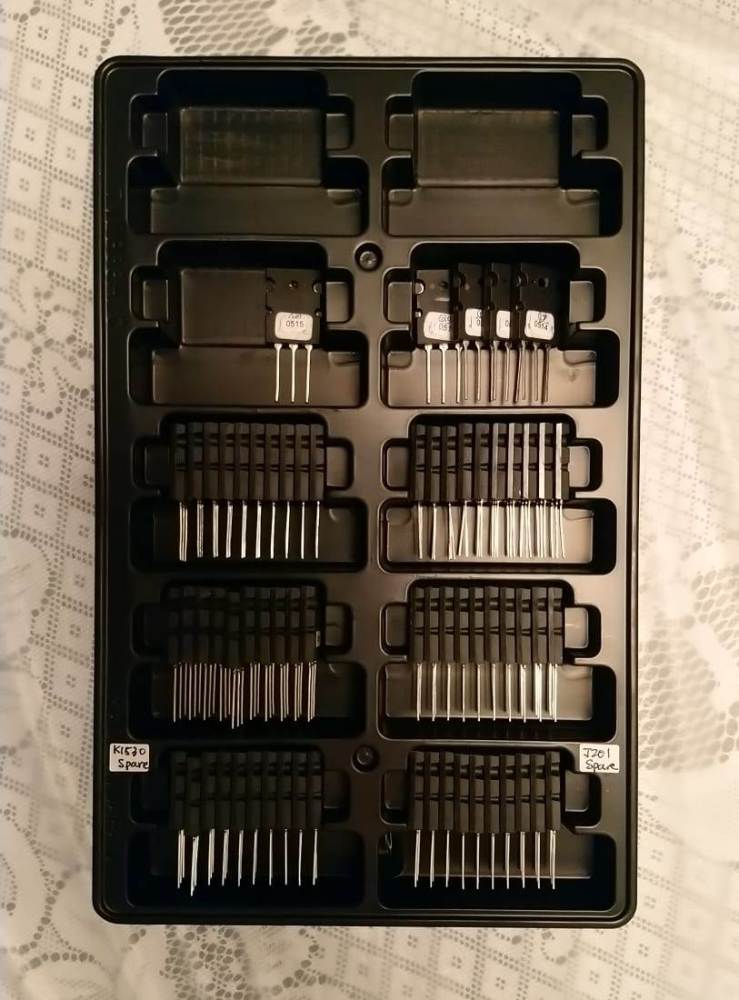

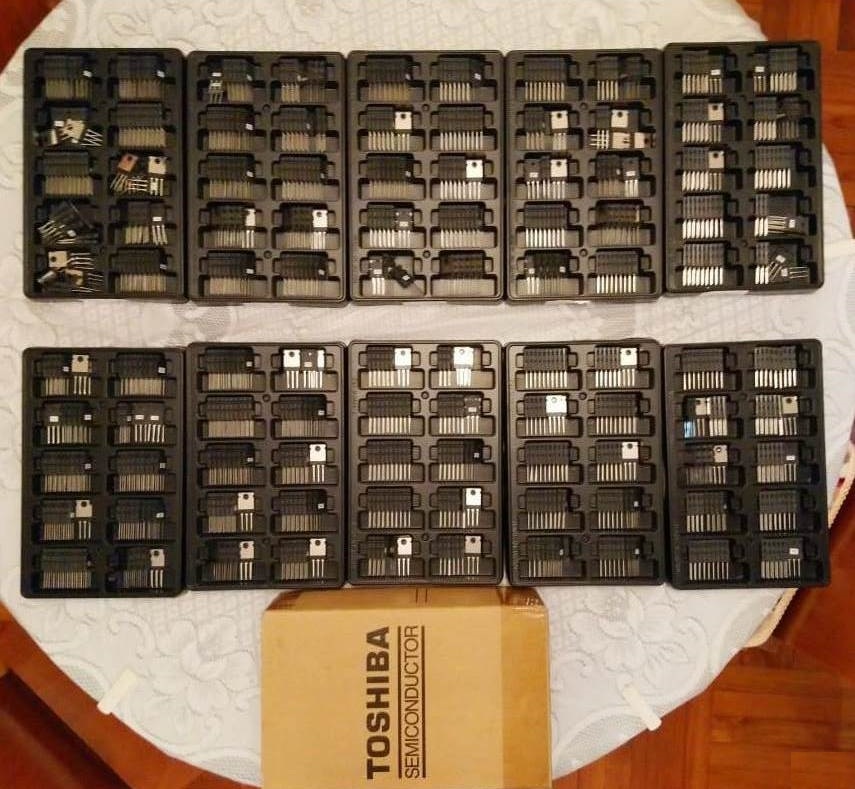

Some photos to show progress.
All the MOSFETs have been sorted for the project(s),
Some 60 matching rejects from 1000 FETs, after sorting (and packing) for octets, quads and (C, N or P) pairs.
2 persons, one entire working day.
Patrick
Patrick
