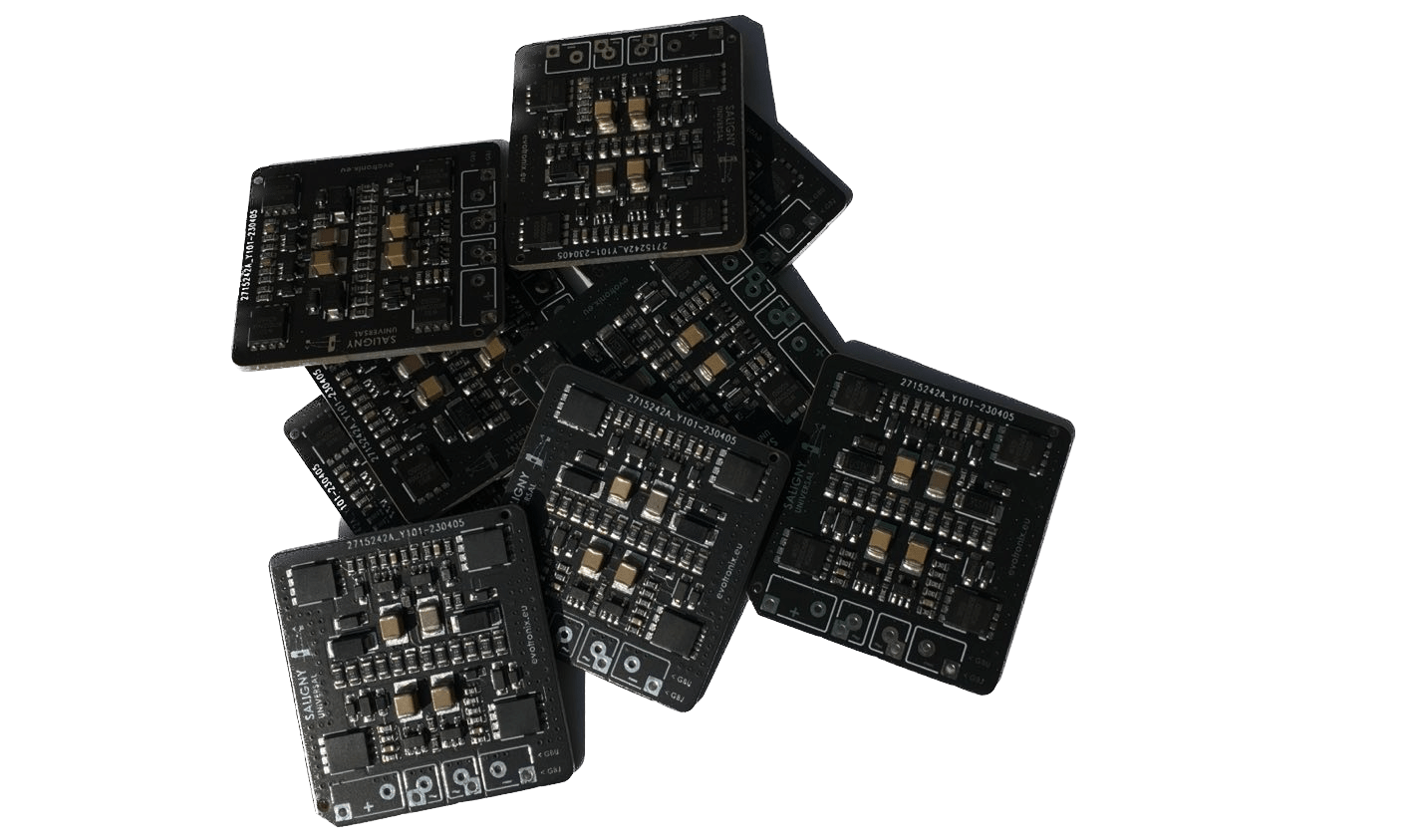

This is to evaluate and promote interest in our latest synchronous rectifier design.
Saligny Universal is a discrete design that extend synchronous bridge capability in voltage, current and phase. Therefore high voltage, high current and 3Phase or multiphase is possible.
Another great feature is that compared with LT4320 versions, Saligny Universal support centre tapped transformer. This make possible drop-in replacement in many audio applications.
Saligny Universal will be available starting with April 2023 and price will be lower than current Standard.
Saligny Power GaN is based on a similar circuit design, but aim at very top performance in industrial&professional applications that require exceptional electrical performance.
Saligny 3Phase will follow shortly. Expect around June to be available on webstore.
Saligny Multiphase is currently on workbench and main application will be electrical vehicles.
More info on https://evotronix.eu/main/
Please indicate if you intend to use Saligny in your next project and which one.
Thank you !

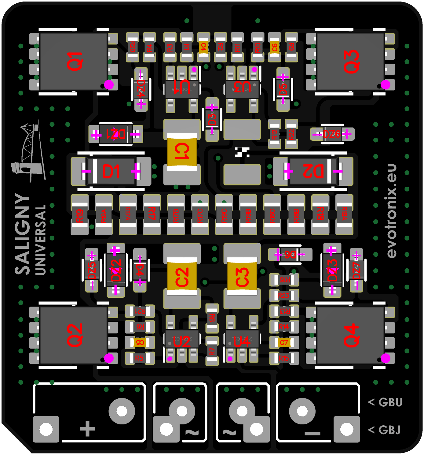

I have a build or two that I would like to put the Saligny Universal into (would be greater than +/- 40Vdc). Problem is footprints between existing rectifier bridges and the Saligny Universal. The hole to the left of the positive leg doesn't look plated so I assume I can't move a pin. Other options would be to bend legs I suppose.
Are there any thoughts in making an option for footprints? For my personal needs, the GBJ package footprint would gain more mileage without needing to bend pins or anything.

Good eye. It would be best if it were compatible with this:
https://www.mccsemi.com/pdf/Products/GBJ50005~GBJ5010(GBJ).pdf
Pin distance between (+) and AC is 10mm, pin distance between AC to AC is 7.5mm and AC to (-) it is 7.5mm.

Thank you for feedback. Saligny Standard and Universal match GBU package with ˜5mm distance between pins.
Will see if is possible to add holes for GBJ too.

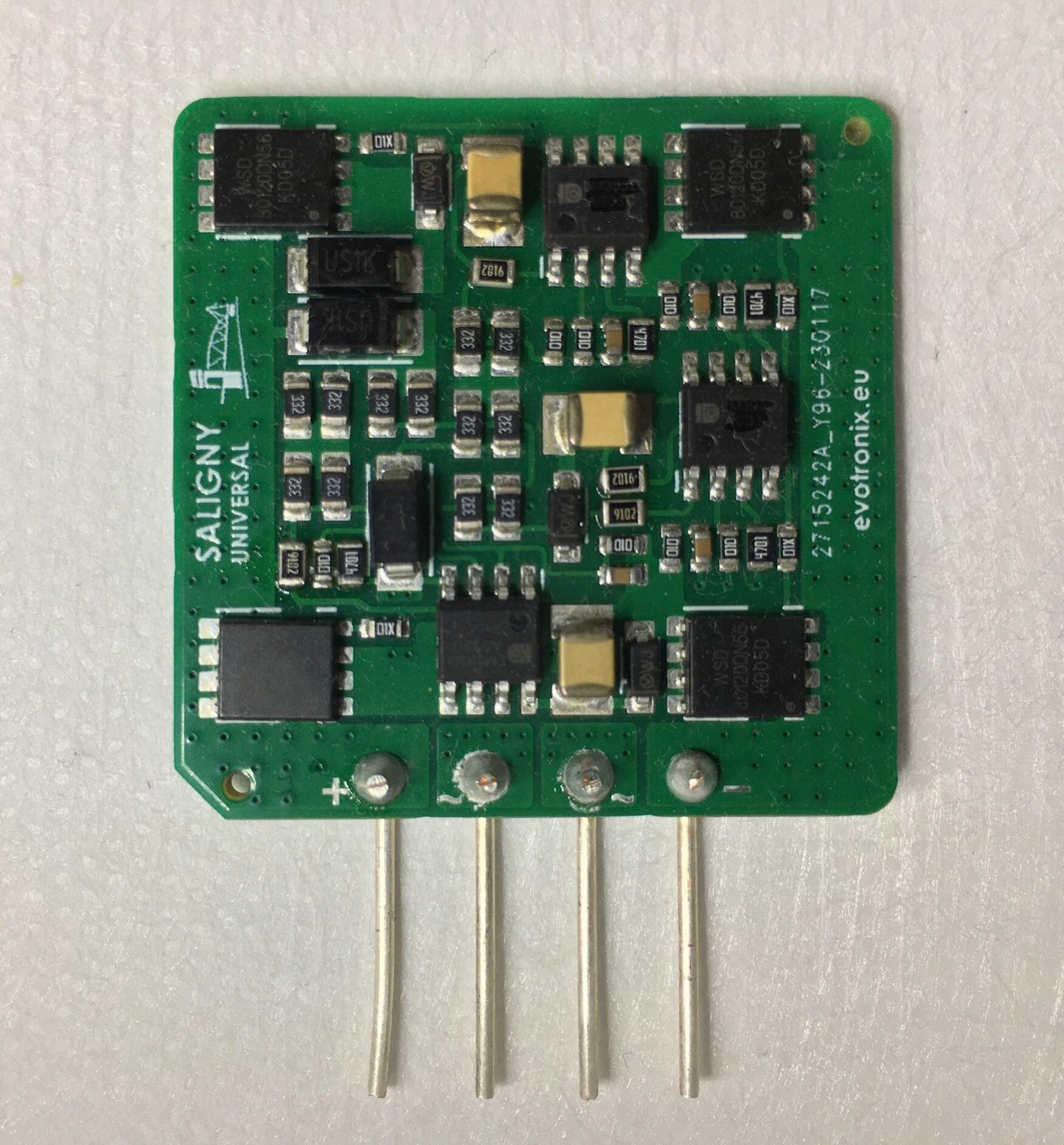

Hot damn, that looks like a full custom design with LM393 comparators and WSD80120DN56 MOSFETs.This is the first production batch and I'm confident that will surpass any LT4320 rectifier.
That should rectify highest audio frequency if necessary, not only meagre 600 Hz as LT4320. 👍

Saligny Universal will be available @ https://evotronix.eu , starting with Monday 24.April.
The batch is small <100pcs, but more will follow in coming weeks.
Please note that for this batch absolute maximum input AC voltage is 60Vac. This mean you may use this bridge up to 80Vdc or +/-40Vdc on output.
Higher voltage will follow on next batch, up to 110Vdc or +/-55Vdc on output.
Price is 39.9Euro ex. 19% VAT and paypal taxes.
