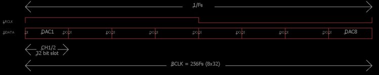

I am looking to use an XMOS board (MiniDSP MCHStreamer or DIYHK Multichannel XMOS) to output 16 channels from my PC using TDM16 protocol. From there I will use E-APO for 5x 2way active system.
Now, TDM16 only requires one cable for interconnecting, right? So on my XMOS board I will only have 1 cable (plus other 3 for clock) for connecting to a DAC, DSP or CODEC.
My question is, what happens If wanted to connect the TDM line to a DAC board like the chipdip.ru PCM5142 (PCM5142 audio DAC с miniDSP, Преобразователь: I2S - Аудио. 2 линейных выхода = 2В RMS, 384kHz/32bit, DirectPath™, Электронные войска | купить в розницу и оптом) where I only have one pin for TDM input? how do I connect the other 15 DACS? Is it possible?

You'll probably need a buffer that will mirror the 4 lines to max 8 DACs (16 channels gives you 8 stereo pairs) and you'll have to make sure you can program the DACs to select the channels for each one if the DAC even supports more than 2 channels in the TDM stream. I did not find such registers in the pcm5142 datasheet and their TDM graphs show only 2 channels.

You have to create a TDM daisy chain using the DIN and DOUT pins of the dacs.

And, how do I make a TDM daisy chain connection?
Use the DIN for input and the DOUT for output and use PurePath Studio to choose TDM - Daisy Chain - and select the correct channel?
