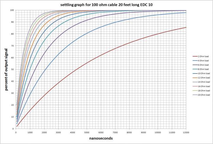

take a hot amplifier, a single driver 8 ohms, and let's build a constrained cable 10 meters long with a characteristic impedance of 8 ohms using a dielectric with a relative permittivity of 3. (edit:almost forgot, make the inner core a braid as well, to remove the 15 nH per foot from the fray) (note that my avatar is the magnetic field intensity of that double braid coax)
The cable will have a capacitance of 220 pf/ft, and an inductance of 14.1 nH per foot.
The total cable capacitance will be 32.8 feet times 220, or 7223 pf, total inductance of 462 nH.
Some amplifiers will have trouble driving this load, we all "know" why. The capacitance loading at the output.
However, if I replace the driver with a pure 8 ohm load, what happens? The amp sees a pure resistance and does not oscillate.
A rudimentary cable model does not predict this.
The reason? The speaker unloads where the amp needs the load the most. edit: and when the load impedance is larger than the cable characteristic impedance the cable takes on a capacitive nature. When the load goes below cable z, the cable takes on an inductive nature..
It is very important to use a model which is as complex as it needs to be, as well as as simple as it needs to be.

If I purchase a kilometer of 50 ohm coax...and cut a 10 meter length, what is that length's characteristic impedance? How does it's length impact system settling time in the audio range? When an amp changes the signal, how long does it take for the load to fully "accept" the change? The settling time is dependent on the mismatch, the prop speed, the cable length, and the epsilon of the dielectric.
Scott's wavelength reaction is right out of the textbook...t-lines are not relevant for audio in normal lengths.
I keep mentioning system settling time..humans are capable of 2 to 5 microsecond ear to ear differential sensitivity, so I find t-lines useful here.
I would have thought that the standard formula for calculating input impedance from load impedance and cable impedance would predict exactly this. As you say, raise the load at the far end and the line looks capacitive. This is exactly what the formula predicts.
Exactly. Same result, different formula...I don't see a problem here. If my approach produced a different result, that would indeed be a problem.
My approach shows the system settling time cusp very clearly, and conceptually my approach affords a much more intuitive (to me) look at the system.
Could you specify what you mean by a rudimentary model?
One which neglects information which is needed. By neglecting L, one obtains a cable impedance for a short cable segment that differs from a long one. For LF audio this is a reasonable assumption, but it becomes less intuitive as the speaker unloads..
Cheers, John

As I said, characteristic impedance does not depend on length. Length does affect settling time, if by settling time you mean the elapsed time after a change before the transients from that change have reduced to some fraction of the original change. If you are talking microseconds for ear-ear differentials, then all you need is that the cables are similar lengths.
It sounds like (reading between the lines of your unspecified method) that you are simply using a time-based method, which at audio frequencies gives the same result as the standard transmission line formula. So what? I thought you were criticising the standard method. All you are actually doing is making life harder for yourself. Unlike most engineers, you seem to be refusing to use an approximation in the region where it is valid.
For any reasonable (short) length a loudspeaker cable can, for audio frequency purposes, be regarded as a resistor with some shunt capacitance. The shunt capacitance has little effect at audio frequencies, but it may create phase shift a bit higher up and cause instability for some marginal amplifiers. You can regard the speaker cable as a mismatched transmission line if you wish, but it is easier to just treat it as an RC network. Part of the skill of engineering (and science) is to pick the appropriate approximation, as you said in an earlier post. If you prefer to use a harder one then you do more work, and are likely to make more mistakes, and there is a danger of a nice warm glow as you use a more sophisticated model than ordinary mortals.
No, unless by 'cable impedance' you mean something other than characteristic impedance. Characteristic impedance does not depend on length.By neglecting L, one obtains a cable impedance for a short cable segment that differs from a long one.

Nope. My method is indeed time based as you surmise. However, when the load varies it's impedance, the settling time at different frequencies will be different. This impacts image localization.

It's far easier to use, it shows how the load impedance alters the settling time, there's no real downside to it.
Cheers, John
And as long as the channels are symmetrically wired (which is the case 99% of the time), there's no differential. Sorry, I'm not buyin'.😀 It's possible (I think unlikely, but possible) that under very tightly controlled circumstances using very specific test signals that MAYBE someone could perceive a difference of 5us of differential delay. In a room, with speakers, no head restraints, and using music? I'm far more skeptical.
For a centrally located image, you are absolutely correct. So for mono, I concur.
Any image which presents off axis with respect to a central image, delaying part of the spectra will shift part of the image spectra off the fundamental image location.
I've attached one graph, I had to copy it from another forum, as I can't find the orig at this moment...
Cheers, John
