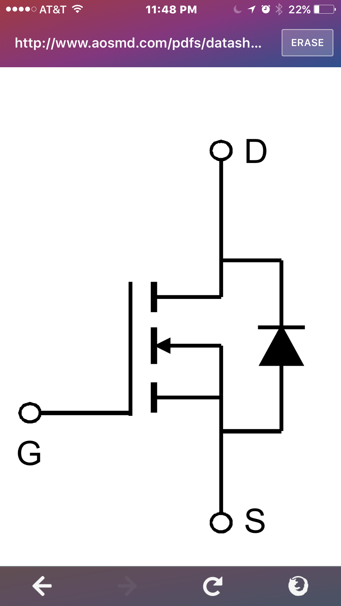

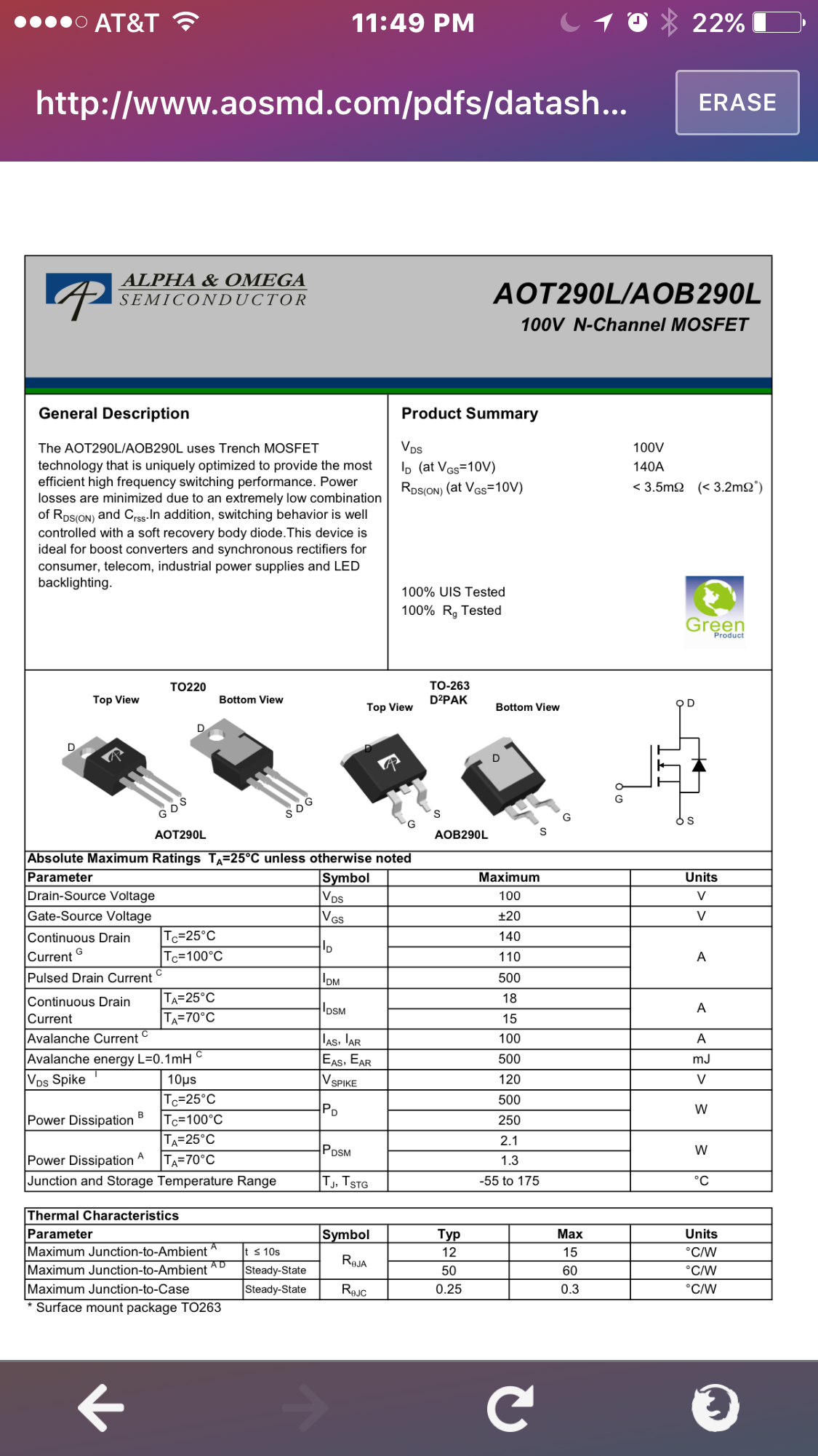

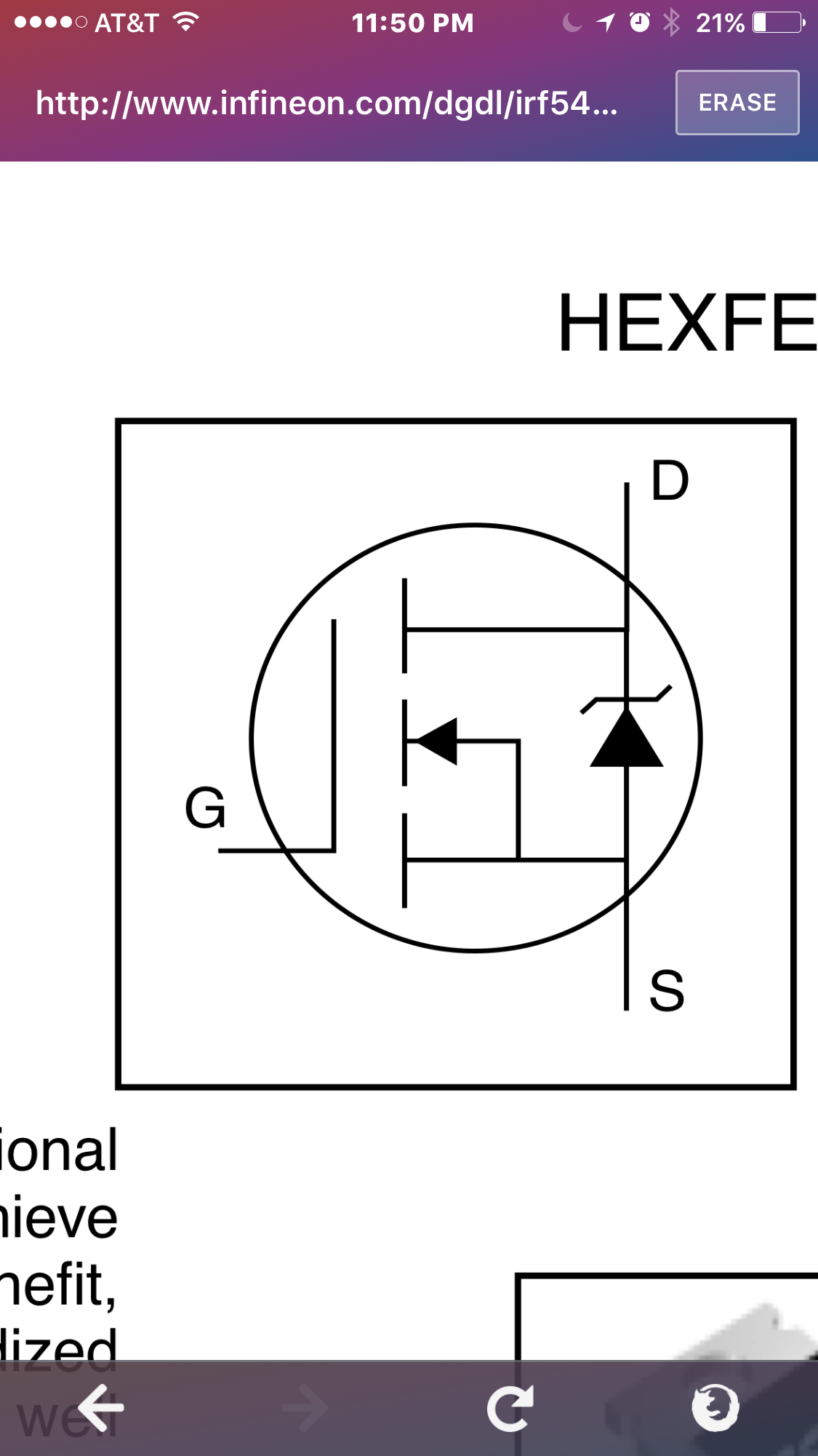

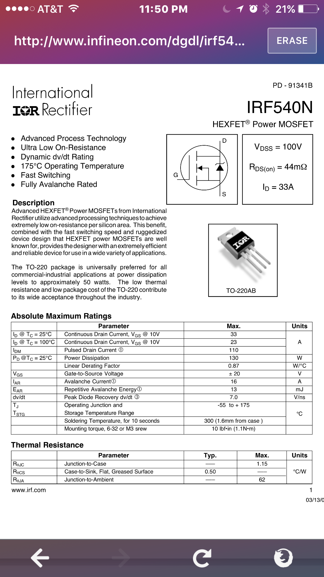

Can two N- Mosfets with pretty close specs be interchanged. The main difference is one uses internally or it's symbol shows a regular diode across Drain and Source, instead of a zener diode? What will happen when swapped? What will also happen if a lower spec N-Mosfet is upgraded to higher numbers/specs such as below part#s?
Ex.: Irf540 drop swap with AOT290L

The die size difference between these two parts is rather large, shown by the disparity in the power dissipation specs. So with the higher current part come much higher capacitances, which in a switching application will most likely be significant.

The reverse connected diode is simply an unavoidable function related to the construction of the FET (although it can be useful and thus made use of in some applications as it can handle high currents).
IRF540 and IRF540N are also different devices. IRF540 alone covers many different devices (significantly different capacitance specs along different manufacturers). So what we are comparing to what? And for what aspect?
AOT290L has big input capacitance but negligible feedback capacitance. Qg total is not significantly larger than one of the IRF540N. Telling "much higher capacitances" is simply not true.

If you change the FET (characteristics, different capacitance, the AOT290 got the 5x the input and output capacitance) you can mess up filters and feedback, the needed dead time (like abraxalito already mentioned), the rise and fall time (on/off) is important, if the dead time is too short, the FETs have to cope with much higher currents and losses, the power supply is put under strain ofcourse then too.
You might put a lot of stress on other components, like the driver IC or the output filter, power supply or cause phase change.

Interesting - so how to know what the breakdown voltage is when its not shown in the DS? Also what's the temperature coefficient of the breakdown voltage?
Almost all MOS-FETs (lets say 98%) have zener diode integrated on chip and it's breakdown voltage is slightly above maximum rated voltage of device, for example 50V MOS-FET have zener around 55V.
I didn't test those breakdown voltage vs temperature but I guess that is projected on such way that for full specified temperature range breakdown voltage will not drop below maximum specified working voltage of MOS-FET.
Without such zener diode, many DC/DC converters will never reach working life longer than few microseconds, they protect MOS-FET from over-voltage spikes, mainly caused by driving heavy inductive load.
Thanks for that - as designer though I'd not want to exceed the rated voltage of the FET in the DS so I'd use an external device to limit the maximum drain voltage. Allowing voltage excursions above the rating (to 55V for a 50V FET as in your example) must surely have some impact on long term reliability?
