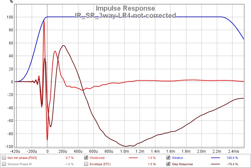

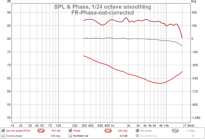

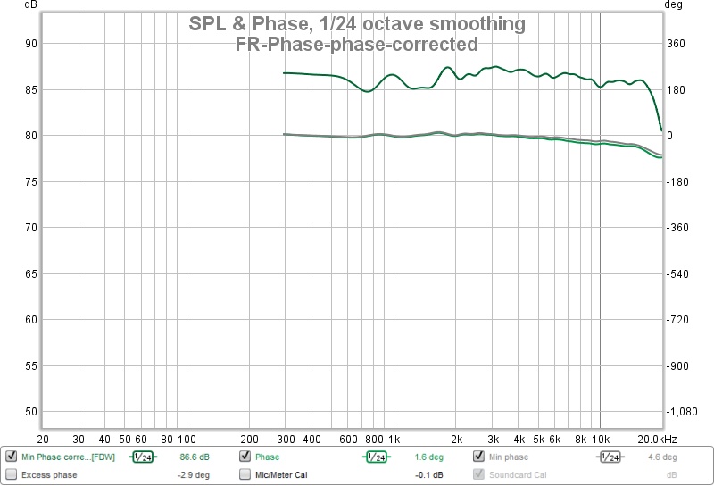

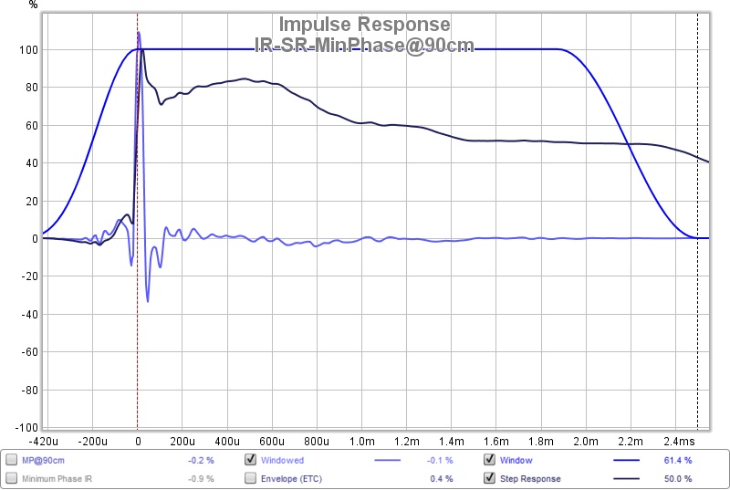

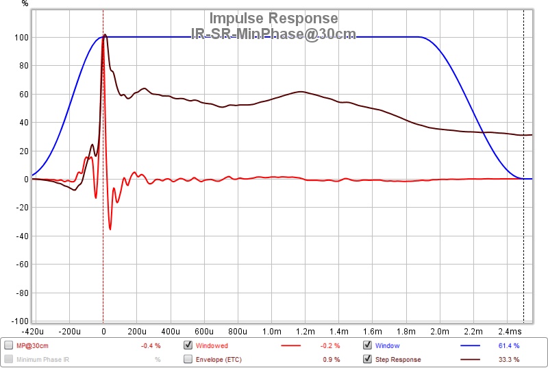

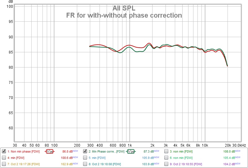

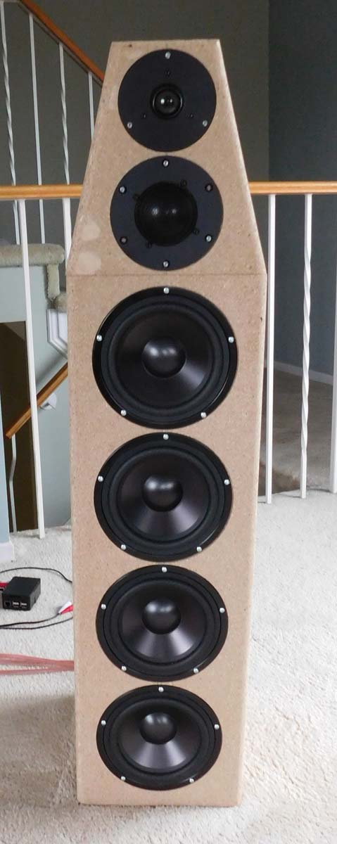

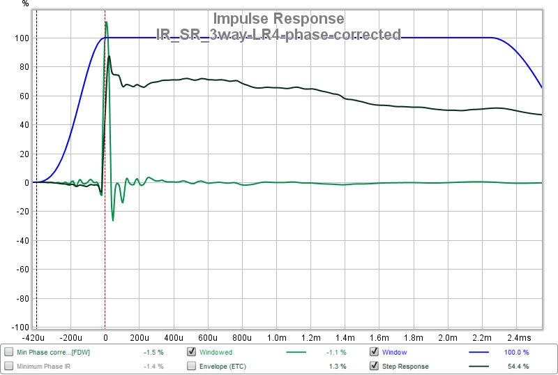

Just to put a few pictures to the words. This is an active 3 way using LR4 XO that I'm currently playing with. The phase correction overlay can be switched on/off with minimal effect (1.5dB) on the FR magnitude. The measurements are at 1m out and midrange height with gating and FDW. It is hard (for me, YMMV) to tell the sound difference between the two.
Pic#2 - compare FR magnitude differences for on/off phase correction
Pic#3,4 - amount of excess phase to correct and IR + SR responses
Pic#5,6 - phase corrected back to "min phase" with IR + SR responses

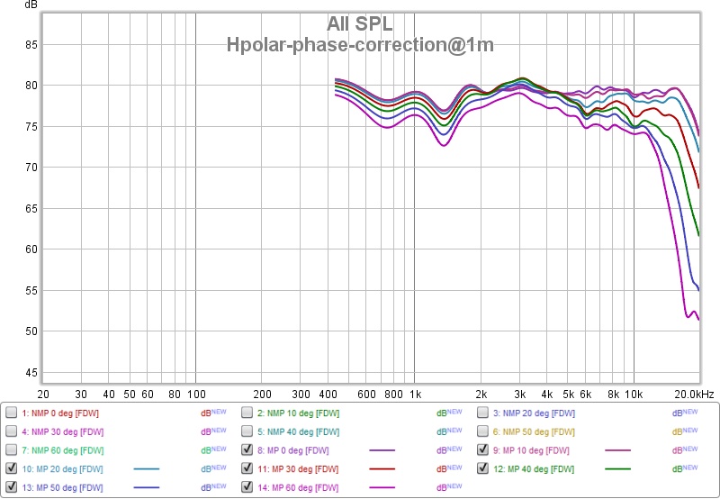

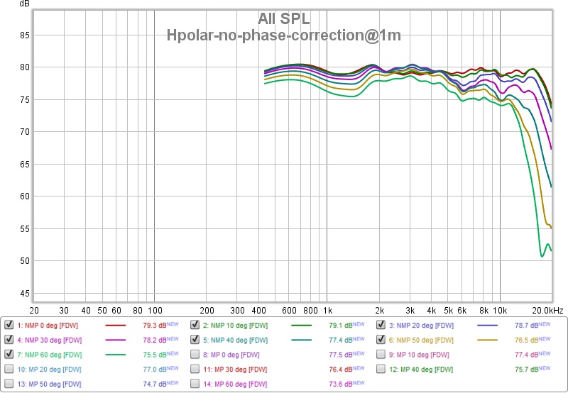

nice. can you do 0-90deg measurements with and without phase processing

Nice work 🙂
I share your experience of not hearing much/ if any difference in a phase correction overlay.
(I've used the term 'global FIR correction' in a number of past posts, to describe a phase correction overlay)
Was your overlay created using measurements at 1m?
Was it phase corrected only, or mag and phase?
I ask because i think the reason overlays breakdown is that they tune too specifically to one spot.
It becomes a case of over tuning i think.
Pretty easy to identify over tuning, just move the measurement mic a bit and see how much the near perfect impulse from the correction spot falls apart. (almost always falls apart too much with overlays ime)
I've found alternatively when linear phase xovers are used, impulse variance from different mic locations goes down substantially, vs the tuning spot.
Finding a good tuning spot via outdoor polars, or using an average of spots also helps minimize variance.
However, it seldom gives a near perfect impulse at any one spot.
In fairness to the overlay method, i guess the same polar best spot determination or using a measurement average, might be used to create the overlay and reduce impulse variance. Needs investigation i think.
I just don't see the point though, because once two drivers sum together, they are no longer minimum phase, and any correction to their summed region seems it can only be to a spot.
Anyway, the only other thing i might add is a growing wariness of using gating or nearfield measurements. Could go into why, but no doubt i've already said enough 😱
It's a PIA, but outdoor ground plane measurements are about all i trust anymore.

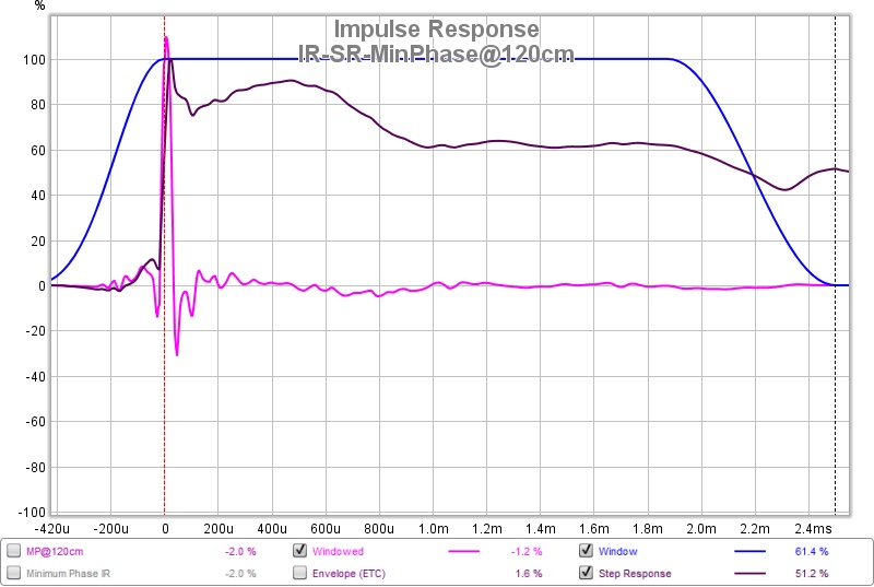

The polars (relative to axial) look about the same. The dip (1-2K) with phase correction could also be fine tuned but I wanted the exact same mag corrections for both.
Nice work 🙂
Yes, measurement at 1m and phase correction based that measurement. I have separate mag and phase corrections for this experiment. I keep the same mag correction and turn phase correction on/off.
