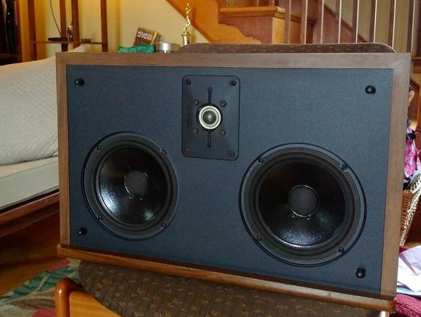

So I have few Polk sda speakers
One set is sda-crs+ that uses woofers with following specs
The other set is sda-2b. (Same speaker but with 12" passive radiator instead of 10" passive on smaller sda-crs+)
Both of these speakers have same drivers, same cross overs..only difference is 2b is twice the size and has 12" passive radiator
Sda-crs+. 10-1/8"D x 20"W x 12-3/4"H
2b. 11-1/2"D x 16-1/2"W x 39-1/2"H
Driver: MW 6503 Driver's model #.

MW 6511 1.405 4.34 N 3.496 E - 3N/M 3.13 Ohms 29hertz
I would like to boost mid-range punch. Don't really care about bass responce.
And found a driver by Polk that seem to be an improvement over mw6511
The driver that I want to use instead of mw6511 is mw6502 with the following specs
MW 6502 1.97 5.16 N 1.47 E - 3N/M 3.52 Ohms 44 Hertz
6502 is used on polks small bookshelves. Monitor 5jr. About
9x 9x 14" and it's a ported design . No passive radiator
From specs it looks like 6502 has stiffer suspension than 6511
And fes is 44hz
I would like to build speaker box of around the size of crs+ and move all components from huge 2b to sda-crs+ box. It will be a little bigger than cda-crs+ to accommodate 12" passive radiator.
My idea is to make a wall with a port between mw6502 and 6503
6502 will be a ported woofer . 6503 will be in same compartment as passive radiator. Basically this way 6502 will have a little extra suspension withing the big box. Both will still work with passive radiator. 6502 via port inside. 6503 directly.
So is this a good design ? 6502 will reside in a box similar to monitor 5jr size(9x9x14)
Also it seems that sda-2b boxes are way too big for the drivers. Is this the case?
I really appreciate. I attached cross overs of sda-2b which is same as sda-crs+
Here are pics and cross over

To make things simpler)
Will the speakers be faster, more responsive and detailed in 100hz+ range
If I get rid of passive radiator and enclose each woofer in sealed volume that is half of it's compliance volume.
Say mw6503 is in sealed compartment of 1.5 cubic feet
Mw6502 in sealed compartment of .7 cubic feet
