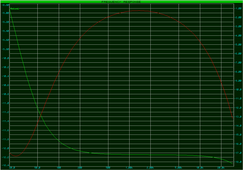

I'm trying to ascertain whether it is possible to add a low frequency boost below ~250Hz within the negative feedback loop of the Cyrus Two. (Cyrus One has an identical feedback circuit.)
Cyrus One Schematic.
I've tried to simulate the changing of each component within the loop and have also tried some practical experiments with croc clips and resistors. I stopped shortly after I added a 2u2 cap across R71 and heard some expensive sounding pulses about once every second. Ouch! I wish it was as simple as letting more bass through to ground by lowering R65 but I guess not. It is obviously a delicate balancing act even before I consider the wider implications of any alterations I make to the NFB. (Way over my head.) I'm saving up so that I can hire Bob Cordell. 😉
I'm looking for more bass overall even if it's only below 100Hz. 3 - 6dB would be great. I'll take what I can get within reason. My speakers are more than capable and the amp is powered by a beefy external power 500VA 84,000uF supply. I have built my own line level Baffle step/ bass boost circuit but I lose some transparency when I use it. (not just due to reduced H.F.)
The attached graph shows the simulated frequency curve for the original NFB. Sorry about the bad quality due to compression. I'll try to fix that if I can.

My advice would be to leave the feedback network well alone otherwise you run the risk of jeorpardizing the stability margins.
I replaced the LR network for BSC on my Jordan drive units with an RC network at the input of a Cyrus 1. A series resistor in the signal line followed by a capacitor and series resitor to ground gives a shelved response whereby the bass frequencies can be 6dB higher than the upper frequencies and the turn-over frequency can be selected to suit.
There are two existing series resistors in the Cyrus that can be used, R45 and R49 (both 4k7) so you only need to add a capacitor+resistor to ground after one of these (ie in parallel with C29 or C33). The load impedance following R45 is variable due to the presence of the volume and balance controls which will affect the filter operation to a certain extent so the better position is after R49.
Set up your simultor with a 4k7 series resistor followed by a capacitor+resistor to ground then a 75k load resistor and adjust the RC values to ground until you get the response you require. Try 100nF+4k7 as a starting point. As this is outside the feedback loop stability will not be affected.

Here's the plot with a 100nF and 4K7 Ohm.
I think, as you said Geoff, this gives the best type of shelved response. I will need to test further to find the optimum values for my setup.
