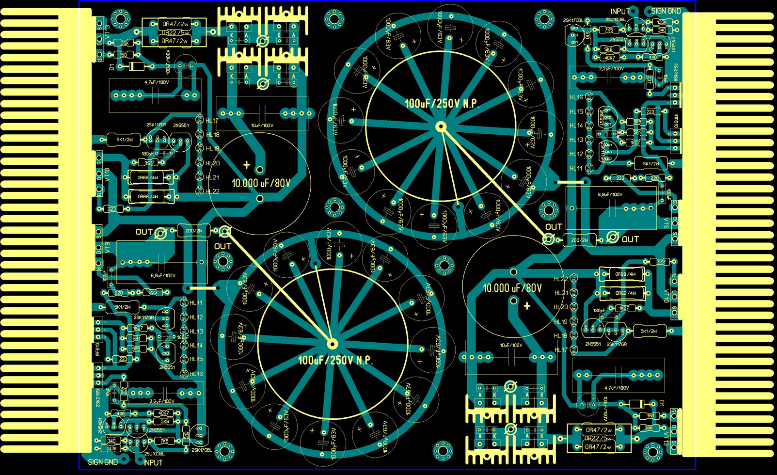

.....I have layout this schematic , may be output capacitor are not in right position , I think in circle would be better arangement . It's first atempt , I will do another PCB , I'm waiting your comments to improve , or layout something diferent .....🙂

At the moment, I have a doubt about the arrangement of film caps at the left side of PCB. The area between the PCB traces to which the film caps connected should be decreased somehow. Better to put traces close to each other, and to connect caps by individual traces.
Another rule to be observed, first the signal must pass through film caps, and after them through electrolytics. Consider 1000uF 63V Elna Silmic caps for electrolytics, if possible. You may consider to put electrolytics outside (not far from) the PCB, as a "cluster" assembly.

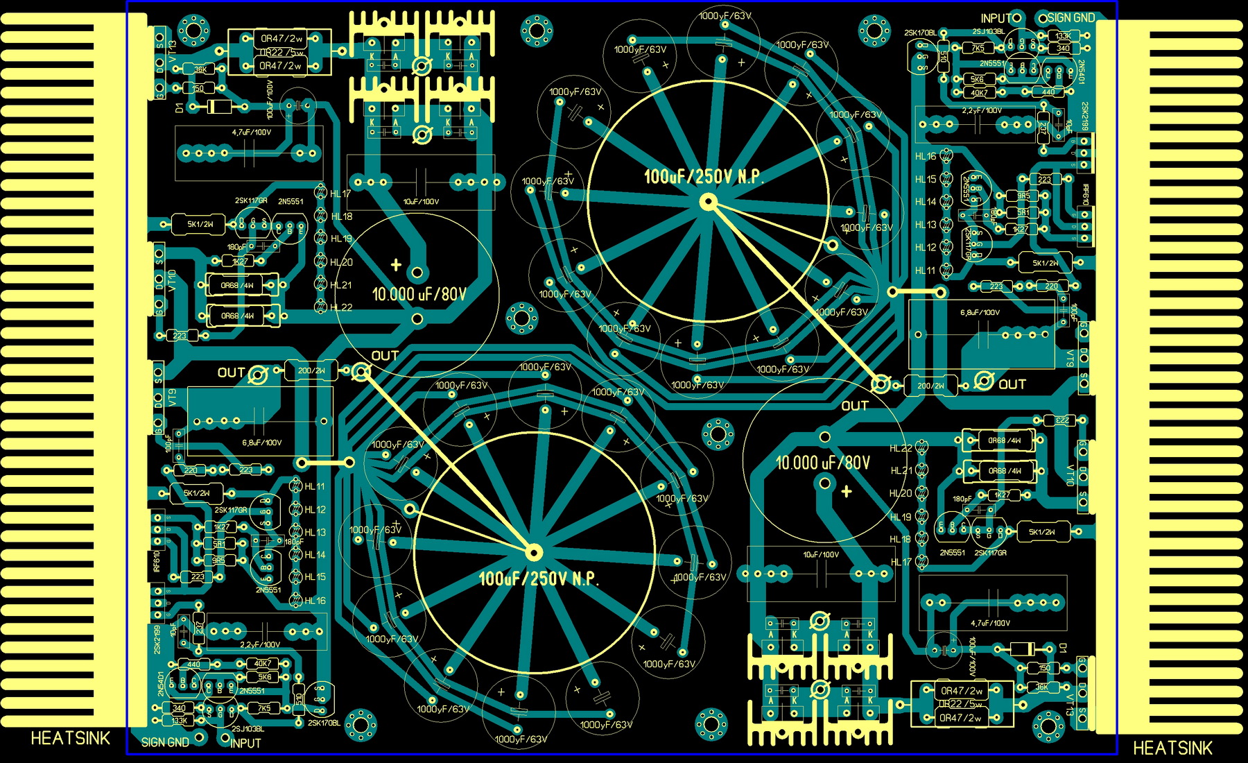

...... both channels ,on the same printed circuit ,film capacitors are mounted in the head surrounded by elytcaps , I think it's better now . 🙂

Looks nice, Alex, however, the ring-like PCB traces where "-" of all Lytics are sitting is not good, I would even say not acceptable. Better to make radial-like traces to these "-", maybe on the opposite side of PCB, similar like to "+" pins of the Lytics.
