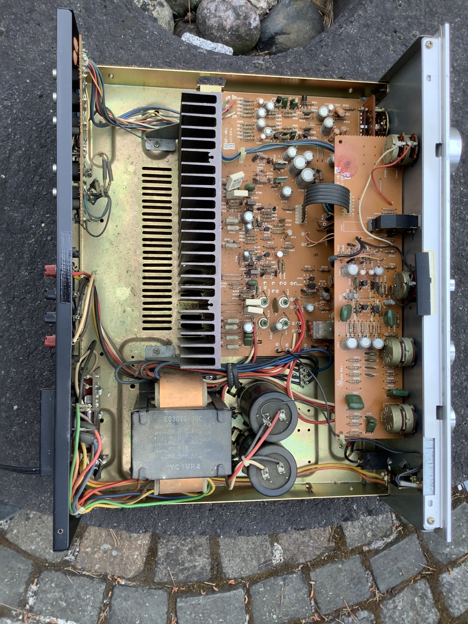

After a year has passed, it's time for a little update. This project get's way more complicated then planned, but that's the way it goes. So let's dive into the pics.
A view into the old JVC, i was surely the first one to lift the cover.
Be happy that you can't smell what I had to, this amp really stinked.
First thing to do: making a plan how to use all the in- and outputs. Endless possibilities, that was fun!
