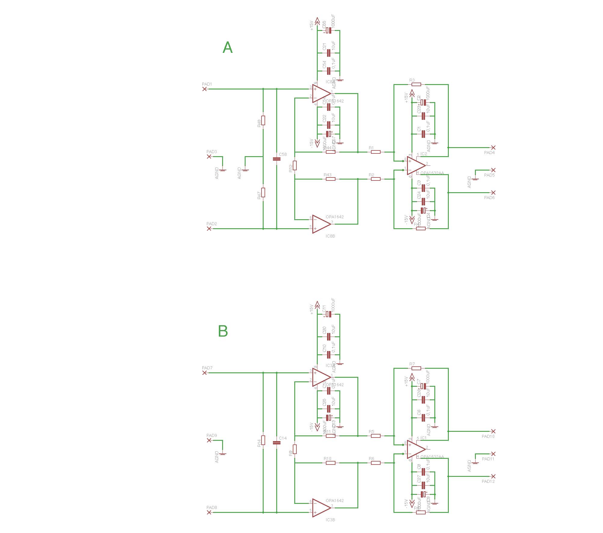

But i´m still struggeling with my instrumentation amp design, because i found no answer.
the amp should be used as the input stage in my fully balanced preamp.
below i posted the schematic and i´m not sure which version i should use.
i would tend to version "B", because the whole signal path wouldn`t have any connection to ground inside the circuit. PIN1 of the XLR connector would go directly to the enclosure. and only two caps (HF-Filter directly under the XLR connector) would go from + and - via an bias caps to the enclosure.
So, in case of "B" the PIN1 Problem should be fixed anytime, right?
and i don`t have to think about using two double relays to switch the two signals and ground, because i only have to switch the two signals, right?
because in my case, when i would choose Version "A" it would be the only connection to ground in the whole circuit. neither the output stage has one, nor the volume attenuator.

for the volume attenuator i´m thinking about two options.
---a 6-8 relays switched ladder
---or a two stage relay switched shunt. one stage for the 10dB steps and the other for 1dB steps.
i´m really not sure. in one case i have several resistors and relays in the signal path, in the other i have only two series resistors BUT one more opamp.
what do you people think about that?
