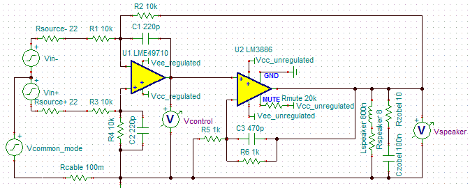

- Balanced composite amplifier implementations provide common mode rejection as well as chipamp error correction, with the residual error generally being dominated by the CMRR limit imposed by source impedance matching. A basic implementation of this topology is shown in the schematic I'm attaching to this post (feedback resistors and caps are starting points, note use of a more performant op amp than the LT318A for greater error correction). U1 should look familiar as it's a difference amplifier and fills the same role as the difference amplifier U4 in post 1's schematic. If one requires a higher input impedance or lower noise the usual two op amp front end of a three op amp instrumentation amplifier can be placed before the difference amplifier as usual. From an error reduction standpoint it's more useful to increase the common mode input impedance, making a THAT 1200 probably the most attractive frontend choice.
In fairness, the balanced composite chipamp approach does have its limitations. In most cases 0.1% resistors and 1% caps around the difference amplifier suffice to hold CMRR to 45dB or better given a balanced source using 1% resistors and a decent layout---the worse cases occur at the RC corner frequency well above the mains harmonics of the ground offset between the power amp and its source. Unless one has funky mains wiring, grounding issues, or level management problems this is usually good enough. For an unbalanced source Rsource- is just the ground resistance, meaning R1 in the schematic I've attached wants shimming by whatever Rsource+ happens to be. That's not commerically viable but it's often easy enough in DIY.

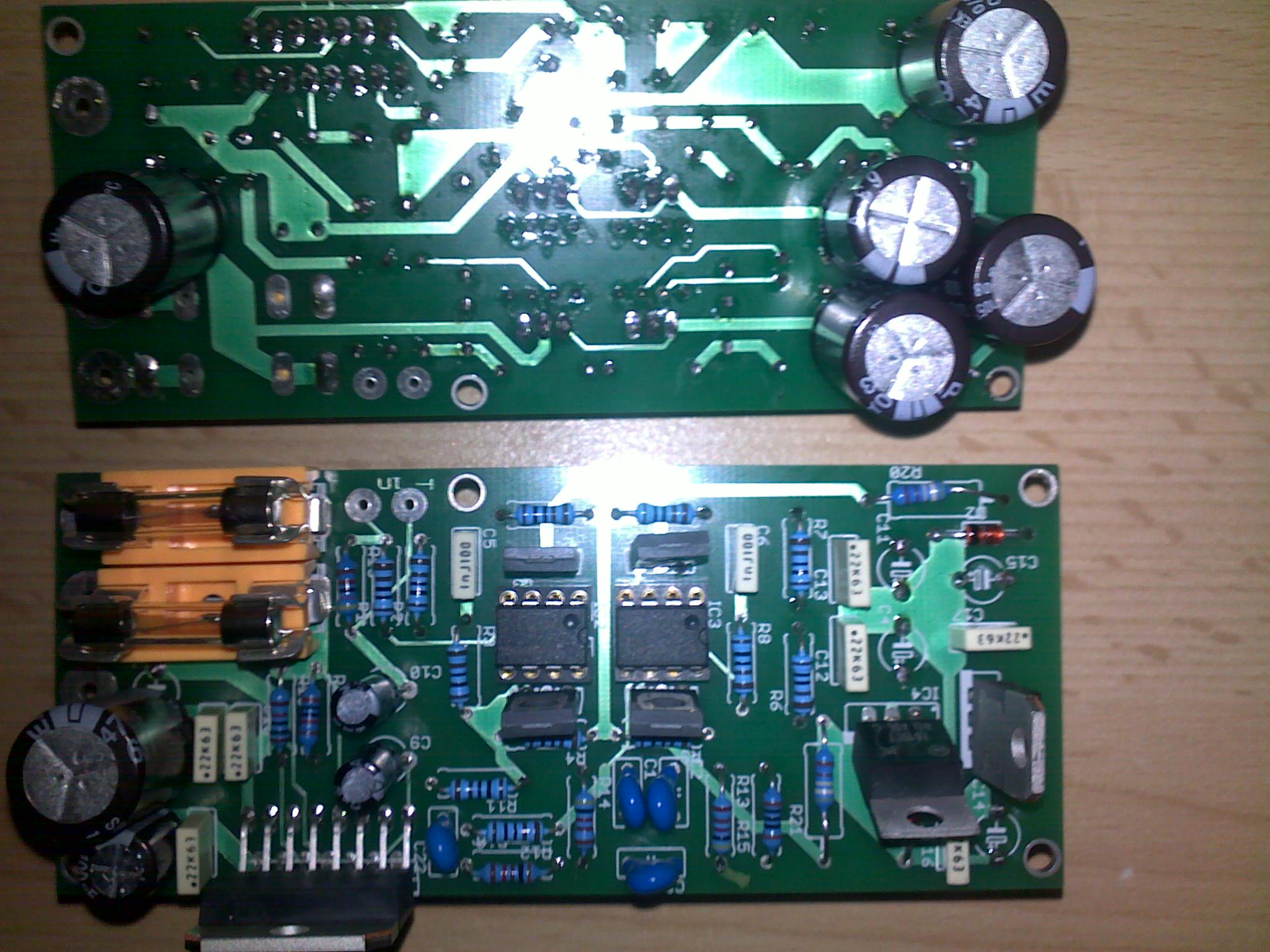

Hello, thank you for reply. I have to say that main idea with this topology is invented for driving differential amplifier, precisely for lowering Re, increasing gain and increasing input impedance of course. This schematic (post 1) is very optional, only for marking idea, and I can see that some values stayed as used for test only (c2 and c3 should be much lower), by mistake. I will provide real schematic if prototype justify expectations. So, yes, idea here is to use it with lm3886 or tda729x. But there is no such model in ltspice, and if I made it somehow it will not be as accurate as real build and I chose second. In the end, it is all about sound. I like stability of that concept, but I don't know will it improve or ruin sound quality. So I have to build it to hear how it sounds. After all, it is not complicated and it is fun
Regards!
After few hours, character still changing. But already speakers and amp disappeared, I really enjoyed music last hours. Never suppose that gainclones can be so enjoyable.
