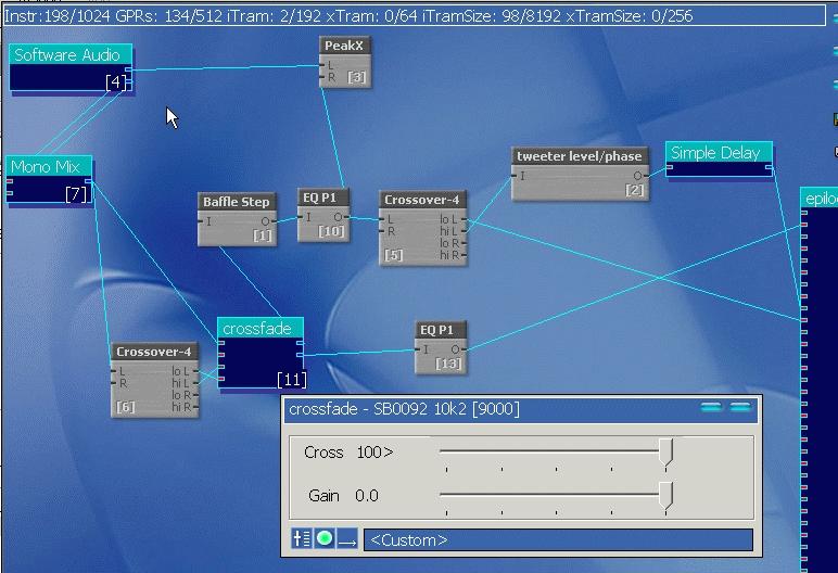

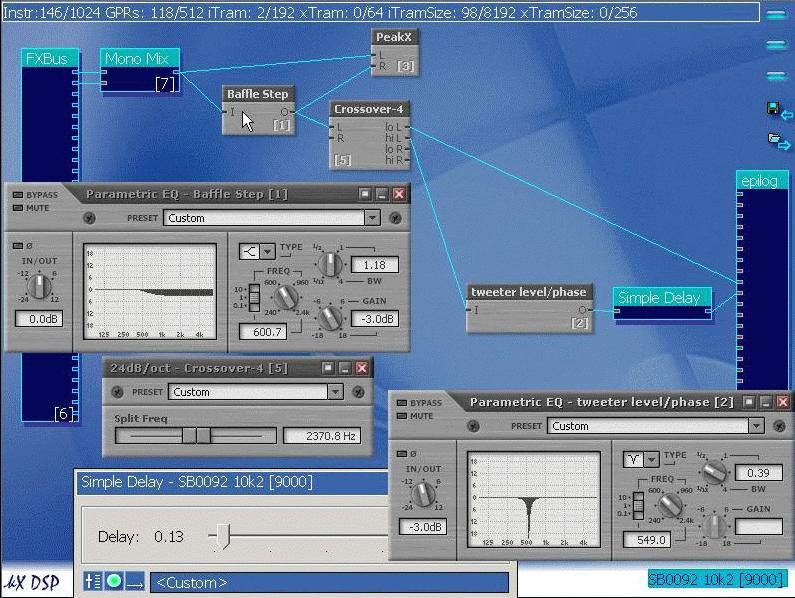

I've attached a picture of a mono crossover implemented in the dsp of my dirt-cheap Audigy sound card using the kxproject drivers.
L-R 24 crossover, couple of parametric eq for baffle-step correction, a notch at tweeter resonance frequency, easy level and phase adjustment, and a fine-adjustable delay for time-alignment. Six output channels and enough dsp memory for a three way stereo crossover with many EQ and delay modules.
I'm driving gainclones direct from the output jacks on the soundcard.
Noise is almost inaudible at the loudspeaker with everything cranked up to full volume, even with radioshack interconnects, my dreadful soldering, and the soundcard living inside of my fire-breathing lunchbox computer.
I crowded all of the controls into a small area to get the screenshot but you can spread it all out on your screen. All of the controls can be adjusted in real-time with music playing through the crossover. You can save and recall crossover setups. I have run the crossover with measurement software and an even an RTA on the computer so I suppose that room correction would be possible if I cpuld find the time and mental-energy.
An Audigy1 dsp soundcard costs US$45.00 and the kxproject drivers are free.

Here is a setup with subwoofer. A crossfader control allows me to go back and forth from full range satellites only, to sat+sub+crossover.
My MLTL project speaker goes fairly low in its current location, and the nasty horn p.a. sub not much lower, so if I set levels carefully, I can drag the crossfader, bring in the sub+crossover, and just hear the vocals go from less-clear to more-clear.

There's a signal generator device in there. It's facinating to set it to 1 or 2 Hz and watch the woofers move.

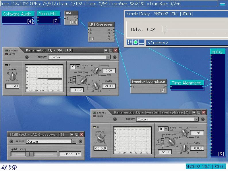

Hi, great news that you're giving this a go.
I got the baffle step by using 'EQ P1 (Mono)', selecting 'Hi S-shelf' from the pull-down list, and setting the gain knob negatively to cut above the bs freq. The BW knob is, I think, a variable slope control, it looks good to me at around 1. Frequency setting depends of course on baffle width. I use another P1mono to attenuate the tweeter and flip its phase if required (there's a little phi? gizmo above the main level control on the P1mono).
For time-alignment someone on the kxproject forum wrote me a 'simple delay' which I use and have a zip file around here somewhere. Send me a hotmail address and I'll mail it to you (or anyone, the fellow included source code in case we wanted to modify it.
