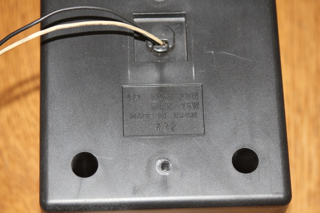

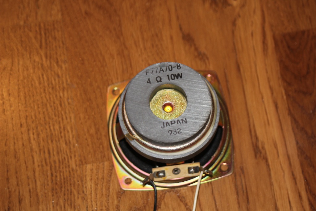

Here are the specs of the stocks speakers:
DRIVER SPECS:
PASSIVE
4 OHM
10W NOM
25W MAX
DRIVER DIMENSIONS:
3" HEIGHT
3" WIDTH
2" DEPTH
SPEAKER BOX DIMENSIONS:
5.25" HEIGHT
3.75" DEPTH
3.75" WIDTH

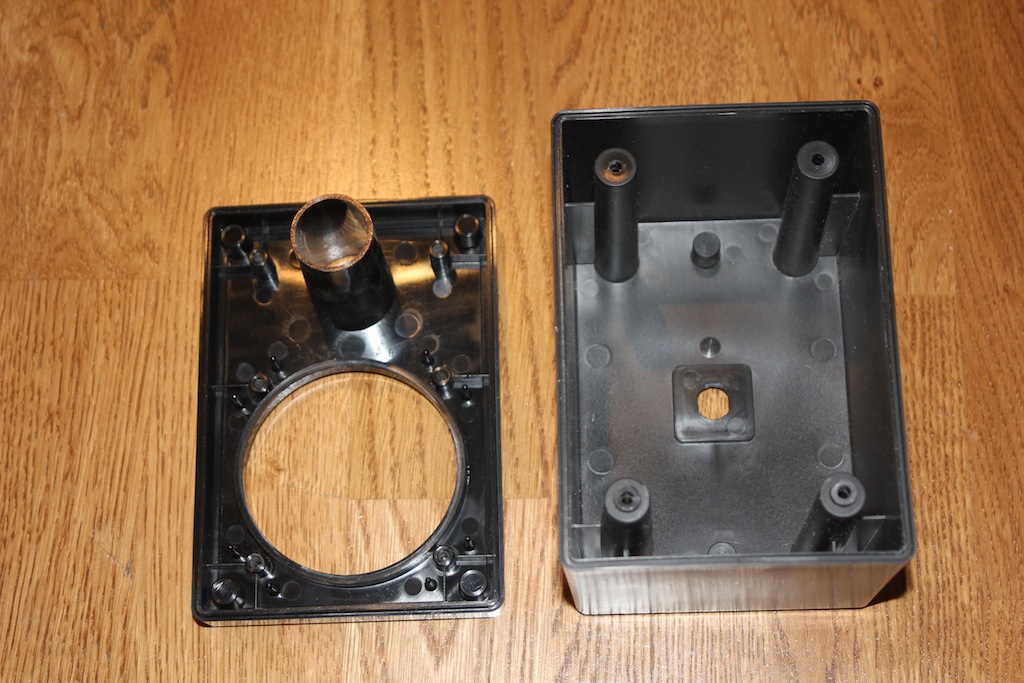

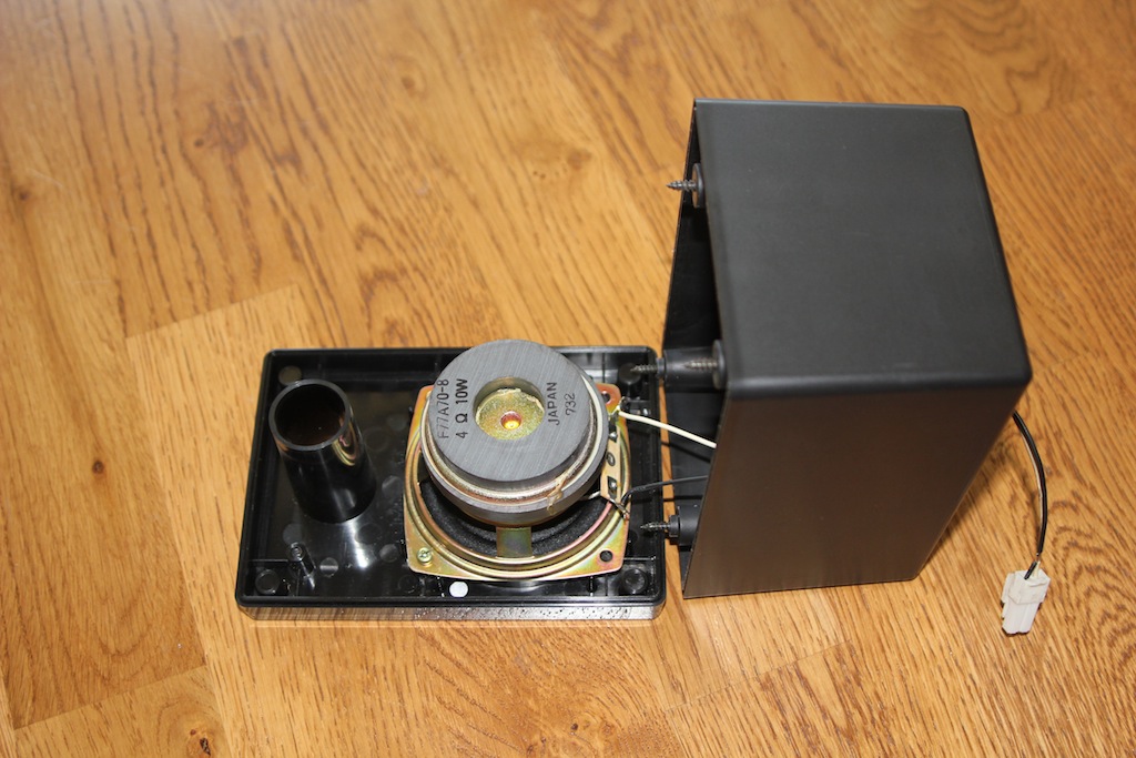

I added some pictures of the driver and speaker enclosure so you can see what I've got to work with.
Let me know what you think about it.

Ok it looks like that port/enclosure is tuned for about 120Hz which isn't ideal for the Founteks. I didn't consider the Daytons because they have a pretty wild high frequency response.
If you get the Founteks, listen to them with the ports open and again with something airtight stuffed into them. I'm thinking it should sound more natural if they are sealed.
Also it probably wouldn't hurt to add some kind of dampening to the cabinets. Something you can apply to the interior walls.

You'd want to seal the port off completely. Like glue something to the end of it, inside the cabinet.
Think of it like this though:
With the port: It's like having a bass boost effect
Without: Less low end but more natural low frequency roll off
This is why I say you should listen first. You should prefer one or the other.
I would use this to pad all the internal sides except for the front. Since its a plastic enclosure you should be able to use an adhesive to glue them on.
If you used WinISD you could go through a bunch of speakers like boris81 said and find the best one. I actually looked at a couple and the Fountek seems like a good choice overall.
