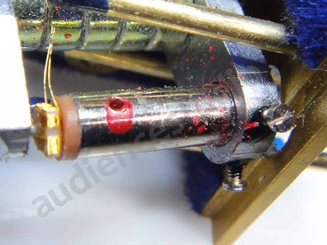

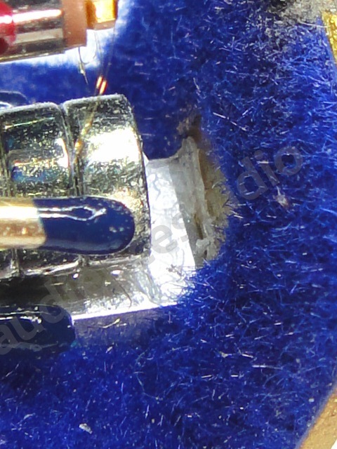

It is hard to tell if the rebuild was done incorrectly or originally it was already bad. I feel that both are true. Lumiére had qaulity issues, some were perfect but some were almost unusable when received new.
This unit seems to suffer from manufacturing quality issues but company who rebuilt it should not accept the money for the repair as it was not done correctly. If the person would listen to and test the cartridge he would realize that the cartridge is not sounding good.
A cartridge is very prices unit of different elements that have to be perfectly aligned. Unfortunaly in many cases it is not built properly. I've seen coils winded very poorly, incorrectly set suspension, incorrectly aligned styluses and awful assembly of brand new cartrdiges, but I am not going to mention any brands here.

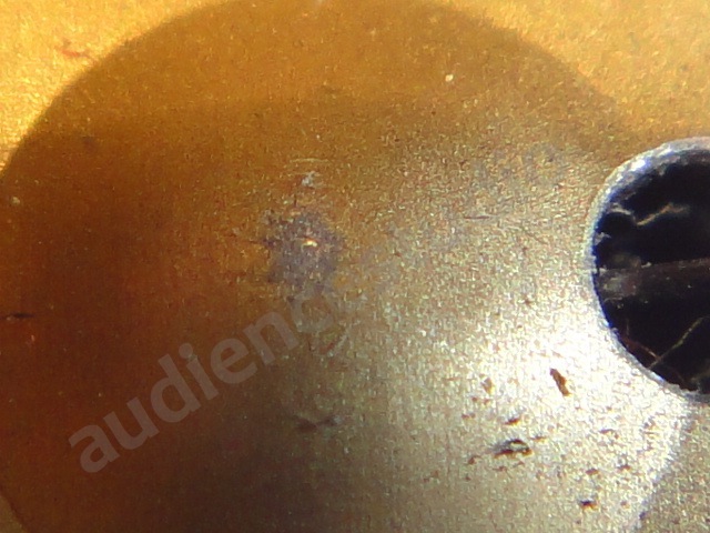

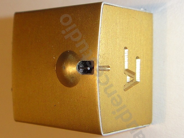

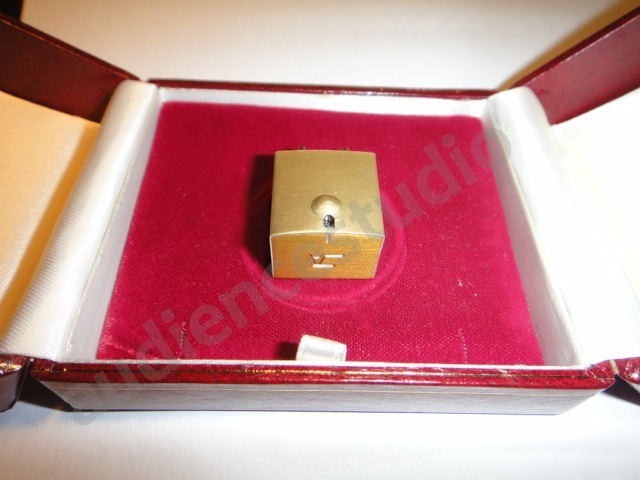

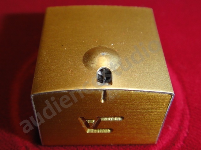

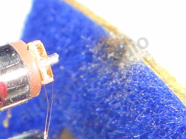

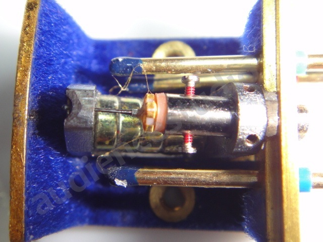

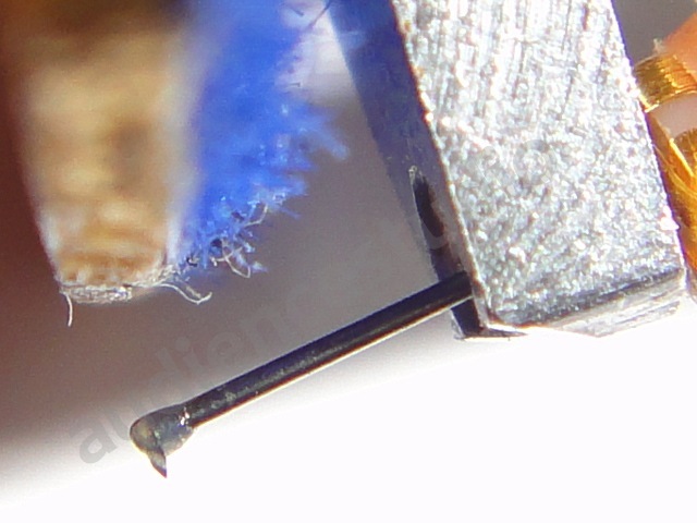

J.A. ALLAERTS MC2 FINISH GOLD
Here is another unusual and interesting cartridge. It is built the usual way but the used materials and the inside is not at all average 🙂

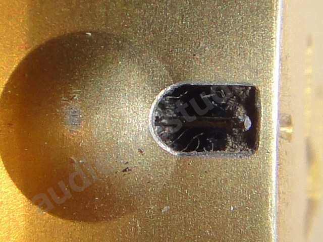

Very good manufacturing quality.

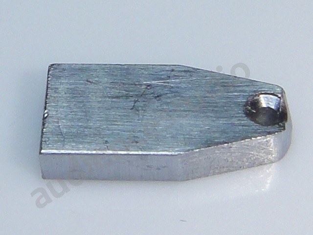

Hand-built.
Hand-built.

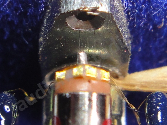

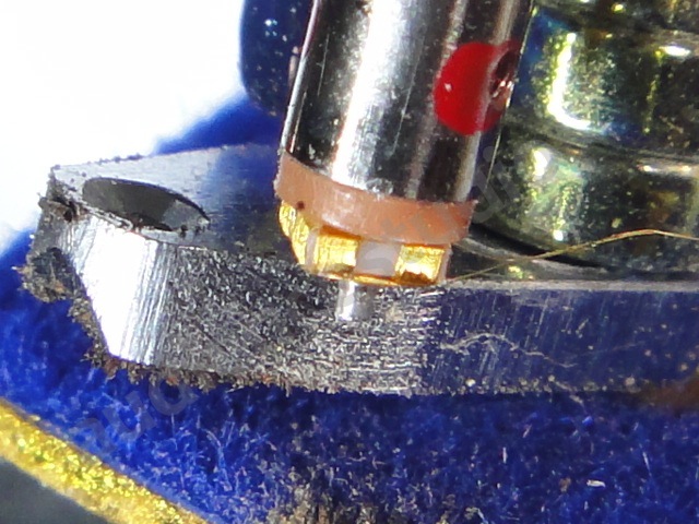

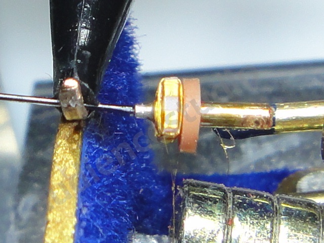

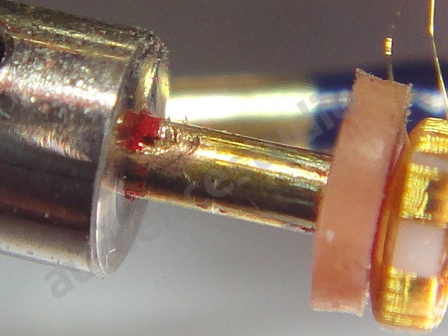

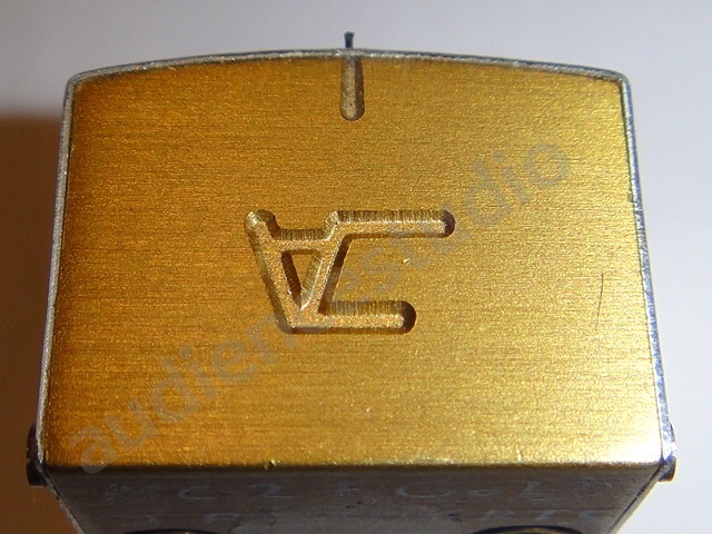

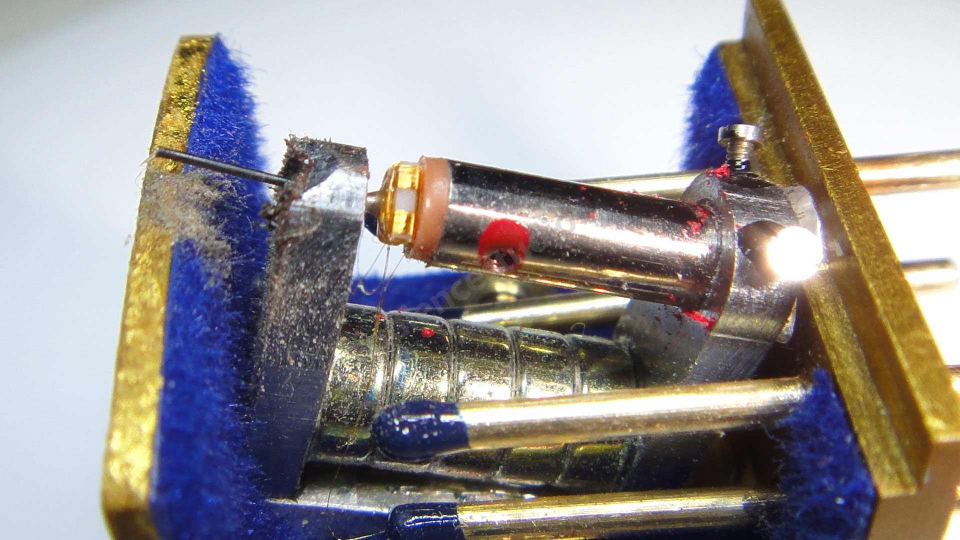

Phones switched off...concentrating only on the repair.

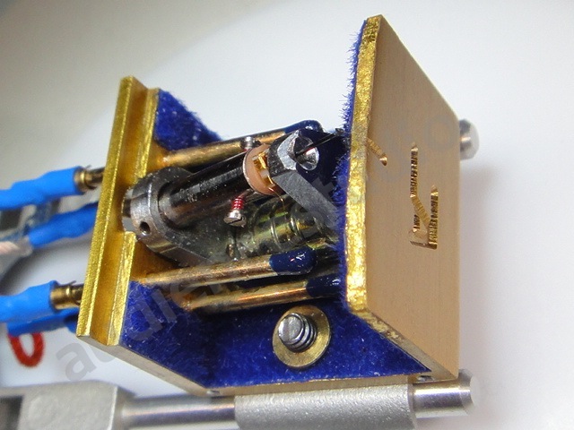

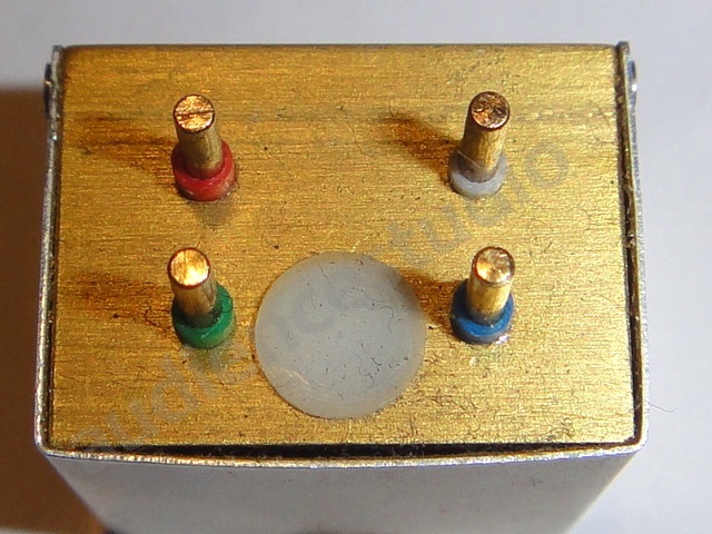

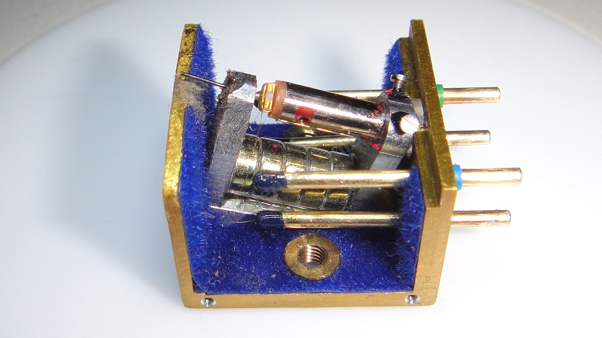

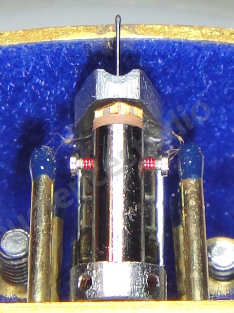

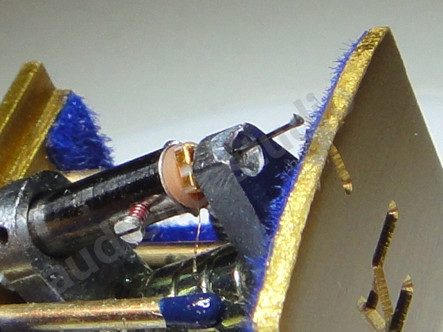

Victory 🙂
Victory 🙂

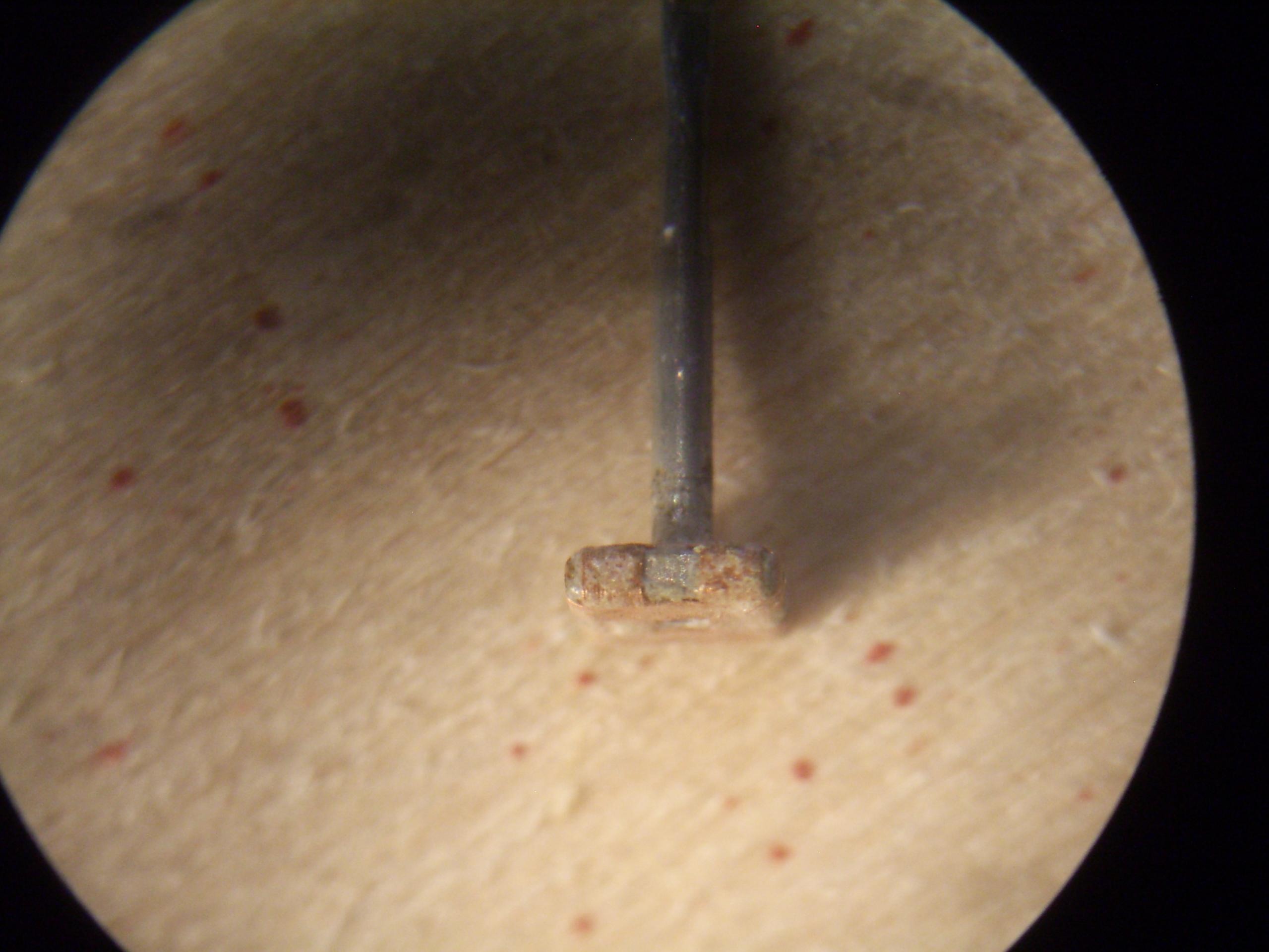

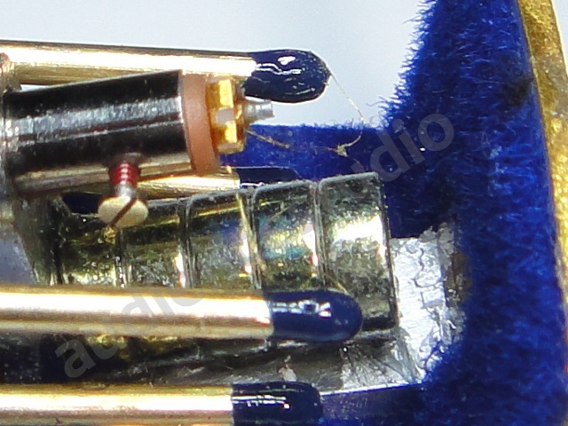

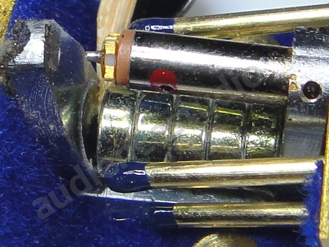

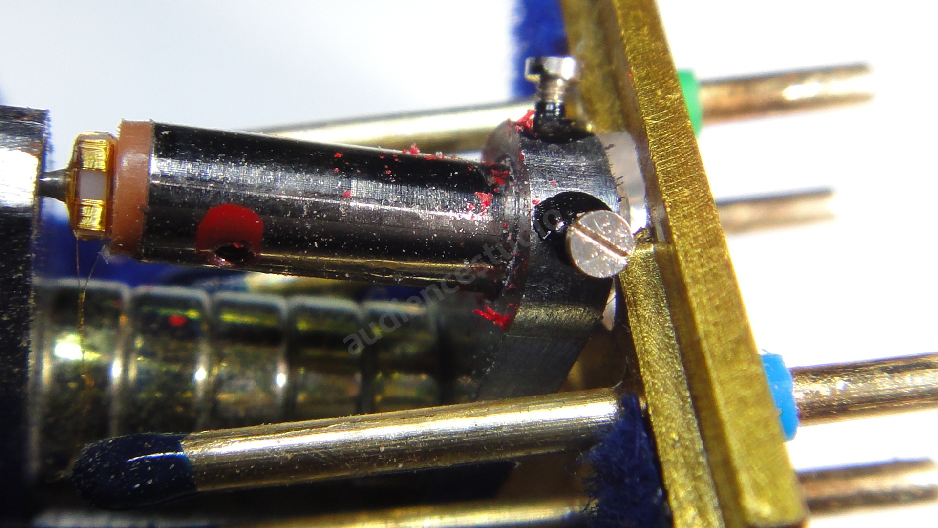

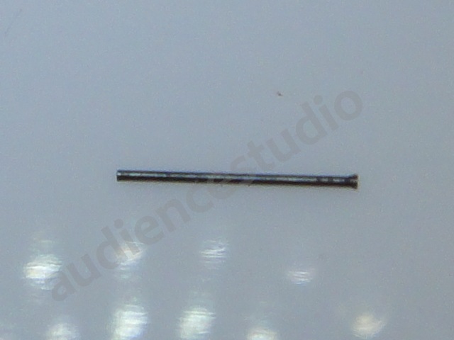

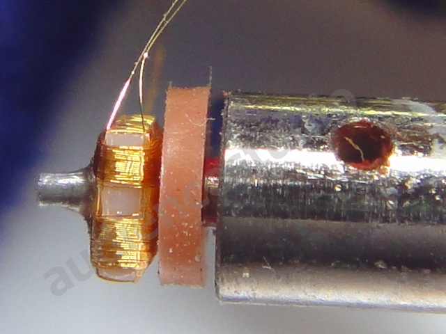

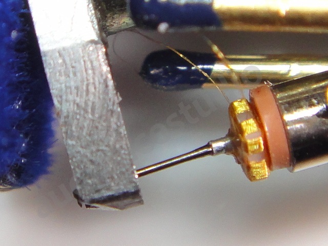

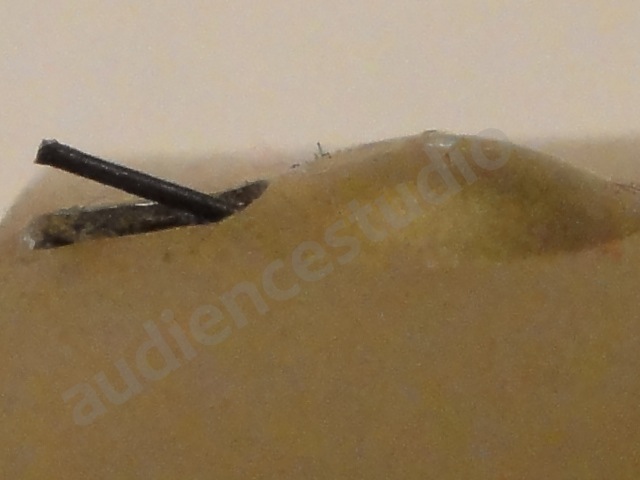

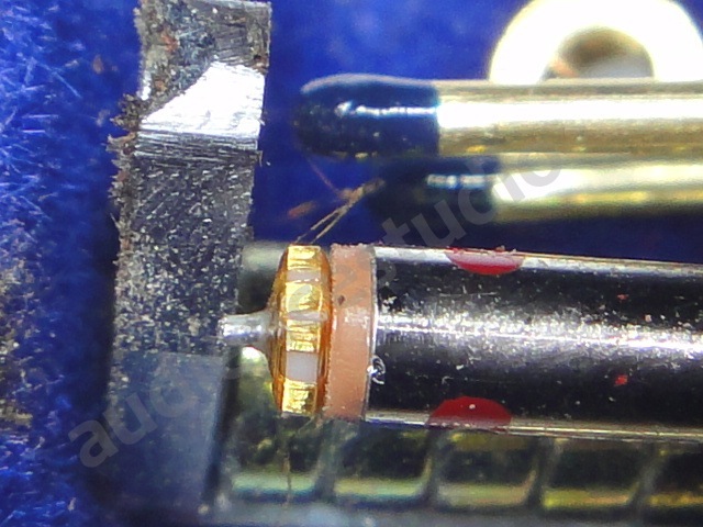

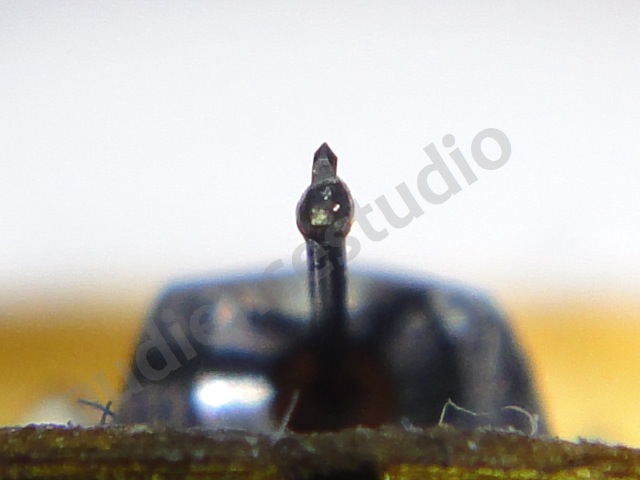

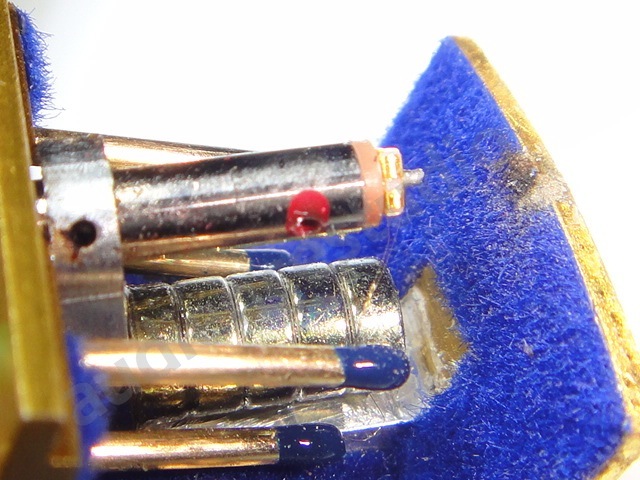

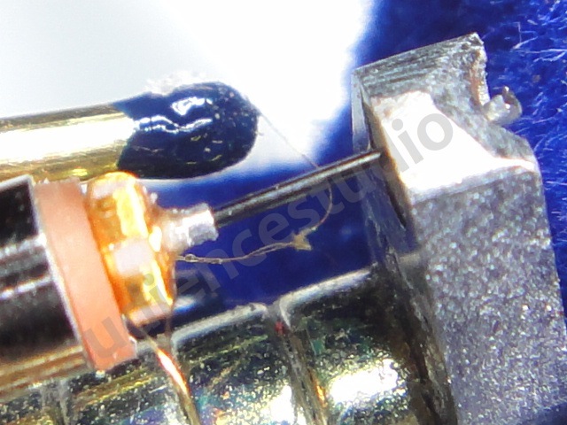

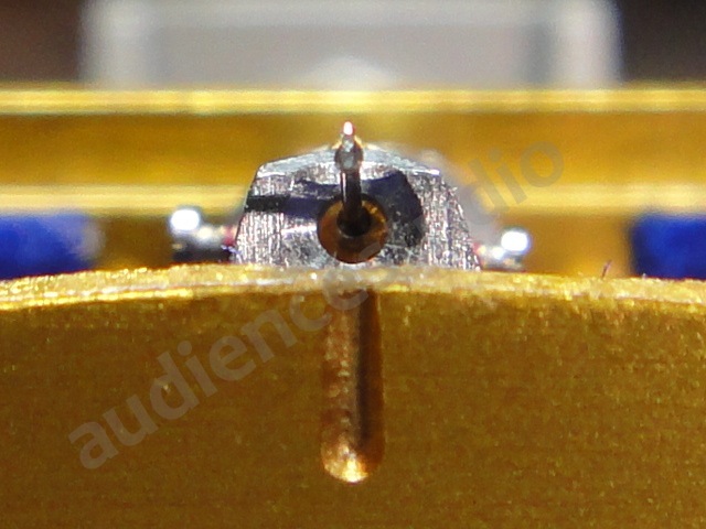

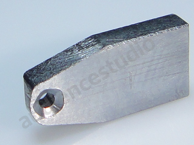

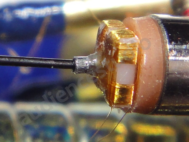

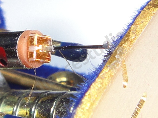

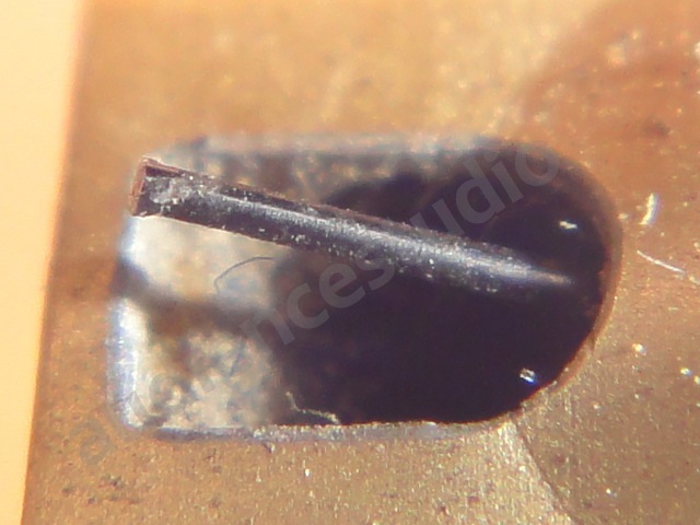

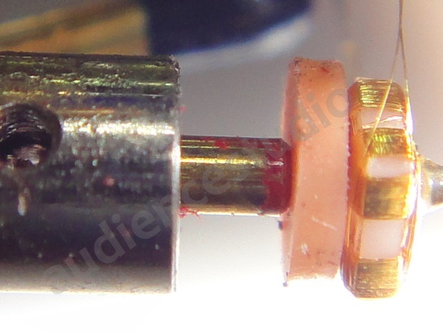

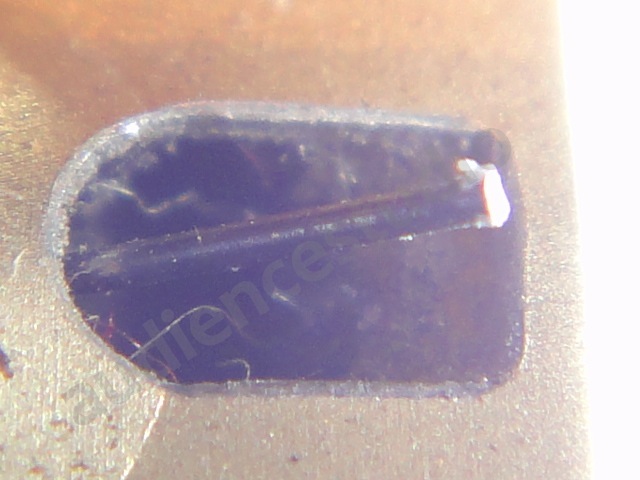

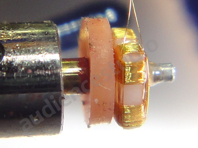

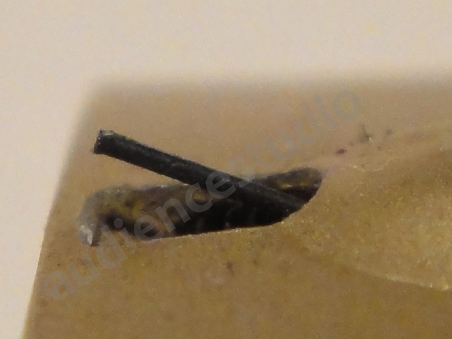

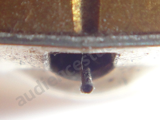

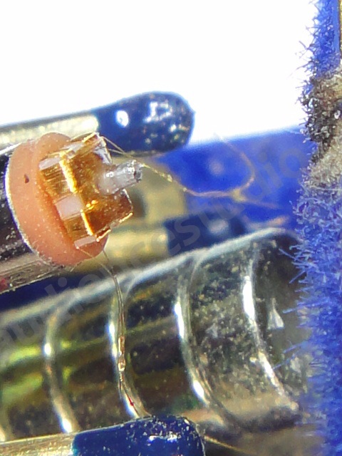

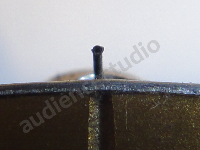

Is it a boron cantilever ?
The same as you can see on a Technics EPC-310MC.
Yes, it is a boron cantilever with FG-S stylus.
The coil wire size is .0002"😱 and one layer. i have plans to rewind this and eventually mill a solid body into the headshell and incorporate everything solid.
The magnet feels more powerful than a neo of similiar size..

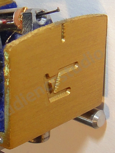

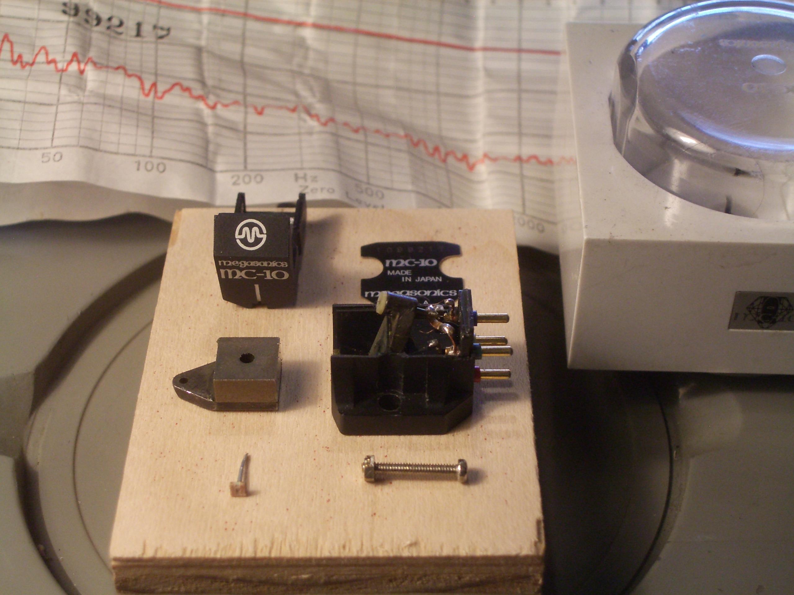

I have already machined a new short adjustable headshell for my Air bearing Eminent Technogoly ET2 that will replace the arm with a 1.4" pivot to stylus to duplicate a Versa Dynamics TT style tonearm. This would be on a vacuum platter and wouldn,t work well with this short pivot arc.
the MC cartridge is a Win Labs Megasonics as a base platform soon to built into the short headshell eventually.
