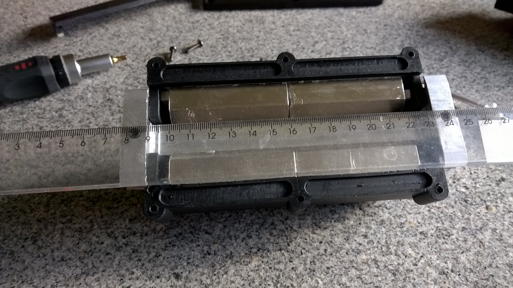

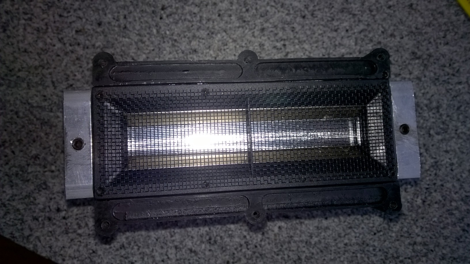

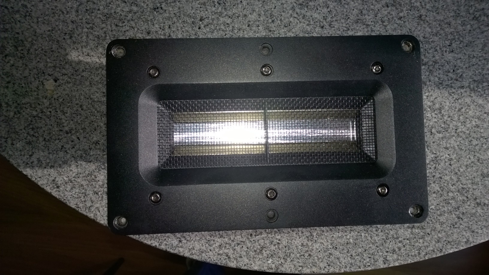

Interesting, just ordered these 2 days ago. Were they hard to take apart?

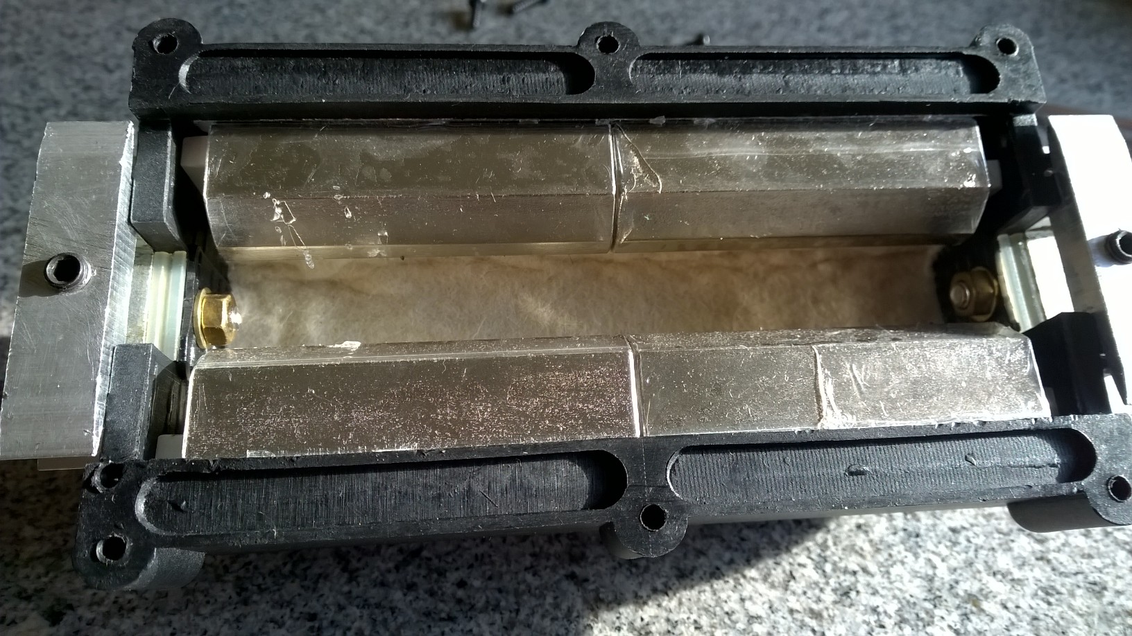

Is only one of the magnets angled/beveled or does the picture lie?
How thick is the felt on the bottom behind the ribbon?
What do you think of the quality of the original 15µ ribbon element?
Interestingly, the build looks very similar to the neoCD3.5h except for the bevel, which is a round over

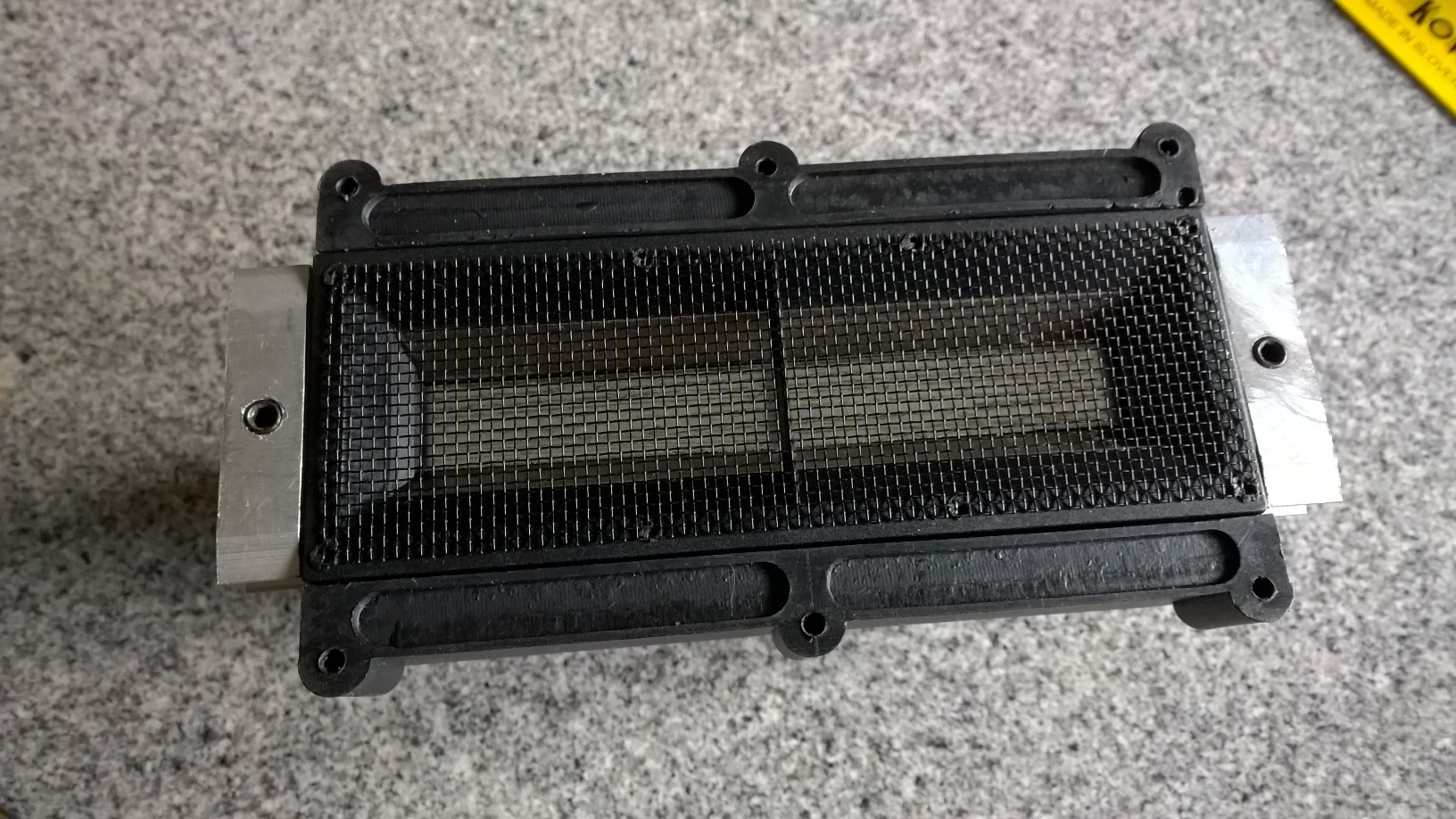

It is very simple to take apart, but I do I would not recommend. You will almost certainly 100% ripped ribbon. As I did. I change ribbon for regular kitchen ALU foil. Measurement of the frequency response was the same as with original ribbon.
All the magnets (4) are angeled from both side. Angle is about 30-35 degres
The felt is about 2mm thick.
I think there is too much volume in the casing (behind the ribbon). When I will have more time, I will add some felt.

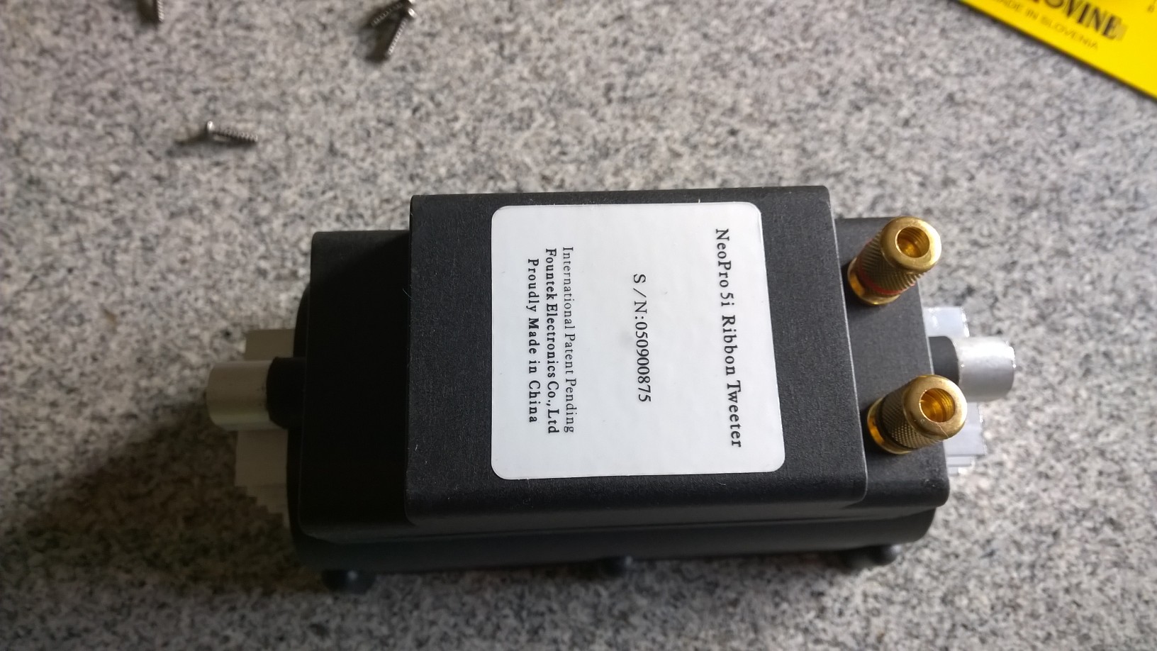

The core material of the step-down tranformer is ferrite, or at least looks like it, which was interesting.
I like the attachment system of the ribbon. Should be easy to replace a ribbon yourself. Since this ribbon isn't even folded it should be a piece of cake to make your own out of kitchen foil. I have done ribbon replacements with kitchen alu foil in the past and they sounded exactly the same as the originals and all are still working.
