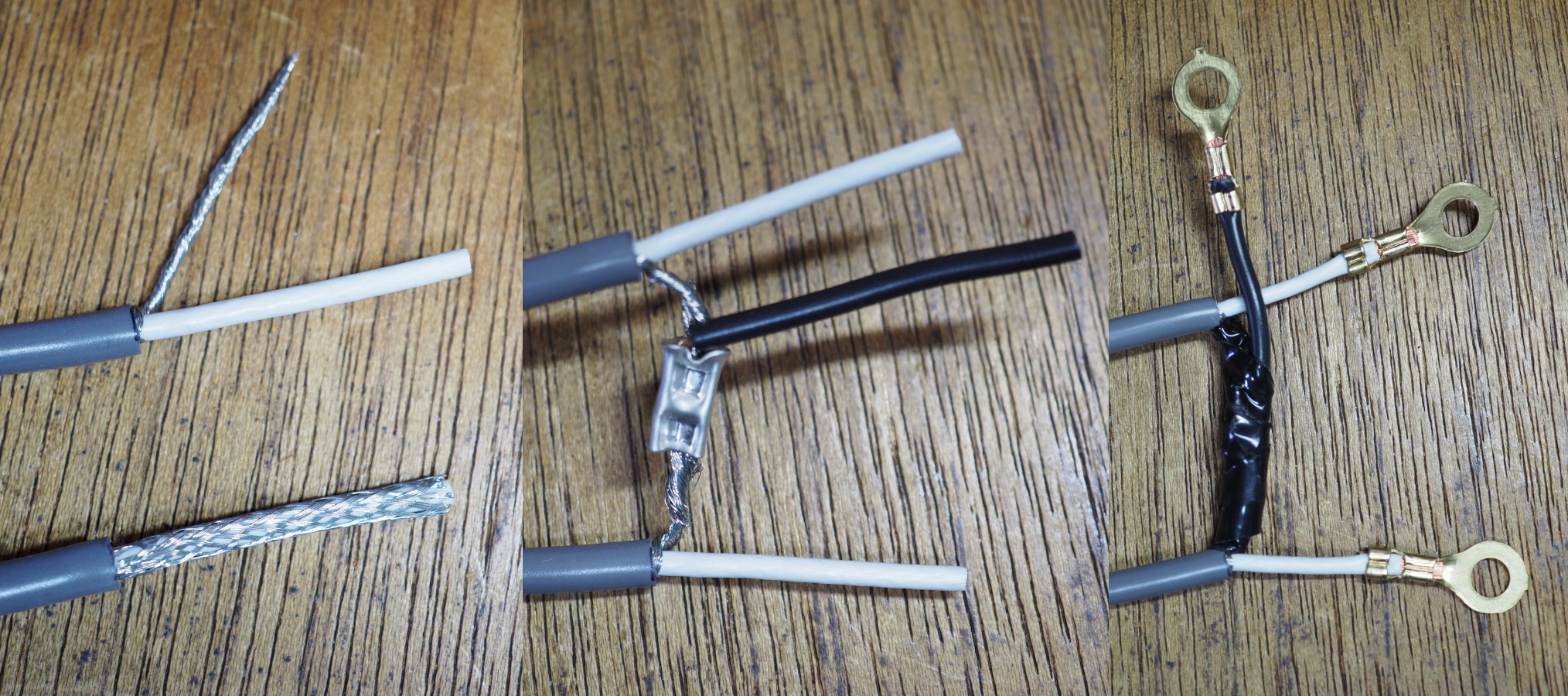

What is the terminal diameter for Markaudio Drivers? It doesnt say on the datasheet tho 🙂I am using 1.25sq single core coaxial cable (TPC) inside.
The shield wire is a single point ground on the cold side.

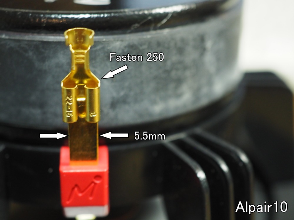

MA drivers (at least the Altair’s) come with quick connect terminal bits.

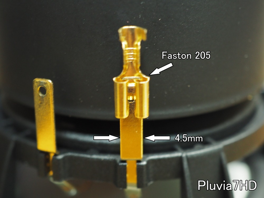

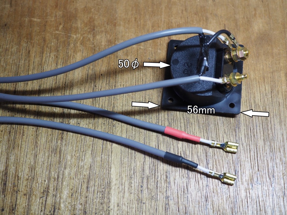

The connect terminal is 50φ for installation.
The terminal width of Pluvia7HD is 4.5 mm.

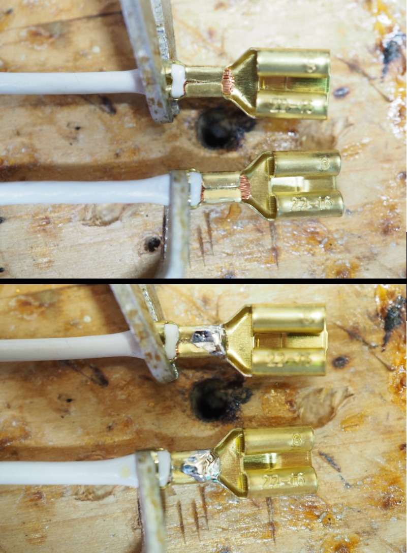

Round & faston terminals are soldered after crimping.
I do not solder directly because I connect and disconnect many drivers.
