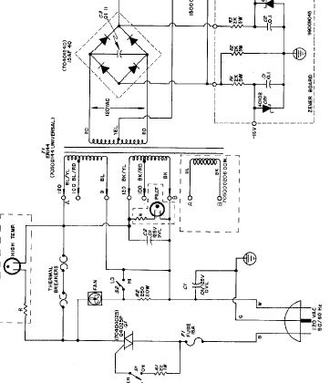

I am measuring the primary current. See the attached schematic of the AC input. I have the sense resistor in series with the neutral on the power cord.
I would need more than a two channel scope to measure the AC waveform at turn-on. I don't have such. Using a differential probe would free up a channel I suppose. Without one, inverting a channel and adding it to the other is all I can do.

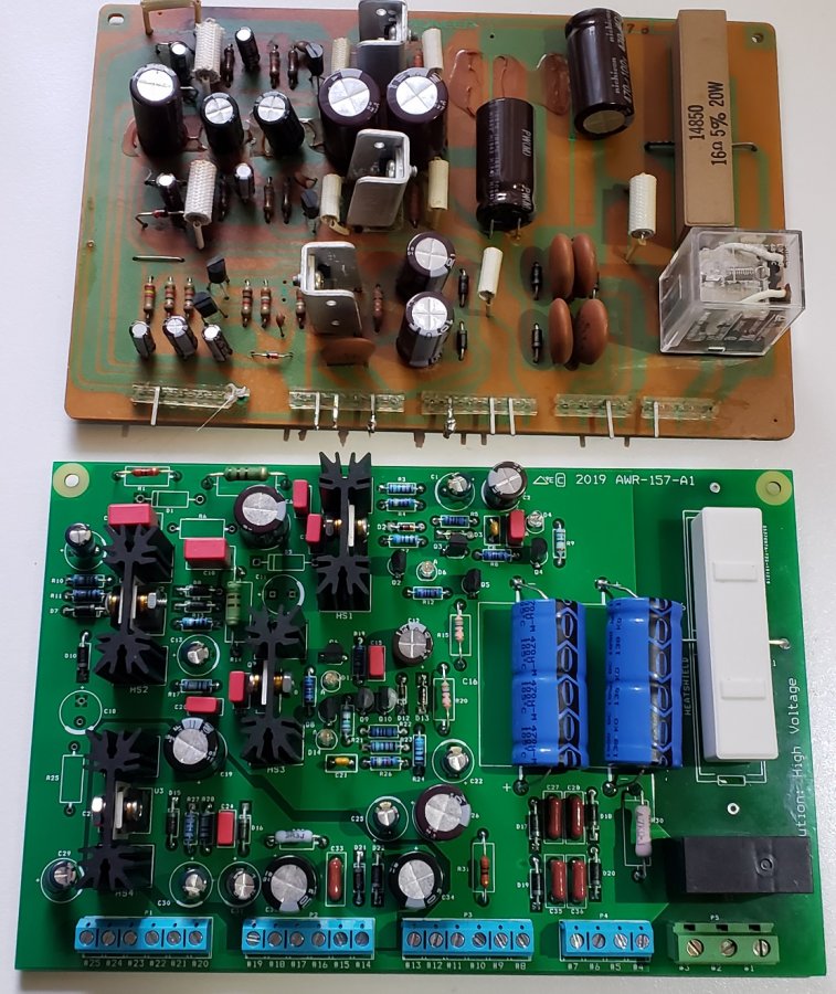

This is what I use, I do not like those NTC's or any resistor cooking away under a fault condition.
Digi-key
‎317-1130-ND‎ SDF DF104S‎
A131149-ND‎ ‎SQBW203R3J‎ You have to take the chassis mount bracket off for mounting to a pcb
‎255-2373-ND ‎ALE1PB48‎

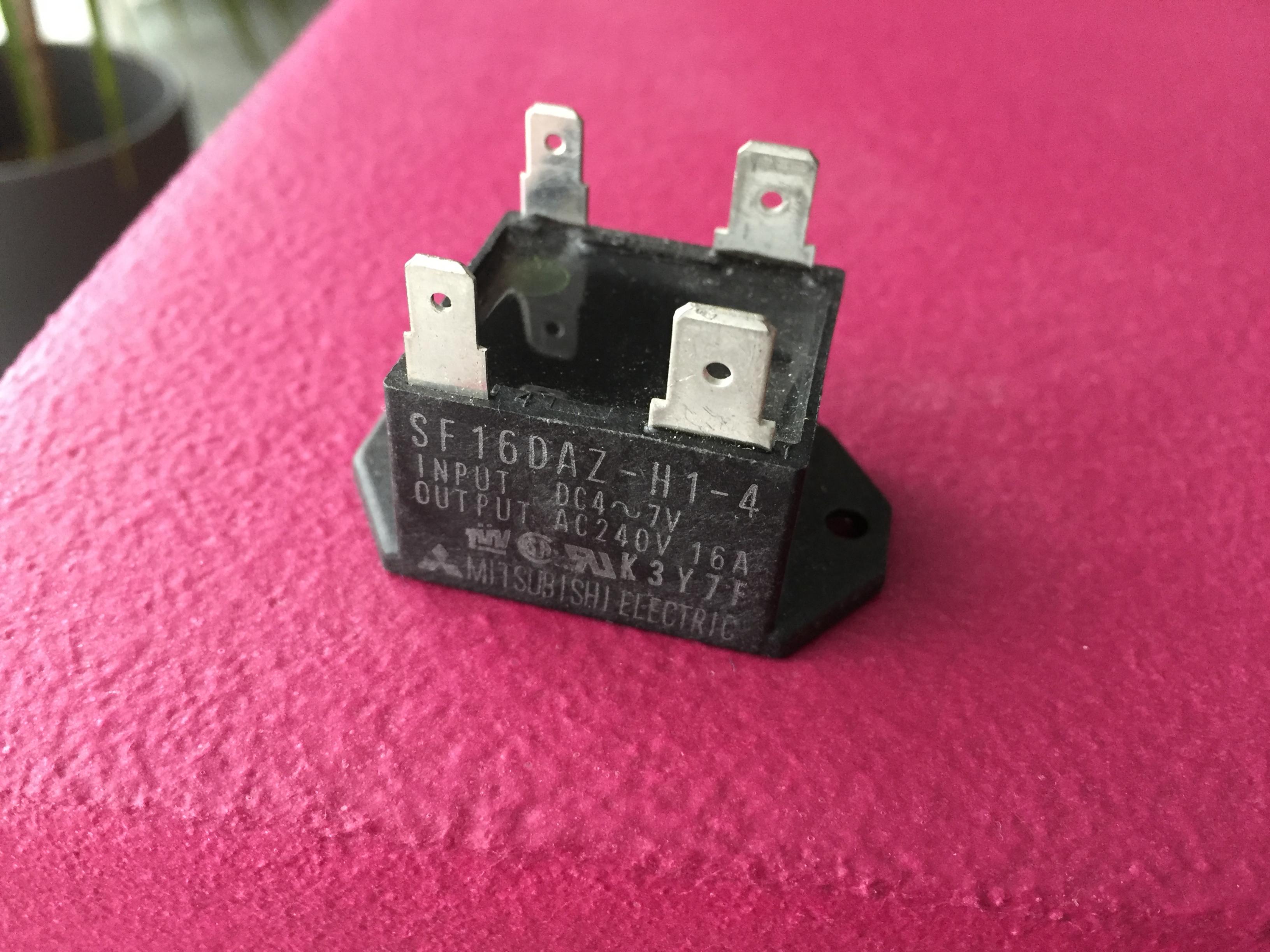

The intended way of operation (reducing the current of the absolute first cycle after everything was 0) will work like you want when using a SSR with zero crossing detection. I have used those after salvaging parts from photocopiers where they are used to switch on the halogen heaters. As these are in fact halogen lamps they don't like to be switched on when the mains voltage is at the highest point so SSRs are used for this function for decades. The only penalty is that you then need a voltage/current to drive the LED in the SSR so you will need an extra circuit. If an extra circuit is needed anyway I would still short the SSRs contacts with a relay after a few seconds.
Too late to edit my post but:
- The SSR with zero crossing detection will operate as intended at first cycle when everything is 0 (regardless of what happens next and will happen anyway).
- With an SSR you can use the smallest and most elegant looking "mains switch" you want.
- Since the SSR triggers by means of a LED there is galvanic separation as well.
- Driving the LED can then also be done with remote control.
- SSR should best be located near the transformer but there won't be mains voltage carrying wiring to the "mains switch".
Drawbacks in practice:
- extra circuit needed but that may be beneficial for a relay shorting the SSR's contacts and possibly remote control
- leakage through the SSR. I once had a complete buildings lighting done with SSR's and although it worked fine there was a too high leakage for the certification to call lighting fixtures safe when switched off. Bummer. Can probably be limited by the choice which SSR will be used so needs further examination.
