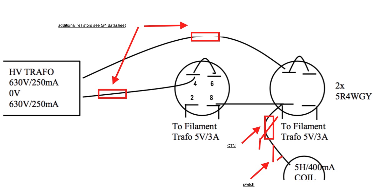

your description doesn’t make sense to me, a drawing with pin numbers would be helpful.
that 100r resistor provides a soft start, reducing inrush current to the HV primary but it will allow mains to reach the HV transformer primary. Until the amp starts drawing current from the HV supply there will be limited voltage drop across that 100R so you’ll have some HV present at the secondary of the HV transformer before the delay-relay closes. As George says, you need some HV for blue arcs and your HV is ‘on’ at start-up. It takes a Couple of seconds for the rectifier filament to warm up and start conducting which is when you see the blue flash.
some things to try based on what I’ve read about reducing stress on the rectifier, a) add high voltage silicon diodes in series with the plates to protect the tube rectifier from high reverse voltage stress, b) add a small cap to ground after the tube rectifier to shunt high frequency voltage spikes (<1uF), c) increase series resistance to the tube rectifier

This is a 300B amp, so a UF4007's in series with each rectifier plate may be all that's needed to stop the flash over.
This was added to all SSE boards back around 2010 when everybody was turning out junk 5AR4's. If the cathode (or filament) coating isn't even and uniform, or the assembly isn't concentric, the conduction will start at the place where the coating is the thinnest since that spots heats up faster, or at the place where the cathode to plate spacing is the shortest. This poor spot gets to eat all the current being sucked by the hungry empty filter caps. Localized overheating occurs resulting in a flash over.
The diode trick seemed to fix the issue, and the characteristics of the tube dominate over the 0.7 volts of the diode, so the diode doesn't get heard. Even a standard 1N4007 will work. If not, it was a cheap experiment.

I believe to have described the power supply schematics on the first post and I sent a sketch of the rectifiers config. What other info should I provide?

Not quite, as the ss diodes are around the wrong way.
Some googling should bring up example schematics, such as:
The Immortal Amplifier Mod

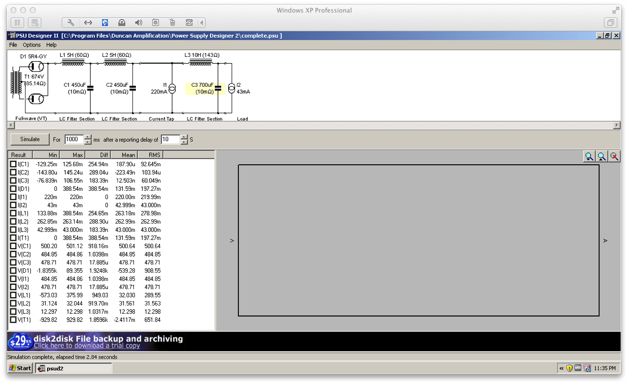

I have found an old simulation I have done for the PS. Please check attached.
I had written on my notes:
"280mA is the DC load of the output tubes' anodes. On the top of that, there is the very high Vac at rectifier frequency (twice mains F) across the choke (see below V (L1) and I (L1)).
Someone suggested that the gap needs to be just right so the sum of Bdc and Bac don't exceed 1.6Tesla, but I have no idea of how to calculate that."
Please take this with a grain of salt...
Each rectifier tube is being used in 1/2 wave mode. Each rectifier sees 50 or 60 alternations/sec
Your choke: 5H @ 400mA.
Inductive reactance = 2 x pi x f x L
At 50 Hz, 2 x 3.14 x 50 x 5H = 1570 Ohms
At 60 Hz, 2 x 3.14 x 50 x 5H = 1884 Ohms
The rectifier has a voltage drop, call that 67V. 630Vrms x 1.414 = 891V peak; 891V - 67V = 824V
Admittedly, the rectifier drop will be larger than 67V at peak currents during turn-on transients (but how much more voltage drop?) The 470uF cap that follows the 5H choke is a Dead Short at turn on.
Inrush current at turn on:
50 Hz: 824V peak / 1570 = 525 mA
60 Hz: 824V peak / 1884 = 437 mA
Those inrush currents may saturate your 400mA 5H choke, so 5H becomes 4H, 3H . . . ? With the reduced (saturated) inductance, the inrush current might exceed the rectifier's max peak current spec. Even if the filaments are already warm, when the delayed HV is applied, there will be large inrush currents. Arc, Arc, Arc (perhaps). Only your rectifier knows. Try using a 600mA 5H choke.
