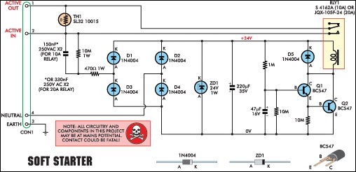

can I use a simple NTC Thermistor for the transformer? can you recommend me which one to go with ? or any complex circuitry is needed for
3.3kva Toroidal / R-core trafo with 1,00,000uf per rail capacitance or it can even go for 2,00,000uf per rail capacitance.
Please recommend me some reliable way to handle inrush currents. Im using relays but apart from that there should be a inrush current limiting to be taken care. please suggest me that using a NTC Thermistor is ok? If so what is the best way to do it? where to place that ?

10ohm 50W resistors shorted by 10A relays with a few seconds delay after the rectifier should do it.
Just thermistors will probably be ok but only for a class A amp. Probably 2-3 in series.

NTC = not such a good idea.
I use a series resistor shunted by a big relay. You can manually control the relay with a two position switch or use a timing circuit. I've done both.
If you use the former, be sure to use LARGE wattage power resistors, since you could, might just forget to flip the switch. It's been done. 😀
The 10 ohm value is about right - you can test and figure it out empirically.
i agree, perhaps a 100ohm 100 watt resistor like Dales...
that is how i will do it....😉

I always run the relay off a secondary small and dedicated supply. But the schematic put up by andrewlebon is pretty much the standard way to do the timed cap method. I have also used a 555 timer chip.
As far as the Dale resistors, the type in the aluminum case, I do NOT like them, as they tend to explode out the ends when they are pushed near or above their rated power. I prefer the cylindrical ceramic type, they can handle quite a bit over their rating for rather long periods, even to the point of starting to glow red.
