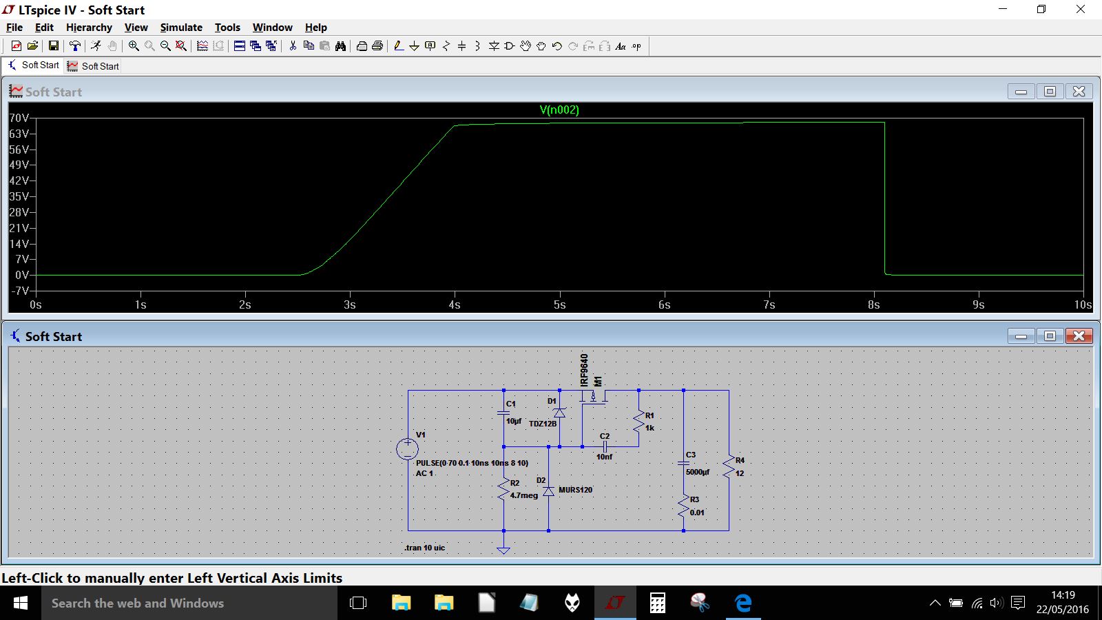

Inrush current limiter for DC

It seems we all have our own ideas as to what to do in a case like this. My recommend stays the same in trying to reduce the total value of C.
Put it into a simulator and find out how well it works! Personally I suspect that the 10nF capacitor directly shorted to the 10uF capacitor, guarantees that the small capacitor has ~ no effect upon the PMOS gate waveform, and nothing would change if you completely removed the 10nF capacitor. However,
The purpose of computer simulation is to correct faulty human intuition.

I was asking about adding extra circuit, plugged between smps and amp rails, that would limit inrush current.
See post #1 and #22 where I proposed such circuit.
Any opinion on that circuit (or any ideas of something similar)?
Something that would limit current to say 1 amp for the 1st second.
Don't see why it wouldn't be do-able.
Your circuit in post #22 would ramp the voltage up but I'm not convinced its the best solution.
