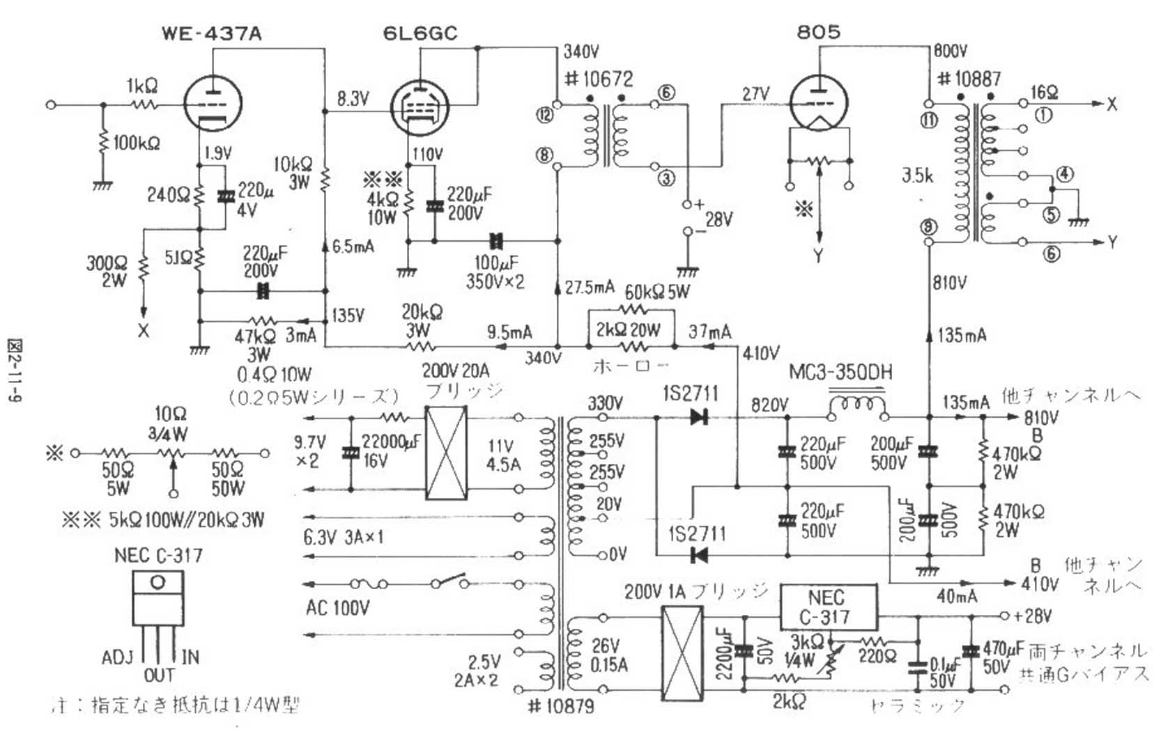

Hi Guys,I need your educated opinion -I got the enclosed scheme of a nice tube amplifiers and I want to build it,but I can't figure out what should be the asking specifications of the power transformer-could anyone share with me this information ? Thanks for your willingness and efforts to assist me.
This is an 800 Volt amplifier. I would be very afraid. And I would think that if you were experienced enough to work on it and survive, that you could also compile the transformer spec from data on the plan.
