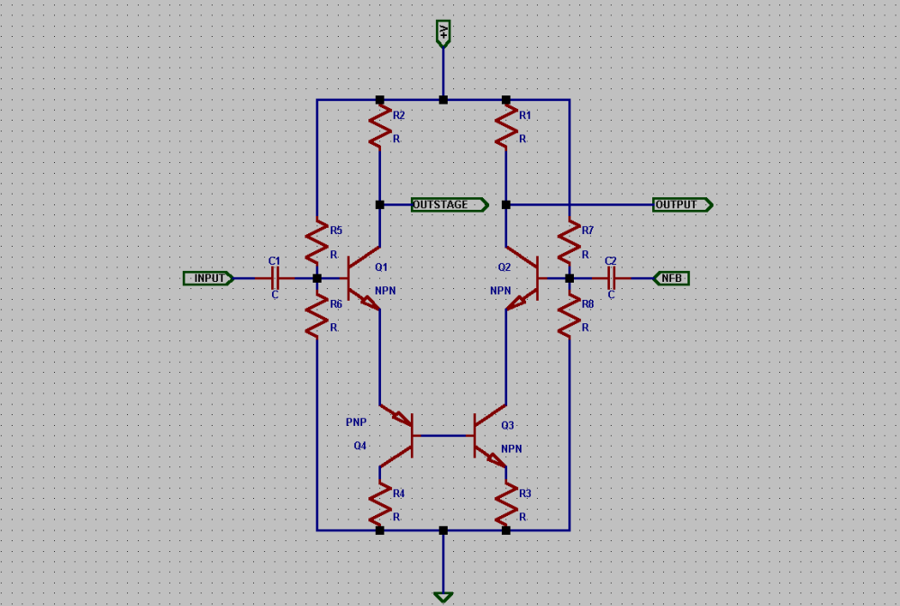

I have looked at the LTP topology and am wodering about it somewhat. I have some ideas that I am wondering about the ups and downs for. From what I know, here is a standard use of the LTP:
OUTPUTSTAGE is going to the output stage of the amp. OUT is the feedback output. Everythig else should be self-explanatory.
I have wondered about another idea I had and am showing in the next post.
Here is my idea. The two bottommost transistors are complementary this time, making the bias flow through the emitters and collectors of the transisters. One downfall I can see to this is that the voltage on one side of the LTP is higher after this stage because the current flows one way. I also see that some complementary matching might be needed. Here it is:

I'm not familiar with your LTP in post#1. Usually a differential pair only consist of Q1-Q2 (without Q3-Q4) with both emitors tied together. This simple (but very powerfull) configuration of 2 transistors tied together in the emitors indeed does the main job of a power amplifier.
I'm interested in your idea, but could you explain it with LTP that only has Q1-Q2 without Q3-Q4, with Q1-Q2's emitors tied together?

By "You got many interesting ideas" I am supposing that is a good thing, thanks!
I am deriving this LTP variation from mikeB's symasym4 (in diagram).
I am not completely sure what you mean, as Q3-Q4 are the main points of my idea. Do you want me to explain how an LTP works so that you know I understand it?
I am simply wondering how this variation would work as supposed to the more used topology in my first post.
i am not really sure what Q3-Q4 are for (sorry... ), but I think that Q3 developes another comparing circuit with Q2 while using Q4 to amplify the input signal even more so that the output transistors can be biased at lower current therefore reducing noise generation (whew, long sentence!). Get what I mean? Am I right, mikeB? I think one of the ups of this idea is that instead of the bias current being split between the two bases, it runs through both bases at the same time, applying the full bias current to both transistors! (ohm's law might prove me wrong, though) Another intresting idea: I wonder what would happen if you fitted a resistor between the bases of Q3-Q4?
I severely dislike dissapointing people, so if I dissapointed you, tell me where I went wrong so that I can fix it next time!

keantoken said:Here is my idea. The two bottommost transistors are complementary this time, making the bias flow through the emitters and collectors of the transisters. One downfall I can see to this is that the voltage on one side of the LTP is higher after this stage because the current flows one way. I also see that some complementary matching might be needed. Here it is:
OK, look at the voltage on the emitters of Q1 and Q2. Can you tell me what they are (approximately of course)? That will immediately show you whether this will work or not.
Hint: Assume that Vbe = 0.7V

keantoken said:I am not completely sure what you mean, as Q3-Q4 are the main points of my idea. Do you want me to explain how an LTP works so that you know I understand it?
Yes, that would actually be a good idea since your first idea is not a LTP, i.e. does not function as such. The second would sort-of work like a LTP assuming resistor values are well chosen - except that it would add one more Vbe into one side of the LTP, and one pretty much wasted transistor in the 'tail' of the LTP, which in turn would prevent the LTP in doing what it does best - compensating the nonlinearities of one transistor in the LTP with tghe other (to put it simplistically).
Once again, I admire your enthusiasm, but you seem to be lacking some of the very basic knowledge you need to set up sensible electronic circuits - standard or unusual. For instance the difference between transistor emitter and collector, that the Vbe under normal active conditions equals 0.5-0.7V and if it is not, there is something very wrong, and, if the transistor was ideal, that you could NOT make it any bigger no matter what forward current you tried, etc.

Well, I think one of the problems is to try to learn some basic stuff without asking the basic questions. You throw up circuits that give the impression you know all about them and want to discuss improvements. Naturally, you get info that is way above your head, like the previous post.
You could consider instead of asking: "this is a modified LTP, what do you think of the improvement" you could ask: "I think this is an LTP, can somebody explain how this works". If you do THAT, you make progress fast. If you do what you did before, progres is zero.
Sorry to be so blunt, but that's the score. I have 30+ years of analog design under my belt. There are MANY things I don't know. If I want to know them, I ask for explanation. I make progress fast. We were all born ignorant. The only thing you can be blamed for is refusal to learn.

sreten said:
your second circuit simply does not do anything useful.
Actually, it could be used as an inverting level shifter of sorts

Okay, time to attempt to explain my idea of how an LTP works:
Input is injected at the base of Q1 and NFB is at the base of Q2. To get true comparison between currents/voltages, one of the transistors would have to be PNP, but as the feedback is already inverted, you can just use two NPN's. The simple idea is that when the current in one base rises, the current is the other should regress in the exact same manner and the amplified currents are mixed at the emitters. These currents should normally cancel each other out since as the current rises in one the current in the other decreases. The leftover current optimally would give an unvarying perfect current/voltage source. But if the output and the input of an amp are not exactly similar, then the unequal portions of the waves would not cancel completely and the leftover current would fluctuate according to the inaccuracy. This is the output of the LTP. This is sent to the input of the amp or another desired feedback point to correct the inacuracies of the output or input devices, therefore making the amp self-correcting.
How did I do? Probably not a college-level thesis, or anywhere near that, but tht is how I think an LTP feedback system works.

Too long! You include a lot of other stuff like amplifiers that are not on the schematic.
KISS:
Assuming that the two transistors are reasonably matched, with NO input signal on either base, the tail current splits equally between the two tansistors.
If there is a difference in the two base signals, one transistor will increase its Vbe and the other will decrease its Vbe. Therefore, the two Ic's will also unbalance and one Ic will increase and the other decrease.
There, that's all there is. NOW you can use the LTP in ANY application where you need an output current difference from two voltage differences.
You also immediately see the basic limitation of the LTP: the relation between delta-Vbe and delta-Ic is NOT linear. Therefore, you need to take measures to increase the linearity (you have an example?) or to take care of that elsewhere in the circuit.

OK, what you explained is the latter, i.e. how a LTP is used in a feedback amp. Jan gave you the short version of how the LTP itself works. Here is another simple assignment: look above your post where Sreten posted a LTP (lower 2 BJTs) 'loaded' with a current mirror (upper two LTPs). Now, assume all transistors are equal, perfect, have infinite gain, and a fixed Vbe of 0.7V. Also assume the exact same input to both LTP transistors - i.e. they are tied together, and then to a voltage that ensures their Vbe is 0.7V. What would the output of this circuit be, as it is drawn now?
*Put's hand up*
Undefined.
Perhaps not the best conditions for analysis. It leaves you with a infinite impedance node with a consequently undefined voltage.
Better to analyze with perfect transistors and a small, but non-zero, input voltage, and then again with the opposite input.

That not the point - the output when using a current mirror load
is a current - in the ideal world of a simulator the answer to the
question would be is zero current.
The above looks more like voltage output, again it is zero.
