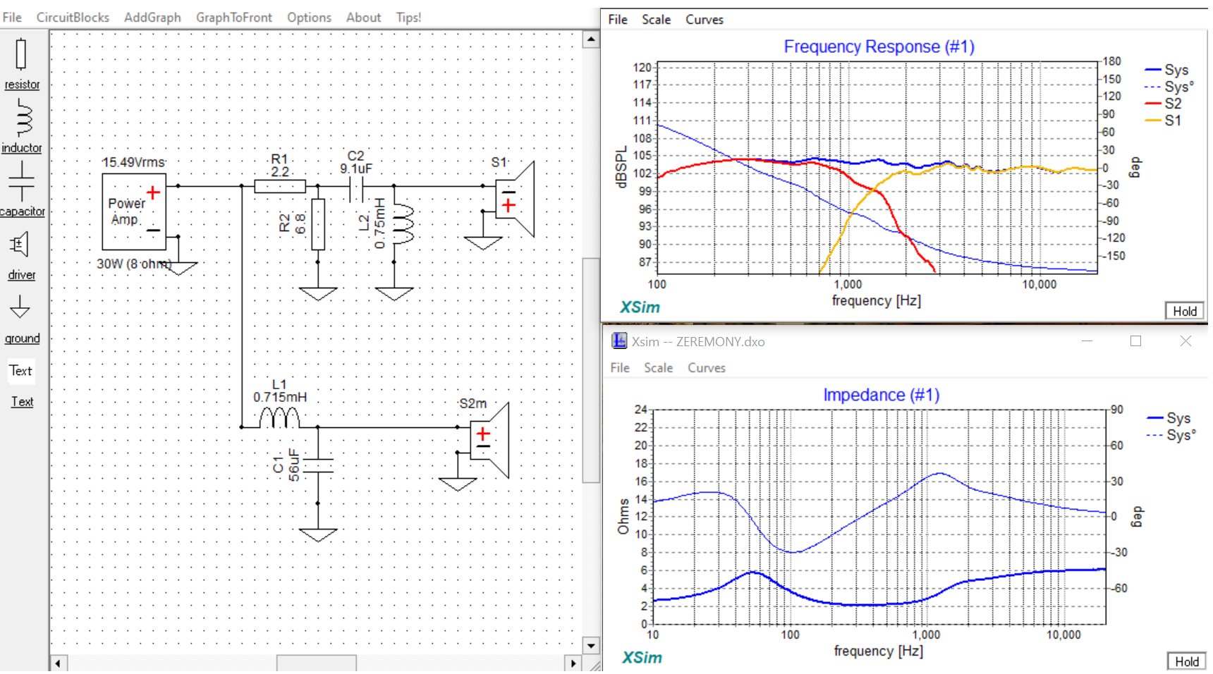

So I'm about to dip my toe in to crossovers, and would really appreciate some inputs on current crossover design.
Setup as follows:
- Low : 2x TB w5-1138smf
- mid: dayton rs125-4
- High: Peerless DA25tx00-08
- amplification: Arylic Up2stream Amp 2.1
- horizontal soundbar-configuration
- vented sub section
- Crossed sub/mid @ approx 120 hz
- Dsp for correction
Thought is to use as few components in crossover as possible and correct notches with integrated dsp.
Power dissipation of the resistor is within limits according to x-sim.
Will 2nd order crossover work with this tweeter crossed @ 1250 hz as suggested? Thoughts and inputs much appreciated
sincerely
kristoffer
A bunch of that is probably tweeter acoustic roll off.
This Peerless tweeter is down about 3dB at 1KHz on an IEC baffle as shown by the manufactures data sheet. A narrower baffle will lose another dB or two, so electrical rolloff to get that acoustic response would be about five dB down at 1KHz. I doubt that tweeter can play particularly loud at 1KHz. I agree the crossover frequency and/or slope is too low.
I think i might be following. Do you have any idea how horizontal soundbar configuration will affect bs? If I follow correctly, your assumption is that the tweeter will not be able to play loud at a 1khz bcs of max excursion capabilities? Even if the amp is not rated for more than 50wpc?
Thanks for all the answers guys, really appreciate it
