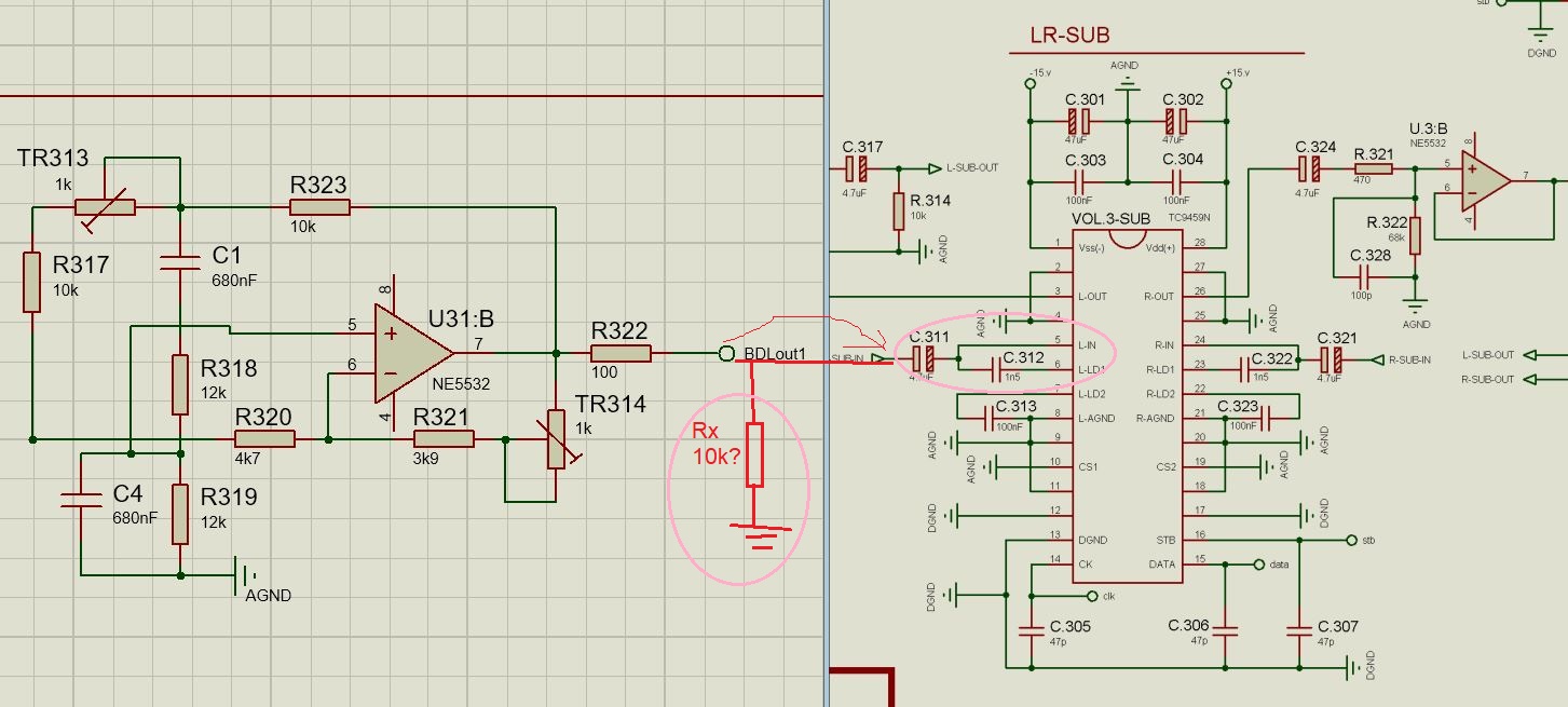

Here is the connection bettwen two modules (attached).
Opamp tone correction module, vol control module (tc9459).
- Do I need Rx (lets say 10k) to set the input impedance of the volume control?
There is only a decouplling cap at the digipot input.
Modules are connected with ~5 cm shielded cable.
I would like to omit ouput cap and resistor to ground in the first opamp module.

You do not need that 10k resistor. Why did you add it?
I dont know if needed... Seems it does not need it.
In general, the digipot does not amplify.
If we have an input of an amplifier, the resistor to ground sets input impedance.
The lower possible input impedance for the particular application, the less noise?
The 10k will reduce the open-circuit noise (when nothing is plugged in), yes. In fact if you know you have a 100 ohm source impedance when connected you can reduce the 10k to 2k2 or so for even quieter noise floor with the input unconnected, but 10k is a reasonable value.
It basically does nothing once that low impedance source is connected, but will reduce thumps on plugging in and noise/hiss when unplugged.
A shunt resistor will "never" improve signal to noise ratio. It usually reduces signal just as much as it reduces noise.
Hiss (noise) should not be an issue here. The signal should already be pre-amplified far above noise level. It "has" to be, because the pot attenuation makes a smaller signal more susceptible to noise.
"A shunt resistor will "never" improve signal to noise ratio."
Sure it will---Mark is right on. If you UNPLUG the source without the 10K resistor, you effectively have a 1000000M source impedance and thus a lot more noise than you will have WITH the 10K resistor. Once the connection is made, the 10 K resistor does nothing.
