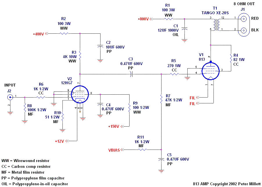

I am going to fish for more opinion here, regarding input tubes.
Also, what are opinions of what a 300b tube wants? High voltage swing, high current, low impedance, etc. and what might get us there.

Interesting. Where are you running the tube ?
In a pre-amp with a topology of my own design. That actually measures well!
