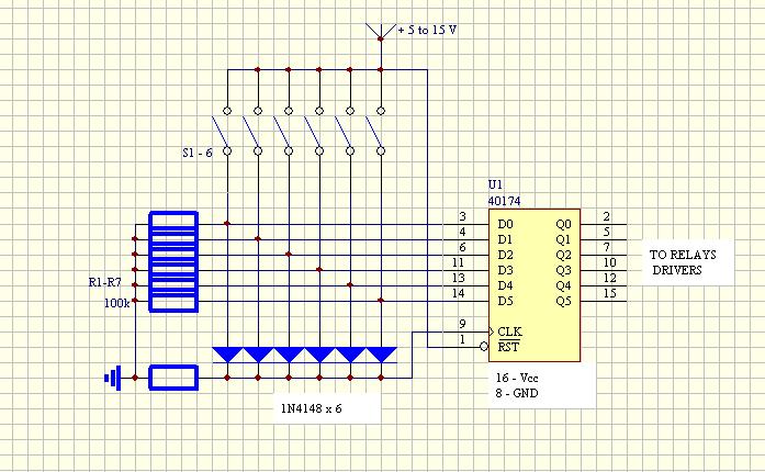

I would like to do input switching with push buttons and some relais. Has anyone got a schematic for this? I already made some schematics with RS flipflops but they didn't work.
I know how to do it with a PIC processor, but I think this is' a bit "over the top" as I don't need a µcontroller for anything else in my preamp.

try this.
Regards
