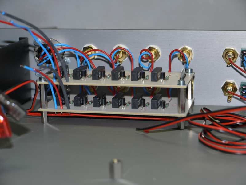

I'm about to bring me up a preamp and I would Bosoz an opinion on the I / O card that I am entraint to establish, I am a bit new to say especially in fitting a relay
http://img31.imageshack.us/img31/9431/projetw.png
I used the example of the scheme but diymania modif in investment inflows and symmetric input pin and there was some question I put to you.
- Choice of relay> 5 or 12V?
- Most schematics I had to consult with the inputs connected to pins 8 and 9 are flying by - the place of + diymania like it is there any significance??
- The pin 6 and 11 are all linked together and go back flying with the masses of the RCA plug and XLP, and in most cases I've seen, they are not there. But I think At least one set of symmetric inputs, as here
http://img189.imageshack.us/img189/2456 ... torsch.jpg
I hope ou understand me in my expliqation? In any case I thank you in advance and hope to complete this project with you, among other things, which is part of a supplement for the construction of a aleph5 .
thank
