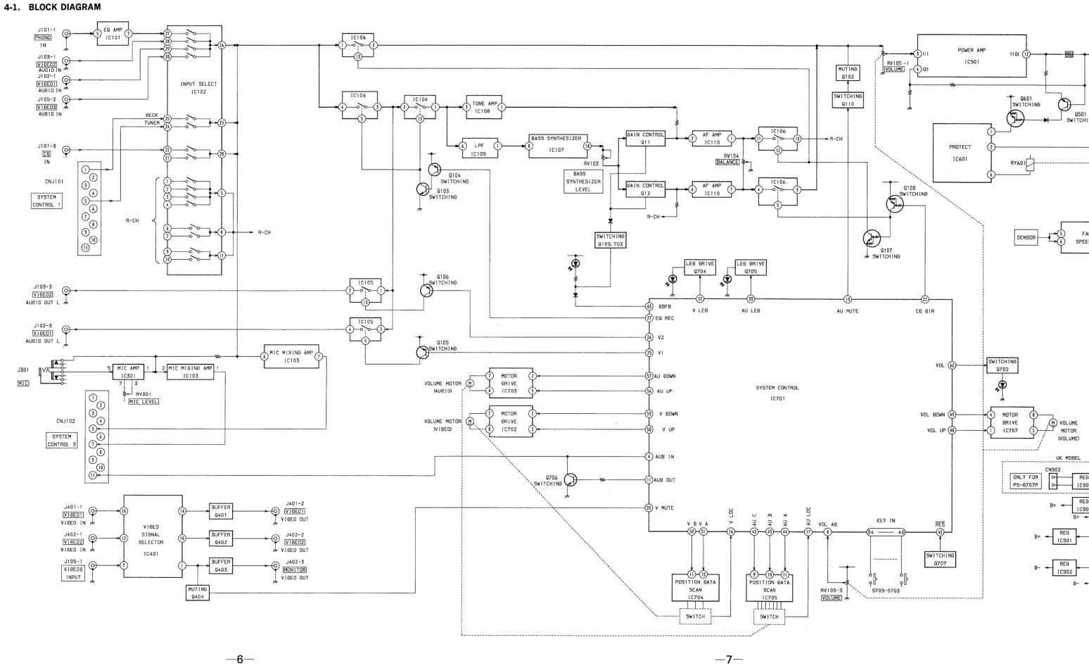

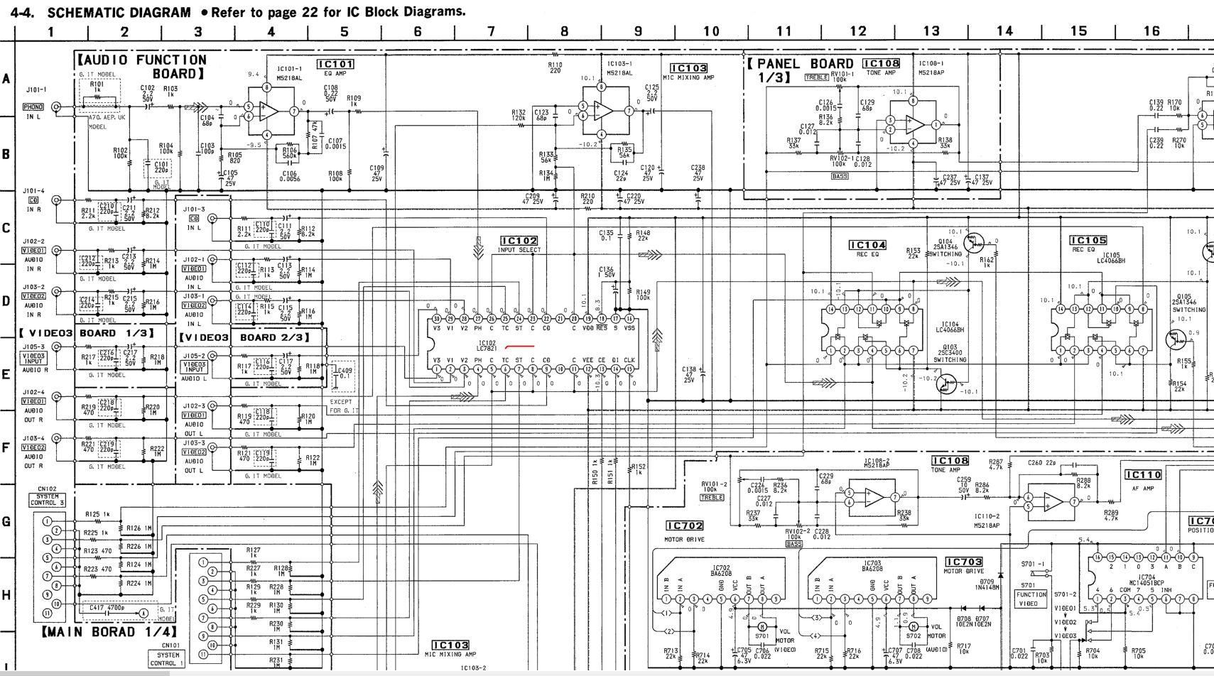

I have an old integrated amplifier Sony TA-A70.
Suddenly I got the problem with input select switch. Whatever position I switch the switch rotary, all the current input sources are mixed together at the output sound. For example, I have CD Input, Tuner, Video 1 (Audio input) connected but the sound from the speakers is of 3 input. So now I have to unplug 2 input and keep CD Input to listening the music.
My Input select IC is LC7821 (IC102), IC705 MC14051BCP for Position Data Scan for switching between PHONO, TUNER, TAPE, CD, VIDEO1, VIDEO2, VIDEO3, and system control IC701 uPD75106CW-195.
Is this indicate the LC7821 broken? I share the service manual.
Google Drive: Sign-in
I'm newbie and not know where to start to trace the issue. Please help!!!
