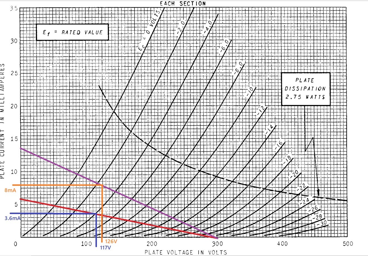

In my opinion the 82 works fine at around 8 mA, little bit hot with 300Vdc 🙂
So the Rk will be 470-560 ohm, C=220uF
Th Ranode will be 22 kohm 3 watts
On CF the 1 k will be 470-560R
And 10k will be 15kohm 3 watt
Cout =4,7 uF
Rout=220k

For this load like, the bias is around maybe 2.8V headroom. The cathode resistor should be around around 375 ohm for 8mA... I would seriously suggest considering a selected green LED for this instead of the cathode RC network. 😉
This is also perhaps one of the much more linear regions in the 'Generous Electric' published plate curves, but on purpose I did not want to replace the load resistor since it has a significant effect on the signal amplification. I just wanted to suggest a modest fix with not too much effort.
About the best area on the ECC82/12au7 plate curves is running 5-8mA around 250V on the plate with a gyrator (or CCS). But then you need something like a 380V+ supply. I did a mod very similar to this on a 'highly regarded' German name-brand amplifier (which was actually made in China) for a friend and they were very happy.
