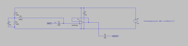

I am currently working on an op amp buffer (based on the MCP6292 op amp), which must be powered from the Raspberry pi 5V GPIO.
The op amp works as expected, but I am facing some issues :
1 - When I plug everything (Audio IN from Guitar and Audio OUT to amp), no noise can be heard.
2 - When I plug everything and I play a note on my guitar, the sound out to the amp with "switching-noise".
Actually, when I play a note on my guitar, I can hear the Green activity LED blinking on the raspberry pi.
For my point of view, this is definitely a coupling issue, but I can't figure out where this happens.
I attach the schematic I use.
Could someone help me to find issue on my schematic?
I really appreciate.
Thank you.
Marius

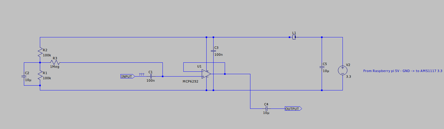

Hi Sangram,
thanks for you fast answer.
I have updated mu schematic with your proposal. I am not familiar with ferrite bead, so could you tell me if I put it on the right spot?
In any case, I really thank you for your help.
Marius
Looks fine, I would add the 10u after the bead (or in addition to before for better rejection to source).
Also, this is a very high input impedance circuit running at a (relatively speaking) higher supply current, so layout is critical. Your input circuit should ideally be right at the opamp pin, and fully separated from the power routing.
It might help to also have some HF filtering with a RC filter at input, like a 1k + 470pF combination. This should lower the circuit bandwidth and make it a little better at noise rejection from cables. Some output termination after the capacitor might also be nice.
Your output is not connected in any way to the Pi now, is it?
