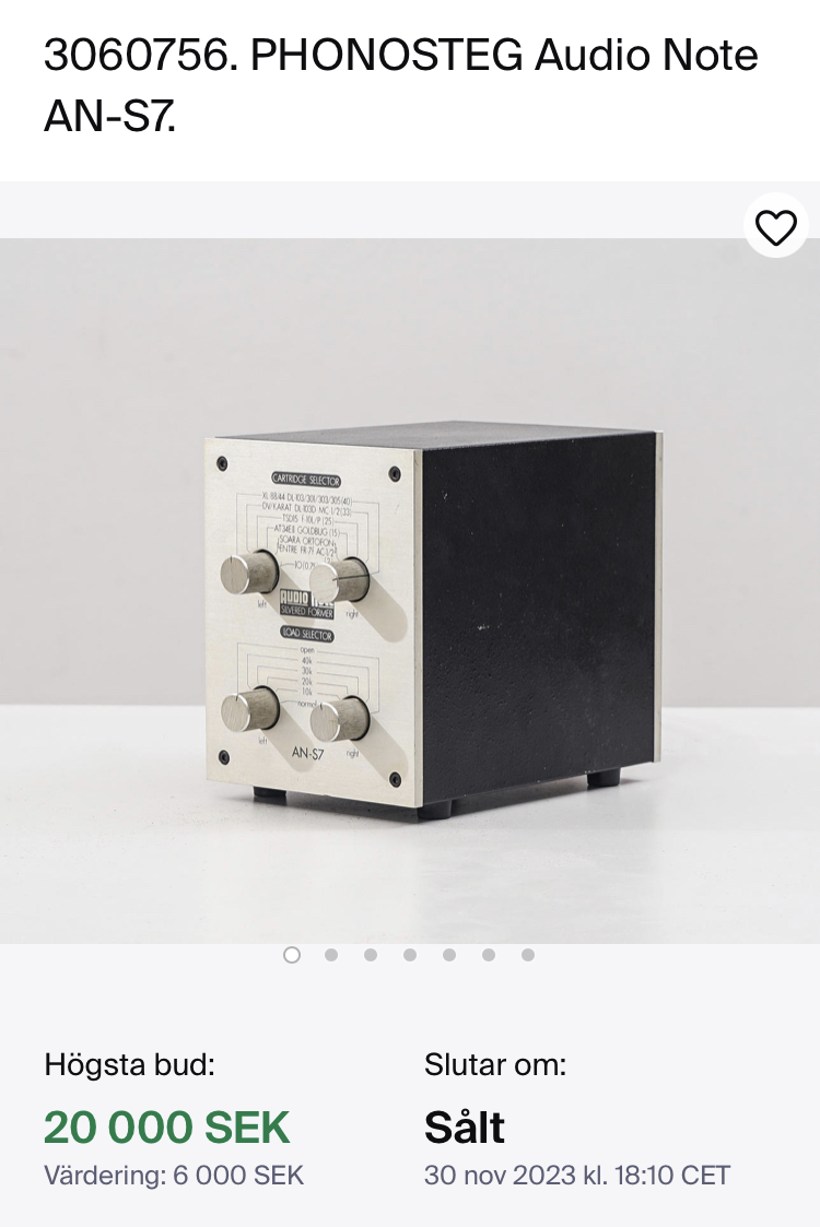

Audio Note silverwound transformer.
What's an AN-S7?
Jan
Jan
Its a very nice step up transformer from Audio Note (jpn) (now Kondo).
Actually it contains two multitapped transformers per chanel, and a rotary switch fit with various carts.
It’s suppose to be a very good sut, but I had better luck with my Lundahls. But to be honest, I haven’t tried that hard to get it optimised.
I attach some pictures of mine with the cover off.

Mine has all four transformers left inside it. However, the former owwner has cut some of the cables inside it, reducing some of the input choices. My guess is that he thought that it would benefit if only the winding used shall have galvanic connection.
This was probably done many years ago, and he didn’t have any memory how he did it.
One of the inputs works (not sure wich one right now), but surely this is the reason I haven’t got it sound as good as my Lundahl. The AN ought to be at least just as good.
I’ve talked to Kondo i Japan trying to get a schematic, to restore everything to its original shape, but they don’t share their diagrams.
These sensitive transformers is not that easy to measure. They dislike rms meters using dc when measuring resistance. And so far, I haven’t done any deeper analysis of it.
Sending it to Japan feels like a big thing, so now it mostly please the eye in my bookshelf.

I have had the same problem from a friend who bought a similar AN second hand with a mod inside; terrible!
But with some time spent to found the routing of cables at the end I found the solution
Confirmed that AN Japan didn't share any infos, and this is funny!!!!!!!!
Its been some years ago since I looked inside my AN-S7s. It wasn’t obvious wich cables had been cut, so in fear to make it worse I didn’t investigate it any further.
Do to the fact that the transformers can be destroyed if measured with a dmm, it’s not that easy to figure it all out. And measuring the wire connections with AC is a hassle, so it hasn’t been done.
@Walter. You don’t happen do have any notes left, from when you recovered the unit for your friend?
Any help would be appreciated.
